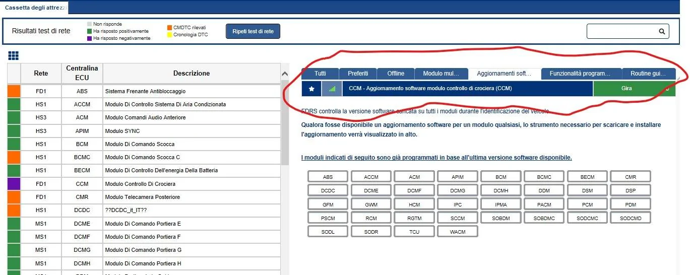

Hi all, a little while ago I finished almost all the updates except the CCM CCM cruise software update, I also tried to update the PMI module CCM but nothing, it won't let me do it, it says "evening number error" (perhaps it has been replaced the form in the Ford official). Furthermore, the alarms of the frontal collision avoidance system and the tire pressure alarm remain on. Can someone help me? Thanks!!!

If you did the BCM you will get the tire pressure alert until you drive the car for a few minutes.
Anytime you do programming, especially CAN bus modules (not so much with USB updates) you will get all sorts of alerts and warnings due to the interruption of communications between modules. These should all go away after a couple of key cycles.
Also I see a lot of orange and purple errors on your screen shot.
You should always clear all DTCs prior to starting any programming so that all modules start off as "green". And then after programming I find it's helpful to clear and retest again before disconnecting the FDRS laptop so that everything is again "green" to make sure everything is working properly.

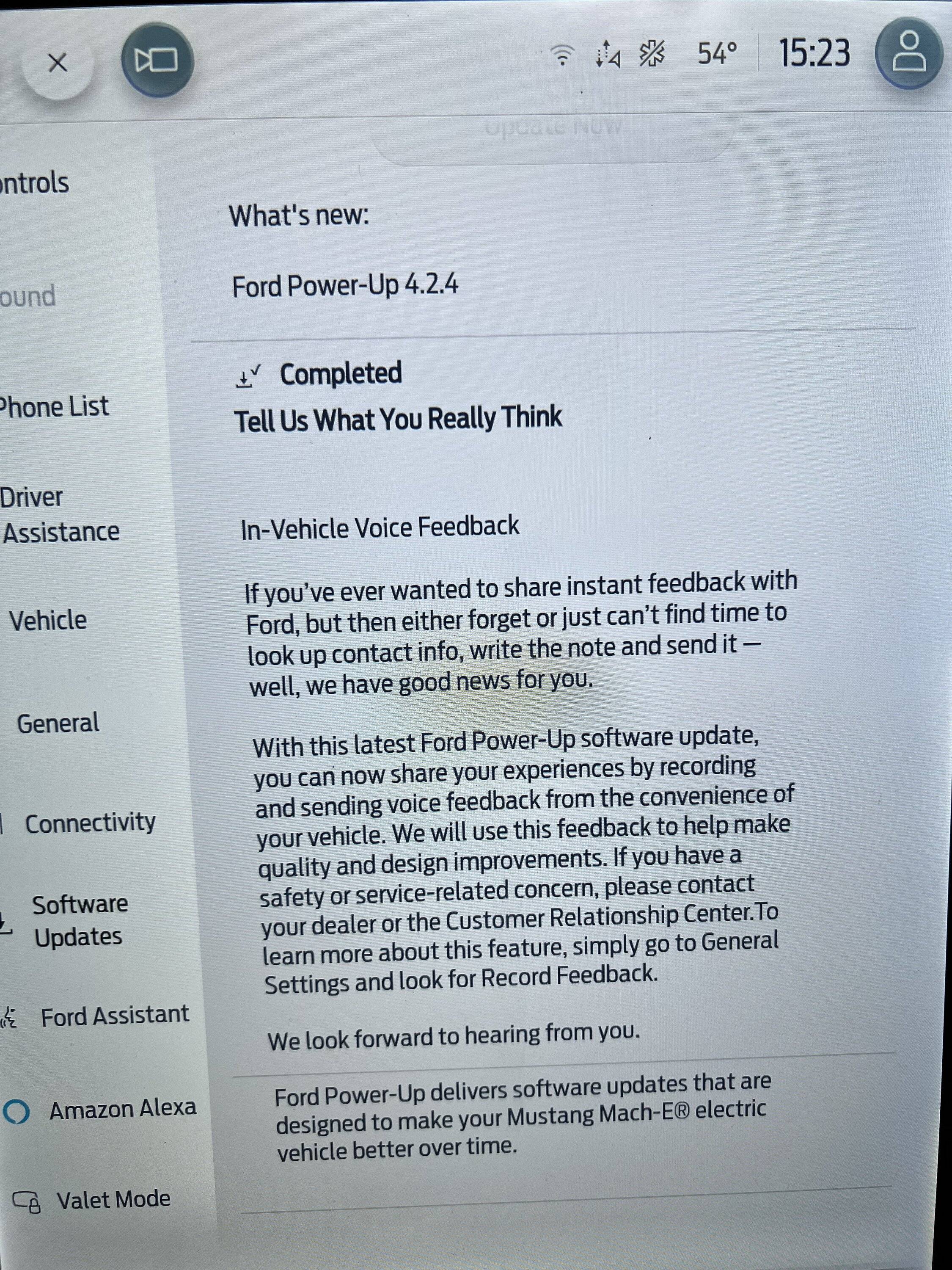

4.2.4 appears to be a TCU update as that is what just appeared for me in FDRS. Voice feedback has been available for a while. I wonder why they keep putting in notes that are from old updates?
