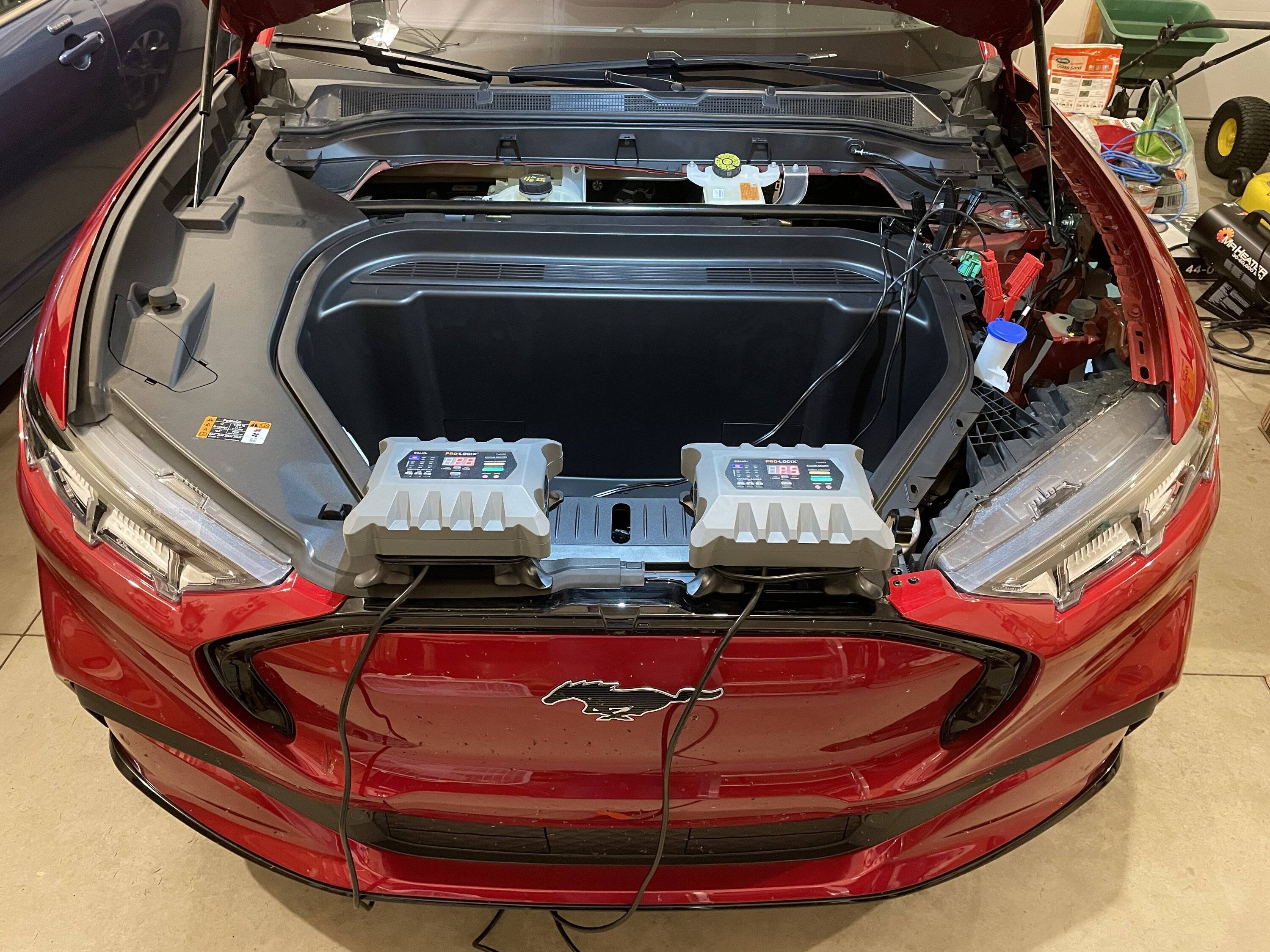

Many of us here use the PL6100 because the car is capable of drawing 40A while updating which we have seen several times and the PL2320 I believe only goes to 20A. The PL2320 is probably good for 90% of the updates but I would not want to chance the battery dropping below 12V when updating.
That's why I double them up for FDRS...

2x PL2320 are cheaper than 1x PL6100 and get the job done.

Yeah but we have members here, and on the Lightning forum who just double-up two PL2320s and it works fine.

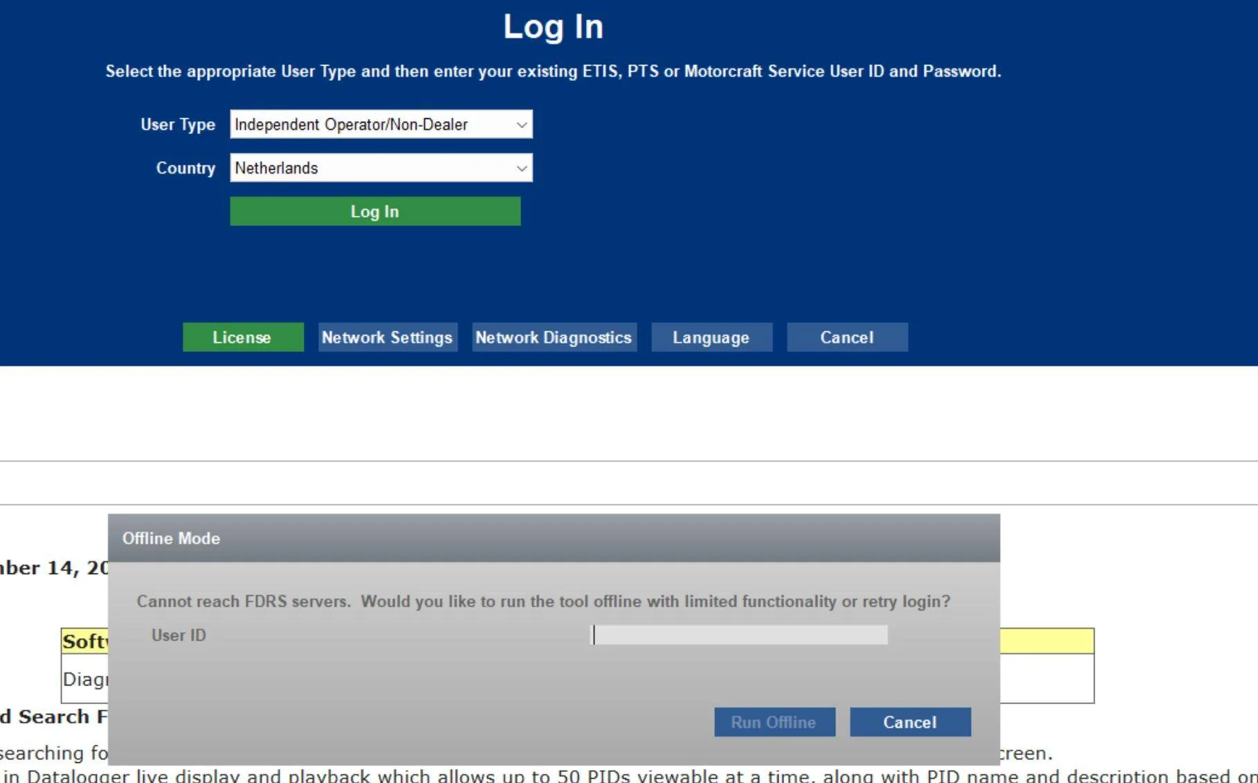

Interesting data on FDRS
Oktober 11 the APIM OTA was deployed/failed and reverted
Oktober 12 Manually installed APIM (took hours), got one module that failed, but the update remained.
Starting Oktober 13 until now i have a error message " Lost Communication With Accessory Protocol Interface Module" every day !
The APIM remains to work ok, but maybe it is time to update all remaining modules with FDRS.....
Tried to login to FDRS today, but servers are offline.
I'm logged in right now.
Arjan
Arjan
Feb 14, 2020
360
241
NL
Ford Mustang Mach-E GT Performance
It does not even matter what user login type i select, servers are down here in the netherlands

I does not even matter what user login type i select, servers are down here in the netherlands
Yeah I get that too.....I kept hitting the Login button repeatedly...and then when that didn't work I hit the "Create Account" button and that took me to a HTTP 400 page...and when I clicked "Return to previous page" it decided to let me in.
It's been doing this for a while now...and that's how I've been getting in. I already submitted a ticket. I've gotten no response so far.
I can login on the motorcraft site and see everything. It even asked me to change my loginname for the email adress. That part works fine. It is the login inside FDRS that fails.
Yeah..I know...it's no longer accepting Username logins here...only your email address and password for your motorcraft account.
