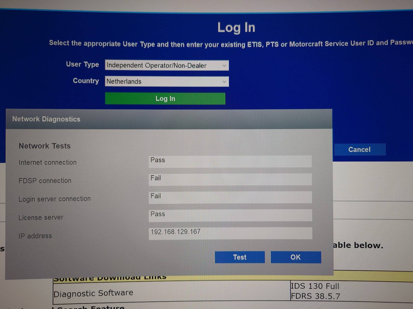

Still no luck logging in to fdrs
Even the network test does not function...
I am beginning to wonder if they will fix it in the future
Wow at least I can get in with a bit of fiddling.....I wonder what your local dealer service folks are saying. Can they get in?
I mean if the servers are down...they should be down for everybody.
It works correctly for me in Spain
