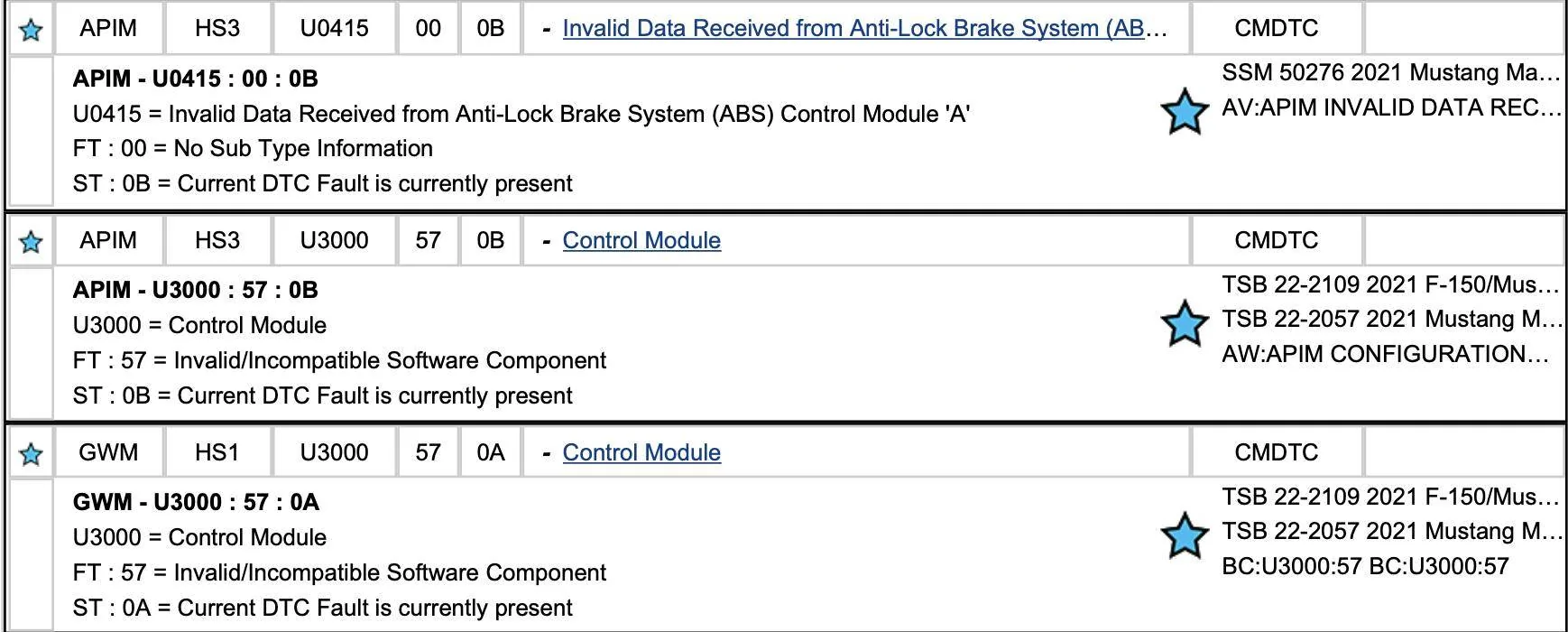

Maybe someone who's a bit more experienced with FDRS can help me out here. On 3/25 I attempted to do TSB 22-2117 myself, realized the laptop I was using for it does not have an ethernet port so used an USB-Ethernet adapter. It failed, I have 3 different adapters and tried any combination of adapters at either end of the cable but it always failed at 'establishing ethernet connection'. I decided I would hold off on that and did the rest of the module updates that were available since there were a lot. PCM, CCM, CMR, IPMA, PSCM, SOBDMC, OBCC, IPC, HVAC, RFA. I was able to complete all of them except for IPC, after doing some of the others an APIM update showed up which also wasn't able to complete.
The next day I borrowed a laptop with an ethernet port, attempted to do the TSB 22-2117 fix and it just fails before even asking me to connect any of the cables. I get 'Procedure Unsuccessful - FlashDiagFileOverCAN Failed to flash MU5T-14H116-CA'.
- Tried restarting car/laptop and nothing.
- Then I cleared DTCs also didn't help.
- Looked at DTCs and found these relevant ones:
Ford Mustang Mach-E The Complete DIY Guide to Updating Your Mach-E with FDRS Screen Shot 2022-04-07 at 14.09.55
- Tried to reset APIM and GWM configuration and they both fail.
It seems like updating those other modules before doing the TSB messed something up and now the versions are not what FDRS expects them to be. I also no longer have lane centering. Lane assist still works but I can't turn on lane centering through the settings, clicking on the option does nothing.
I do not know enough about FDRS or module flashing to know what else to attempt so welcome any input from anyone with more experience. I work in tech so not afraid to get my hands dirty but at this point I think I've reached as far as I can go troubleshooting things myself. Only had a 2 day FDRS license, want to avoid dropping another $50+ and start the 2 day clock if I don't have anything else to try.

What versions do you currently have on APIM, GWM, ABS and IPC?
The GWM, APIM, IPMA and IPC modules are different from the other ones since they have multiple images that has to be written, not just one single image, so it is very possible to get those in a non-working state if just some of them are uploaded but not all. I would think the problem is entirely in the APIM (frontend) module since alle the other modules are clearly running and working.
You shuould focus on trying to get that recovery program for the stuck APIM update to work, since it probably all is caused by that. Possibly test the ethernet connection. It is all kind of unstandard plugs and adapters for that so it is very possible that it just is not connected properly. Also the network cable used to run between those two network interfaces MAY have to be a crossover cable (adapters that does not do crossover automatically do exist). See if it actually makes a link and if there are any traffic moving over before trying again. If there is no link or there is no traffic at alle there is probably something wrong with the cables.
