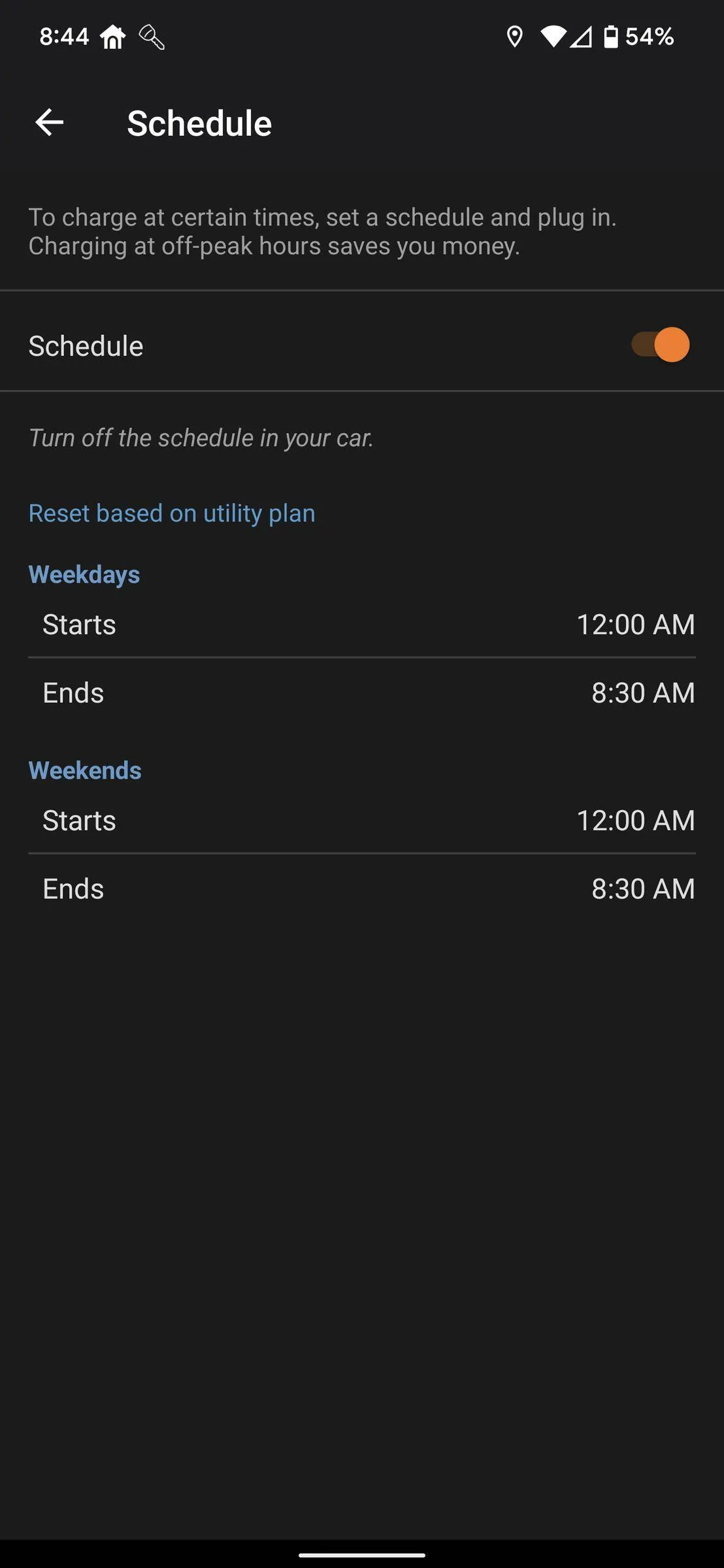

Ok so just because I'm getting confused ... Do you have the app for the EVSE set on a schedule or you are using FordPass to adjust the schedule for the car, as in the image below?
Also when you plug in before the schedule does it says "charge paused" or does it say "waiting for schedule"?

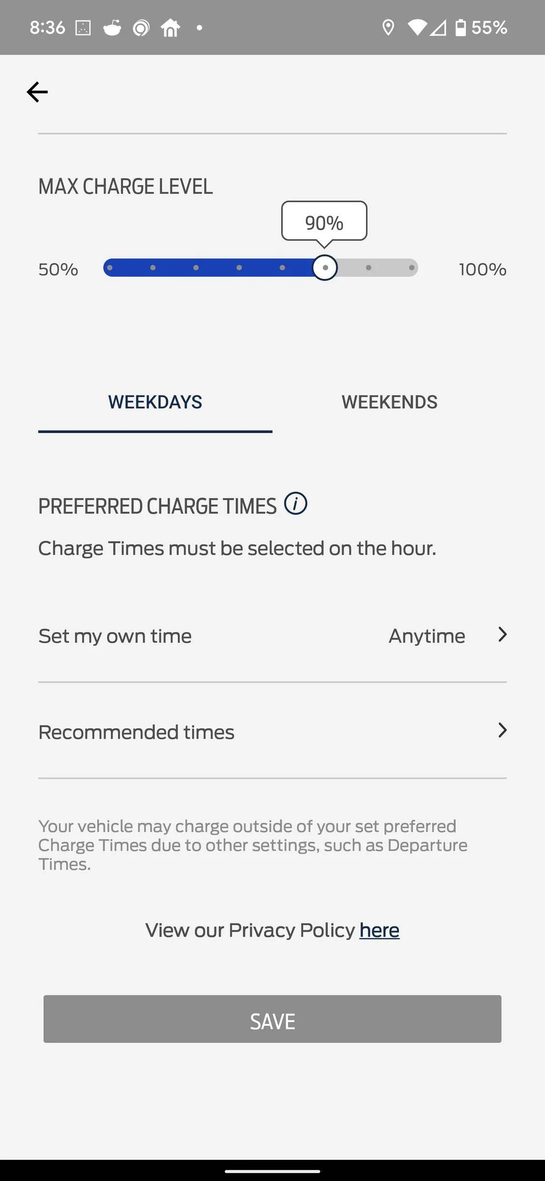

I have the chargepoint home flex.
Charging schedule set in car
No schedule set on the EVSE
This worked with no errors from Feb 12 2021. Even after swapping from the FE to the GT, no issue. Set schedule on the car to charge to 90% 11pm to 7am.
I started having the issue at the beginning of the year. I think Jan 4th. It would only happen once a week at first. Then it happened every night for a week. I want to say I haven't had it happen since Jan 24th.
During that time, I updated my car twice with all available updates, removed and recreated my location charge settings. Cut power to the EVSE for an hour to reset it. None of it made a difference.
Then it just went back to working and has been fine since.

Yeah I think I mentioned to you offline Ben that I had so many issues doing it that way when I first got the car. I called tech support for ChargePoint and they told me DO NOT SET the schedule in the car or you will have issues. Even in the ChargePoint app it says to turn off scheduling in the car
I bet that notice in the app is because they want to make sure you don't have a schedule set in the car AND the chargepoint.
If you don't set a schedule on the chargepoint, you don't see that message.

I have a ChargePoint Flex and it's set to charge at midnight. The car is set to charge anytime at home.
I get this message every single day without fail. I have for 4 months since I've owned it. It doesn't affect anything, it's just annoying. I assume that it happens because I plug in at around 5-8pm - 7-4 hours before charging starts.

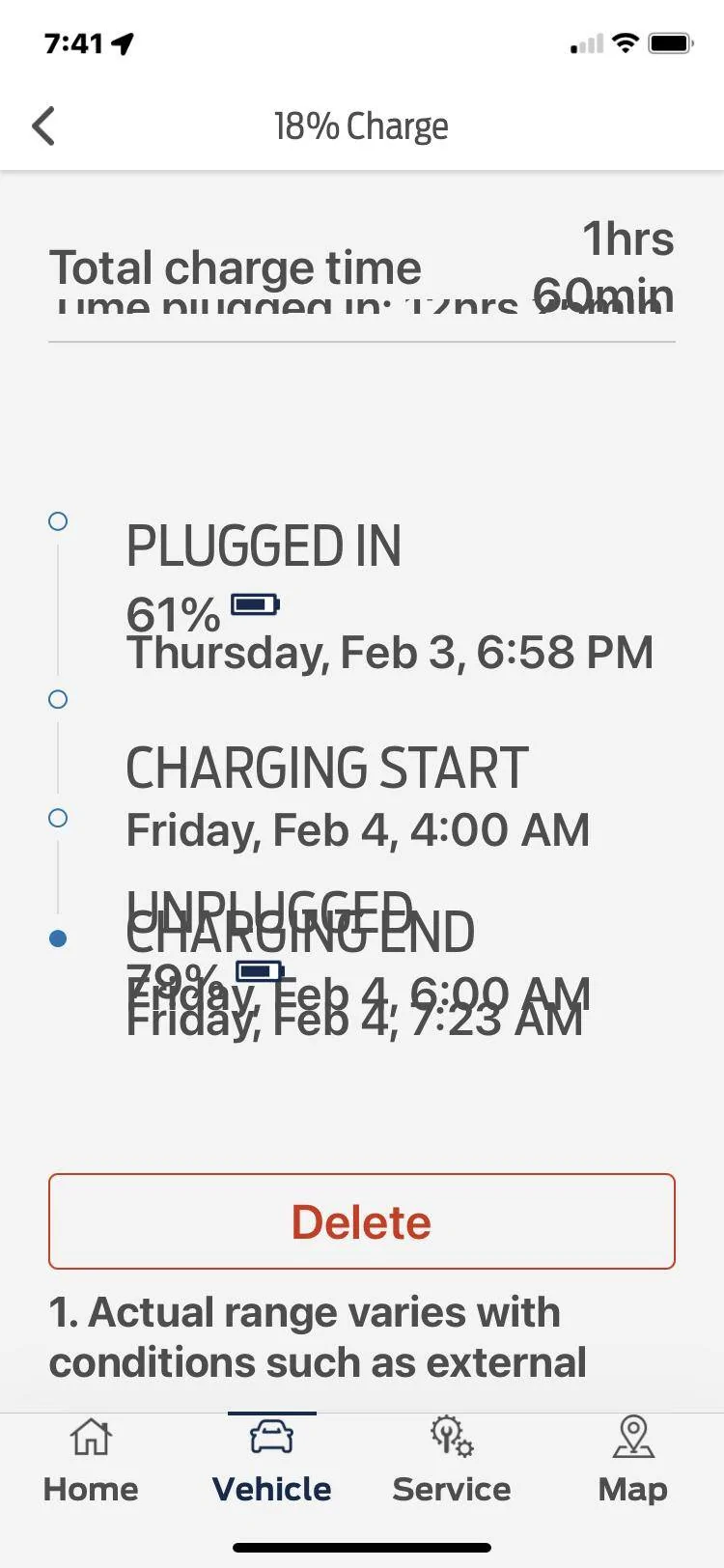

I was affected last night. Car started charging @ 4am instead of midnight??? Do you guys think it was do to 2.3 download??
