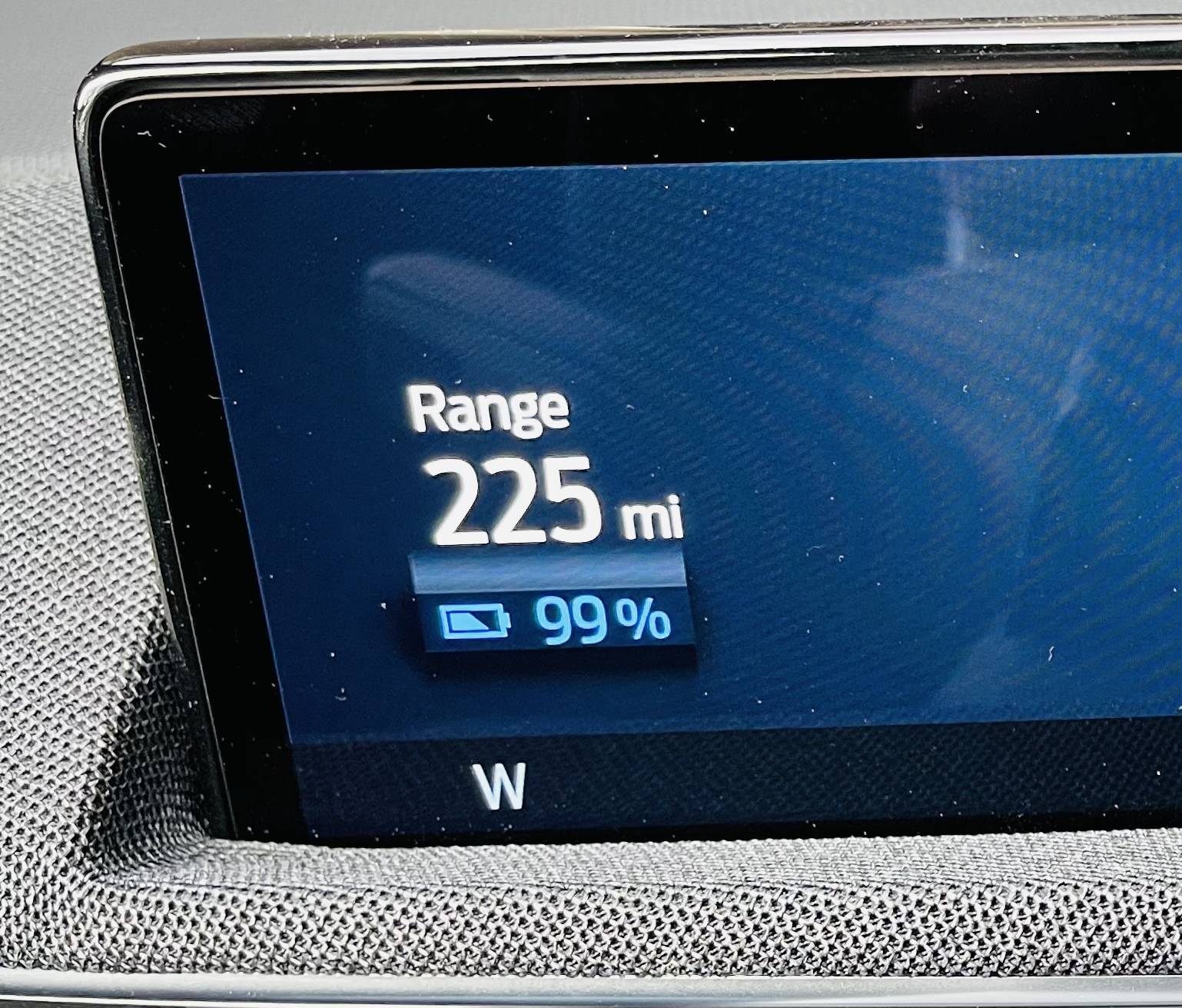

Magical, a reset instantly got me 25miles more at 99% charge!
Just so the new people know that are reading the forum, trying to learn about this new EV thing. "Jericho" didn't magically get 25 more miles of range. What he means is the "Guess-O-Meter" is now suggesting he can go another 25 miles on a single charge. He did this by erasing the historical data in the car's memory that may have included cold weather or racing. The distance he can go is independent, and most likely longer than that guess.

I’ve never owned an EV. I’m trying to figure out how accurate the mileage available On an EV is. It’s based on driving history?
Ford said the GOM would be based on recent driving history like almost EVs, but also weather, terrain, and other MachE drivers near you.
That last one has the potential to make the car way more accurate over time and comes with downfalls.
With some miles under your belt, you’ll figure out how to adjust it for your style of driving.
Some people ignore miles and focus on %. When I bought my first BEV, I drove it 1100 miles home. That got rid of my range anxiety. Just drive it.
the 'range' number displayed is a guess based on remaining battery capacity and driving history. It should not be considered 'accurate' as it could change depending on temperature, if current trip is different than average (city/highway/flat/mountains). If you normally drive stop and go around town, you'll want to 'reset' the history if you begin a long roadtrip so it will re-calibrate the range estimate based on the kWhr/mile consumed on your trip... and give you a better estimate when you need to start looking for a place to charge.
urban/suburban trips will give you a much different range than a long highway trip BECAUSE without stop/go regenerative braking events, and at highway speeds, you will consume more energy per mile, and not have much 'regenerated' unless you are going generally downhill with opportunities to use the L button or 1-pedal regen mode. Conversely, if you are road tripping from a lower elevation, and generally going uphill all day you will need to look for a charge station much sooner.
so.... I'd say that the way to get the most accurate range estimate is to 'reset driving history' if you are changing the type of trip you are setting out on...

I disagree with the strategy of resetting your history. The point of the history is to make it more accurate. I consider the GOM mostly accurate on Both my cars. Obviously you can make it not accurate by drastically changing one of the parameters it uses for its estimation (start towing a boat).
Every time you reset the history the car has to relearn your driving style.
