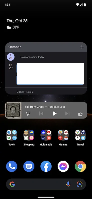

It's only been about 24 hours, but yeah, I like it. I am coming from a Z Fold2 which, while it is a great phone, is just too bulky when it's folded up (I am going to miss the real estate when unfolded, I can already tell...). I've got mine in a Spigen Tough Armor case, so the camera bump isn't even a bump, the back is just perfectly flat.
My main beef is how much space is wasted on the home screen with the Google search bar at the bottom (which I never use) and the At A Glance section at the top. I normally have a Beautiful Widgets clock with 5 day forecast up at the top, but that big chunk of space is now inaccessible unless you use a 3rd-party launcher. I use every inch of my homescreen as you can see, so this is irritating to me.
