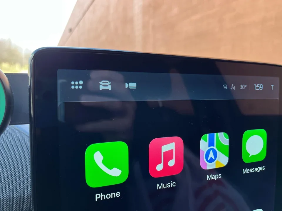

The US are getting new interface icons for settings, camera etc.
Can't wait for these to come out in one of the UK releases. The current icons look so out of place.
