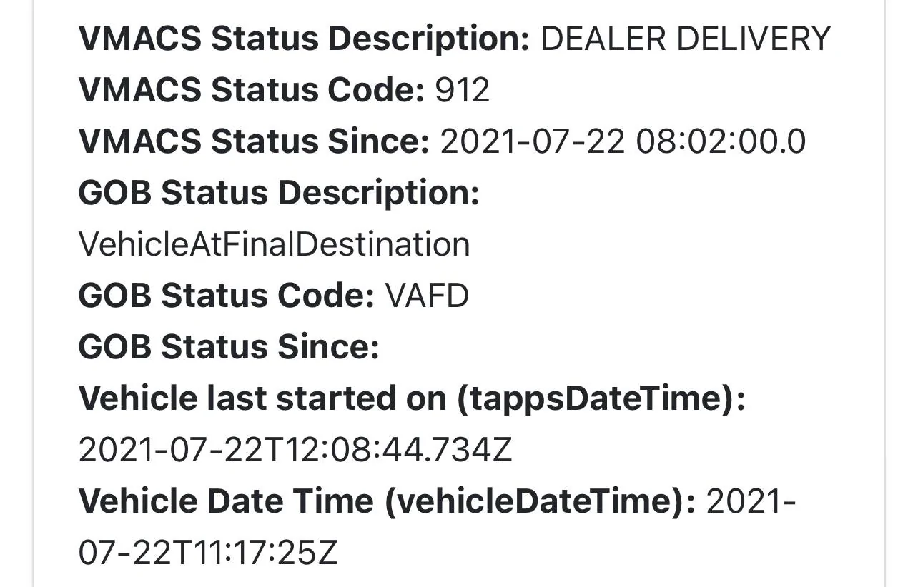

Nice update this morning, I assume car is at dealer now.
VMACS Status Description: DEALER DELIVERY
VMACS Status Code: 912
VMACS Status Since: 2021-07-22 10:02:00.0
GOB Status Description: VehicleAtFinalDestination
GOB Status Code: VAFD
GOB Status Since:
Vehicle last started on (tappsDateTime):
2021-07-23T11:49:26.408Z
Vehicle Date Time (vehicleDateTime): 2021-07-22T13:12Z

Just had a call from my dealer to say it’s not actually at their dealership. He didn’t elaborate on that but I assume it’s at some dealership group compound ??ā€ā™‚ Either that or he doesn’t realise it’s there. Seems odd that it says ā€˜at final destination’
Doesn't surprise me..... got to be another twist in tail for this saga :)
