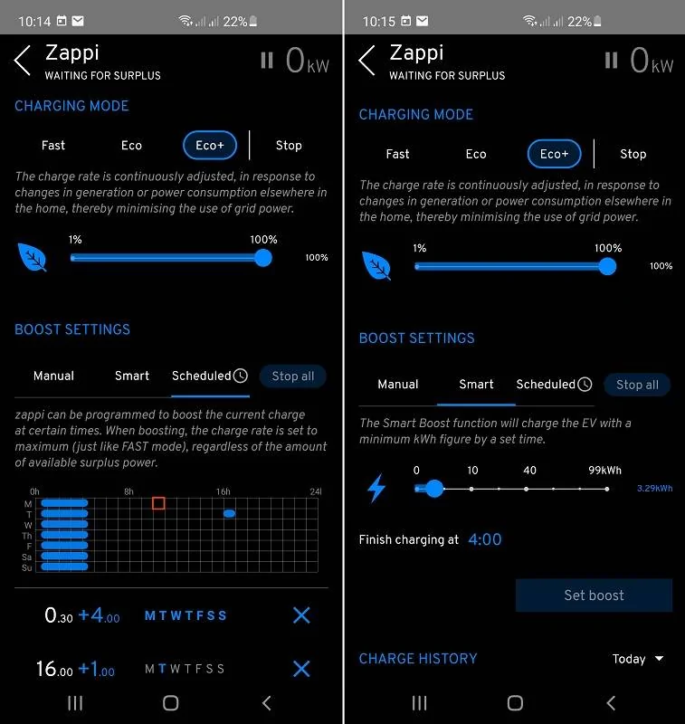

Have read your post with interest - have you got the zappi to work with schedules when the car goes to sleep - I cannot get any of the car charging schedules to work either I must be doing something wrong as I keep getting charge delayed unless I turn the car on after I plug in - can you help at all
Hello mate. So I’ve not used the charge schedule via the zappi, only the car… which works fine, so long as you have a max charge level set that you will be reached within the charge schedule. If not it will ignore the schedule and charge outside of time to reach desired charge.
One thing to consider with the Zappi is what schedule time and setting you have it on. If you’re charging at night, you’ll have to be set to Fast charge, as Eco and Eco + will need something coming from the solar. So no sun and it’s not going give any charge at night. Otherwise I’ve not tried a schedule via Zappi… I can give it a go tonight and see what happens.
Good morning all, just a bit of info the Zappi Charger when left in Eco or Eco+ modes is for all intents and purposes in 'standby mode' ready to charge in Fast Mode (7kW or lower if set) when no PV available.
For the example shown below the the Schedule shows the car set to charge at 00:30 to 4:30 (ie 4hrs on Oct/Go) every day & one charge on Tues 16:00 for 1hr with the Zappi set to Eco+.
The Zappi will still charge the car at all other times using any spare PV available.
Ford Mustang Mach-E UK Customers Zappi01
There are lots of other details/features with this charger too many for this forum so if you are interested just check the Myenergy site if you wish to do so or if I can help just post or PM me.
