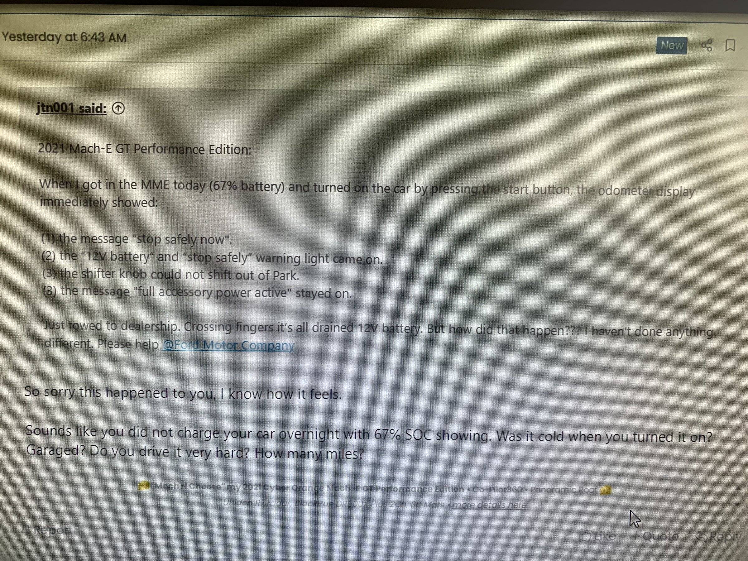

Just found this on another thread. Looks like your 12volt battery could be the issue.
Am sure in the manual you can jump start them from under the front bonnet after removing some trim …

@Kezza Bee74 There are a couple of things you could try:
Fully lock the car, and keep the keys away from the car for at least 10 minutes. This lets all the modules go to sleep. Then try starting it.
If that fails, then there are a couple of things you'll need to know.
Whilst in accessory mode, under settings is the option for "Emergency Tow Mode". You may need this to get the car onto the AA flatbed if he has no dollies.
Be very careful where the AA tow the car from. The tow points are in front of the front wheels...not behind. I've read horror stories of tow companies towing from a hole that rips the battery skin apart requiring a whole new battery encasement.
Last but not least, your 12V battery could be too low, so ask the AA for a jump, to see if that fixes it.

Forgot to mention, to get to the 12V jump points you need to remove *both* the topmost, and right side plastic covers in the frunk. There is a high possibility of losing some clips when you do this down inside the back of the frunk....never to be seen again.

Fingers crossed it’s not the HVBJB issue that is rife in the US. You will be without your car for a considerable while as they have to drop out the battery pack.
