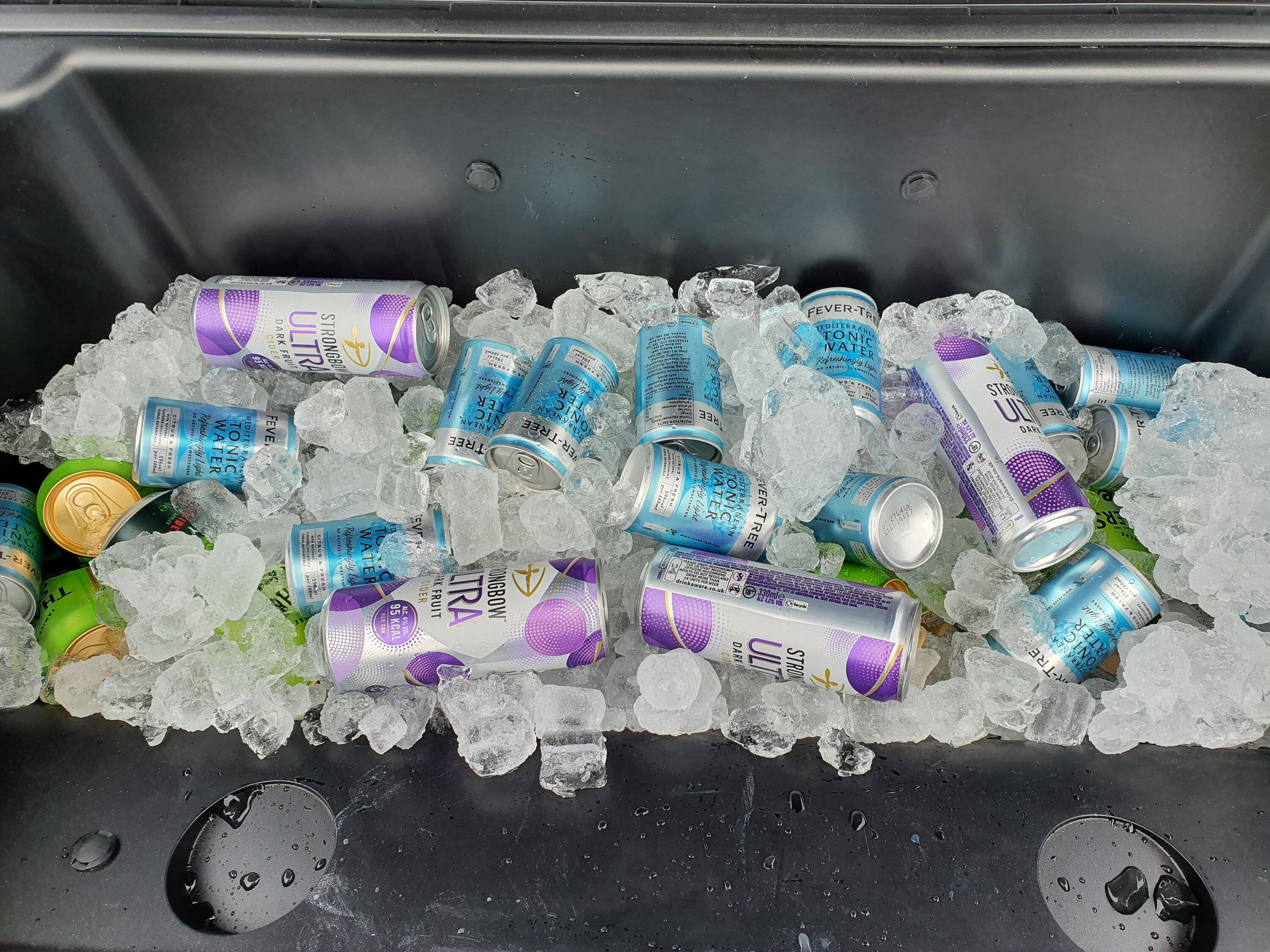

It works. ?
Did you put it all in there once you were at you’re destination? Or was it loaded like that for the drive? I would love to load up the car for camping, knowing you’re get there with ice cold beers in the front.
I loaded it up before I left home. It was great to pull up at the campsite and have a couple of nice cold ciders before we attempted to erect the tent. Only problem was the temptation to have another (or 2) during.

Well, that's the weekend over and I am glad to report that the "ice in the frunk" was a success. I put 6 x 2kg bags in at 1400 Friday and it had melted by the time I looked at about 0900 the following day although my cans were still cold. Put another 5 x 2kg bags in at about 1300 and that was good again until Sunday morning. I imagine it melted a bit quicker as my car is black (absorbs heat more) and although wasn't as sunny as the previous week the air temperature was still quite warm. Still good though. Had some interesting comments at the camp site, certainly got people's attention.
