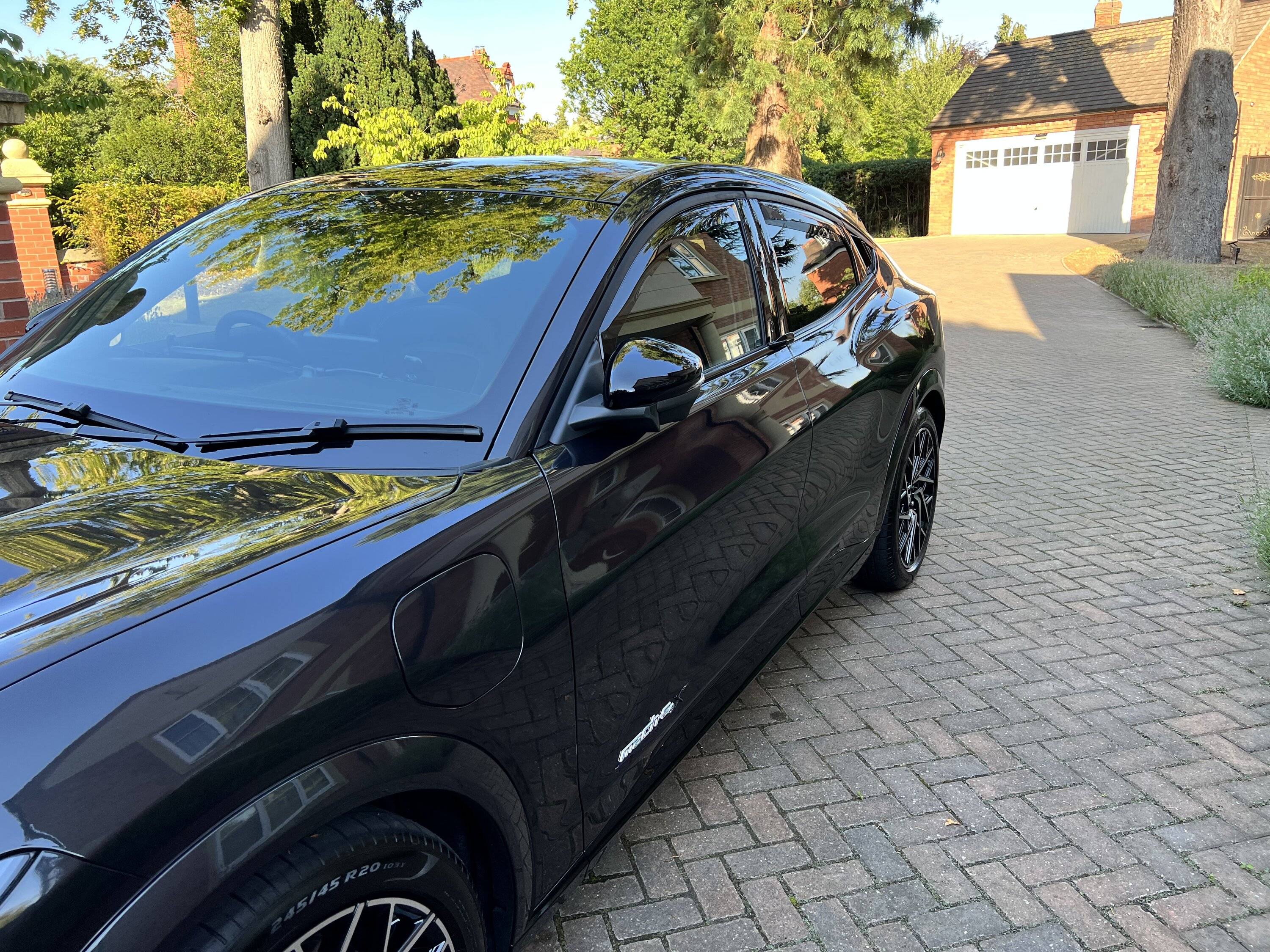

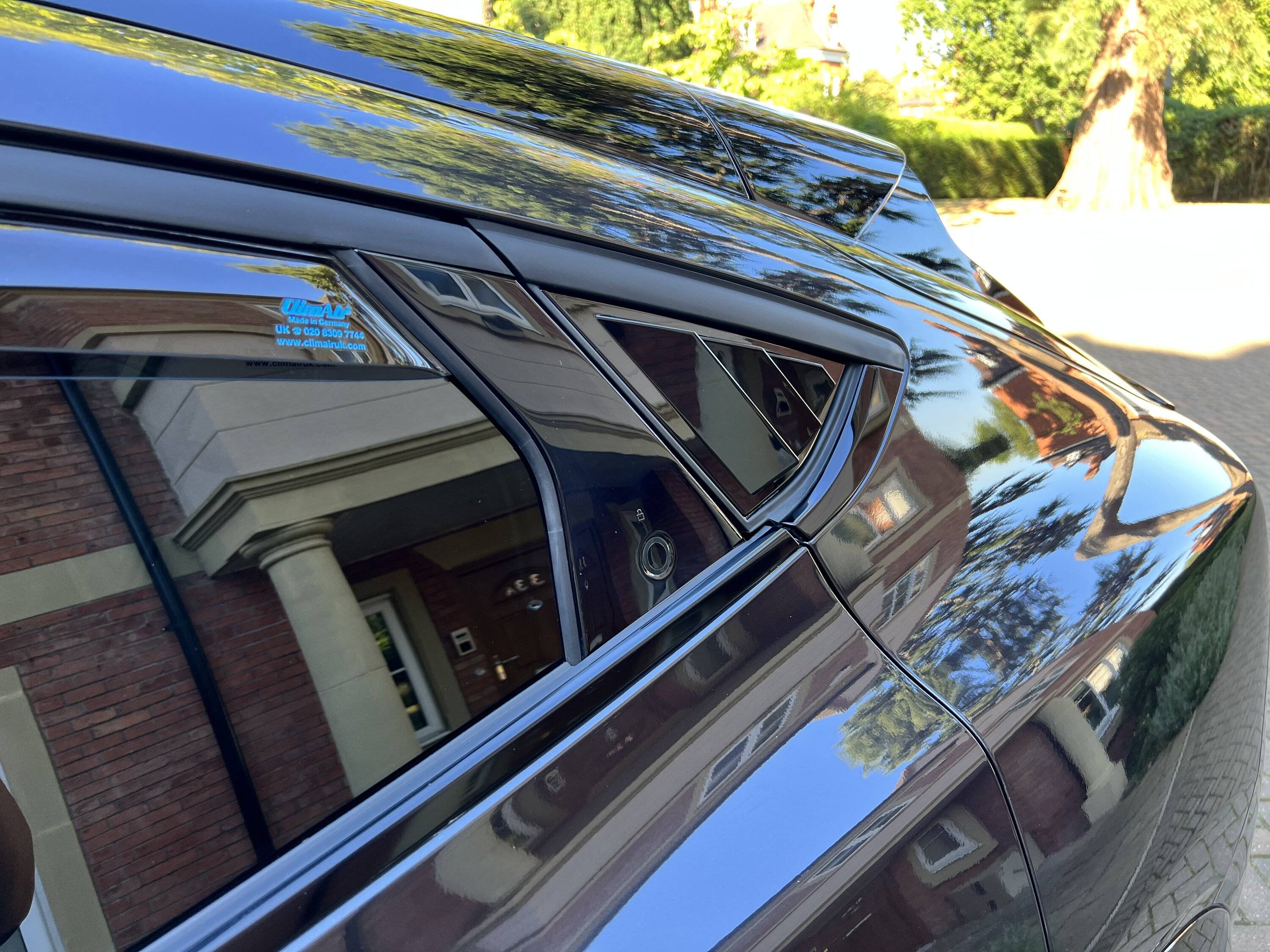

Rags to riches attempted charge. Once the dealer had finished the software updates on our car last week they offered a quick valet (it was a bit mucky) to finish off, I agreed thinking nothing of it. However, the young lad was a bit too keen with the drying rag and it got caught and ripped off one of underscores to the passenger door lettering (only present on ER AWD I believe), with the dealership giving apologetic feedback to me. They told me one was on order and they'll fit it when the car goes back in for the pano roof and windscreen (another story) as it was all their fault (too right!) and they'll take care of it.
Anyway, the wife got an email from her company fleet people today asking to deduct £110 from her salary for this maintenance/repair to cover it. So the response from my wife was "Err NO" in short and for them to go back to Zenith/Dealer to sort it out as we are certainly not paying for it, the cheek.
The annoying thing is I know of this issue from this forum and other peoples experiences, and this is something I always mention when the car gets valeted, but I didn't mention it to the Ford dealer perhaps thinking they would know this already! My fault I suppose but I'm not paying ?
Anyone with an ER AWD watch out that the sticky back lettering could be ripped off if caught by a rag.

It's not just AWD ER. The lettering on my RWD ER is very loose too. But that was my fault while washing it. I am thinking of getting the dental floss to it before I break it completely. At least if I can get it off in one piece I can stick it back on when I come to sell.

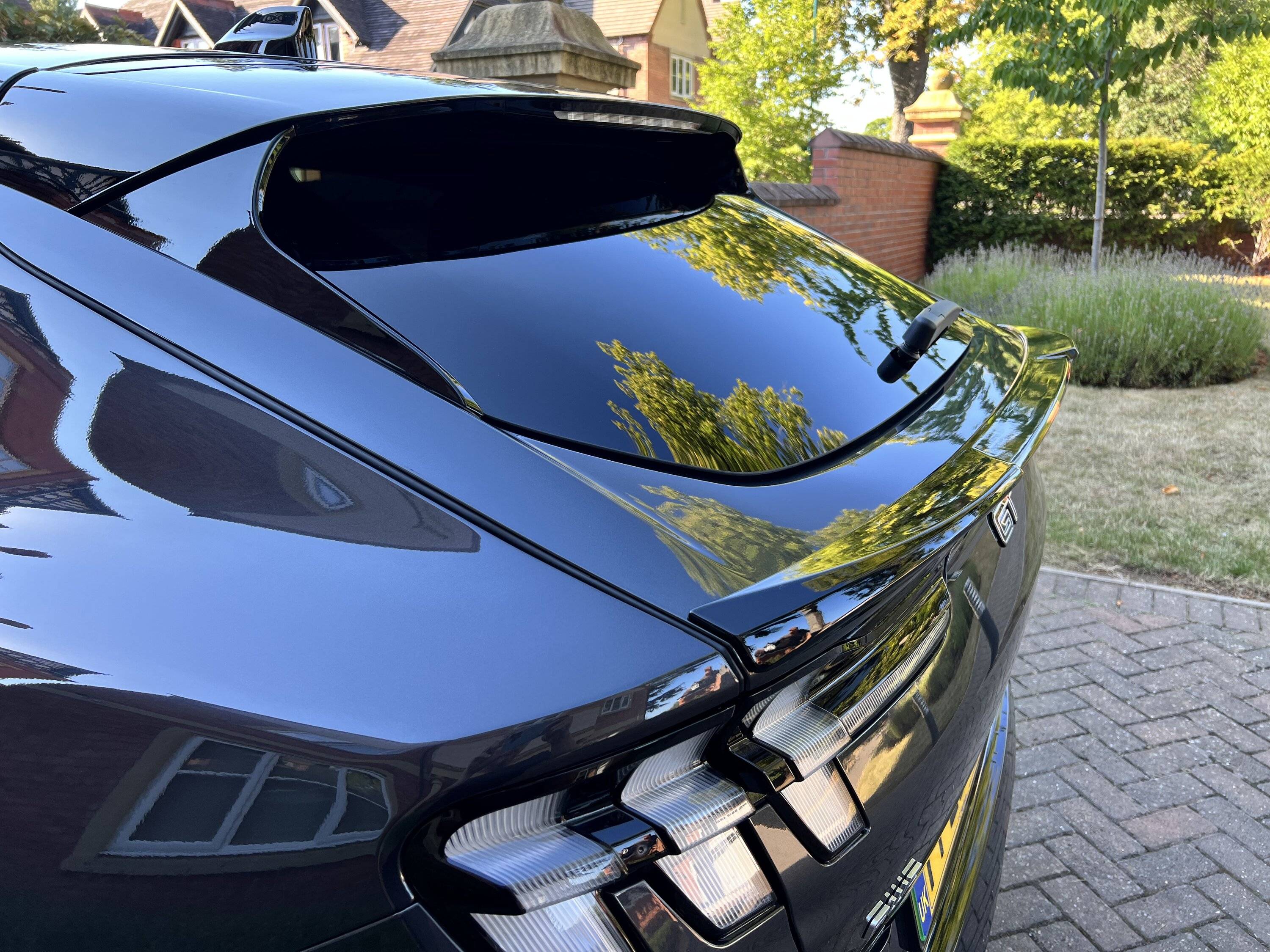

Update on this. Took my MME to Evans Halshaw Bedford, same people who has done the roof recall.
They said my local EH dealership had not done the recall work even though it was shown updated in the system.
They carried out rhe software update. They don't seem to give jobsheet copies to customers so I have only their word for it and a photocopy of the technician's handwritten note that PCM module wasn't done by my dealership.
I have no reason to disbelieve Bedford and will inform Ford UK about my local dealership.
Anyone been to Bedford? They said a few MachEs had come to them for this recall.
