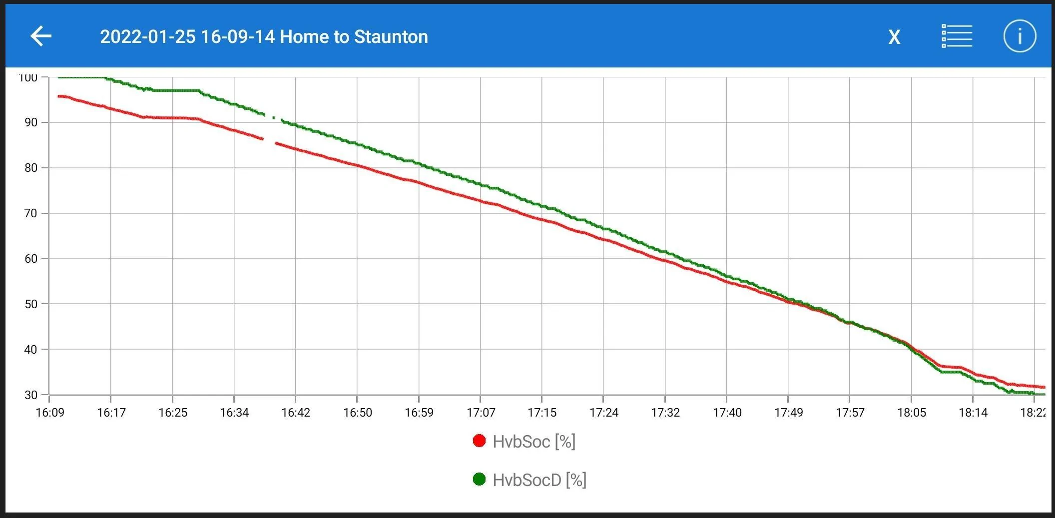

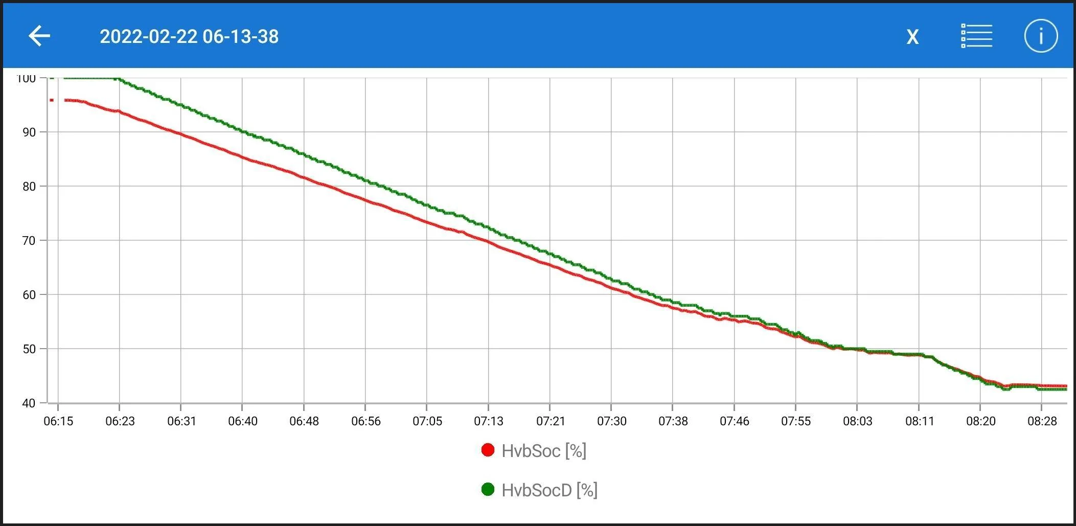

It is very hard to tell if you have actually received the increase. But you can tell if you use an OBDII scanner and compare the SoC with SoCD. If they cross at around 48%, you have the 91 kWh battery. If they cross at around 44%, you have 88 kWh of battery.
Before capacity added:
Ford Mustang Mach-E Unlock battery capacity for more range this year? 1669062935423
After capacity added:
Ford Mustang Mach-E Unlock battery capacity for more range this year? 1669062977404
The reason it crosses closer to 50% now is because the extra 3 kWh was added at the bottom of the battery instead at the top. So now there is approximately the same buffer at the top and at the bottom of the battery. Before, there was a bigger buffer at the bottom.
It still charges to the same max SoC as before, but since some of the buffer was removed at the bottom, you can drive to a lower SoC.
I bet you have it. You definitely have it if all your software modules are up to date.

Because SoCD and SoC are almost exactly 50% when charging/discharging (91 kWh usable capacity), it appears the locked capacity is evenly at the top and the bottom of the battery.
