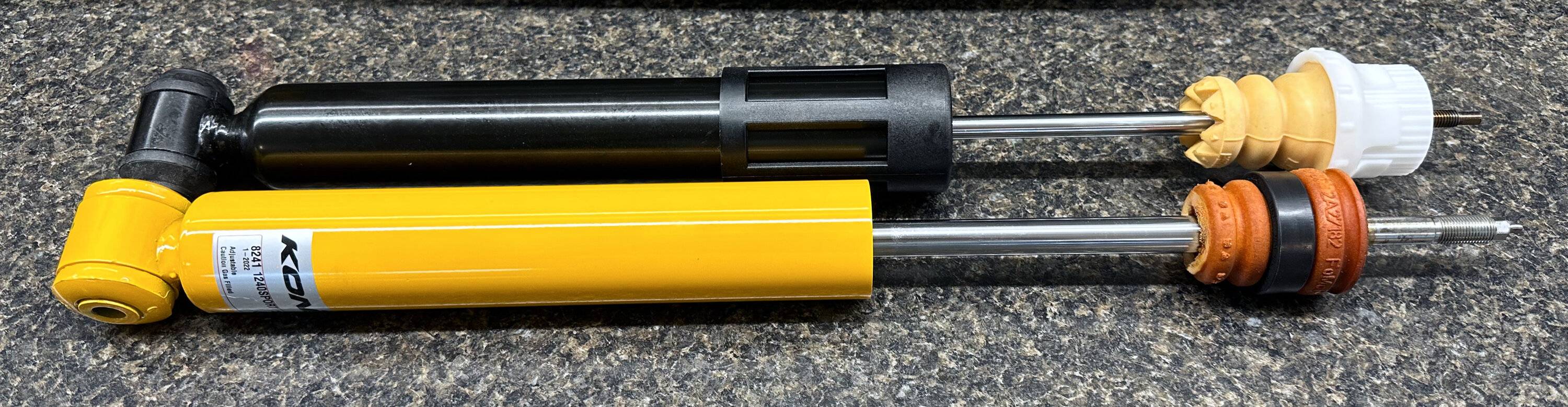

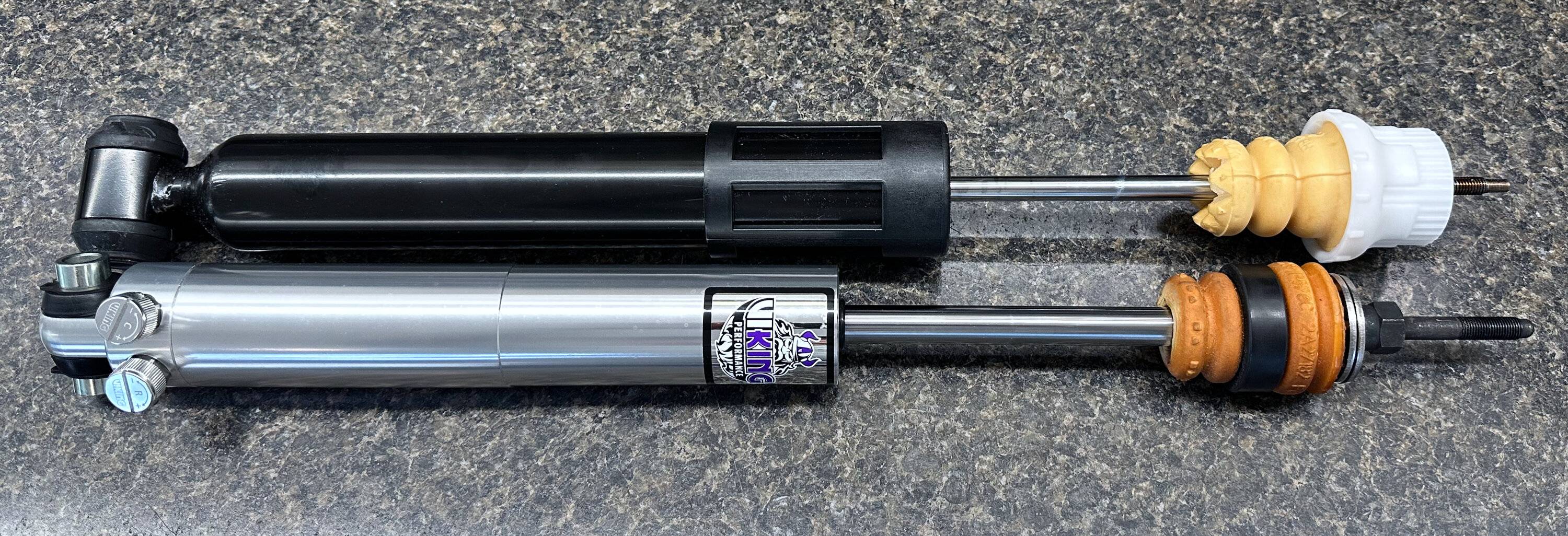

Update:
I'm back from my short trips and had some boxes waiting for me. I built up a set of Koni's and Viking's. Sent the Koni's to Erik and Vikings to Lee. They will get them on Friday. I'm leaving out of town that day again and will be gone a week.
Anton has had the Koni's for a month and loves them. He doesn't want to give them back. I'm not going to try out the Vikings on his car, just leaving him with the Koni's for now. Erik has had the Vikings for a couple of weeks at least and I believe is having good luck tuning them and now he will have a set of Koni's to try out. Lee will try out the Vikings and I expect they will all give us their opinions as soon as they have time to test them.
Testing doesn't just involve installing the shocks and driving around. Both of these shocks are adjustable and it takes time to drive, stop, adjust, drive, etc. The Vikings are easy to adjust where the Koni's need to have the car raised a bit to get your hand above the rear tire to the top of the shock to adjust and even at that it's not so easy. When Anton and I adjusted the Koni's we tried at different settings and the only one that worked the best was the rebound set to maximum. I sent Erik the Koni's already adjusted to maximum so he can just throw them on the car and try them out. If the rebound requires more firmness than the Vikings then the Koni's won't work. However if the firmness of the rebound is about the same as what Erik has the Vikings set to now or if it is less, then the Koni's will work out. I am hoping they do as they are very easy to modify requiring less parts and are slightly cheaper than the Viking's.
Stay tuned.....
A couple of photos I had never posted before. Here are the Viking, Koni and OEM (Black) shocks without the dust cover so you can see the extra 3/4"-1" of travel. I wanted to get a bit more travel so it is easier to tune the shocks and allows those that have lowered the car to not bottom out as easily. All three shocks are the same length from end to end even though it might not look like that in the photos.

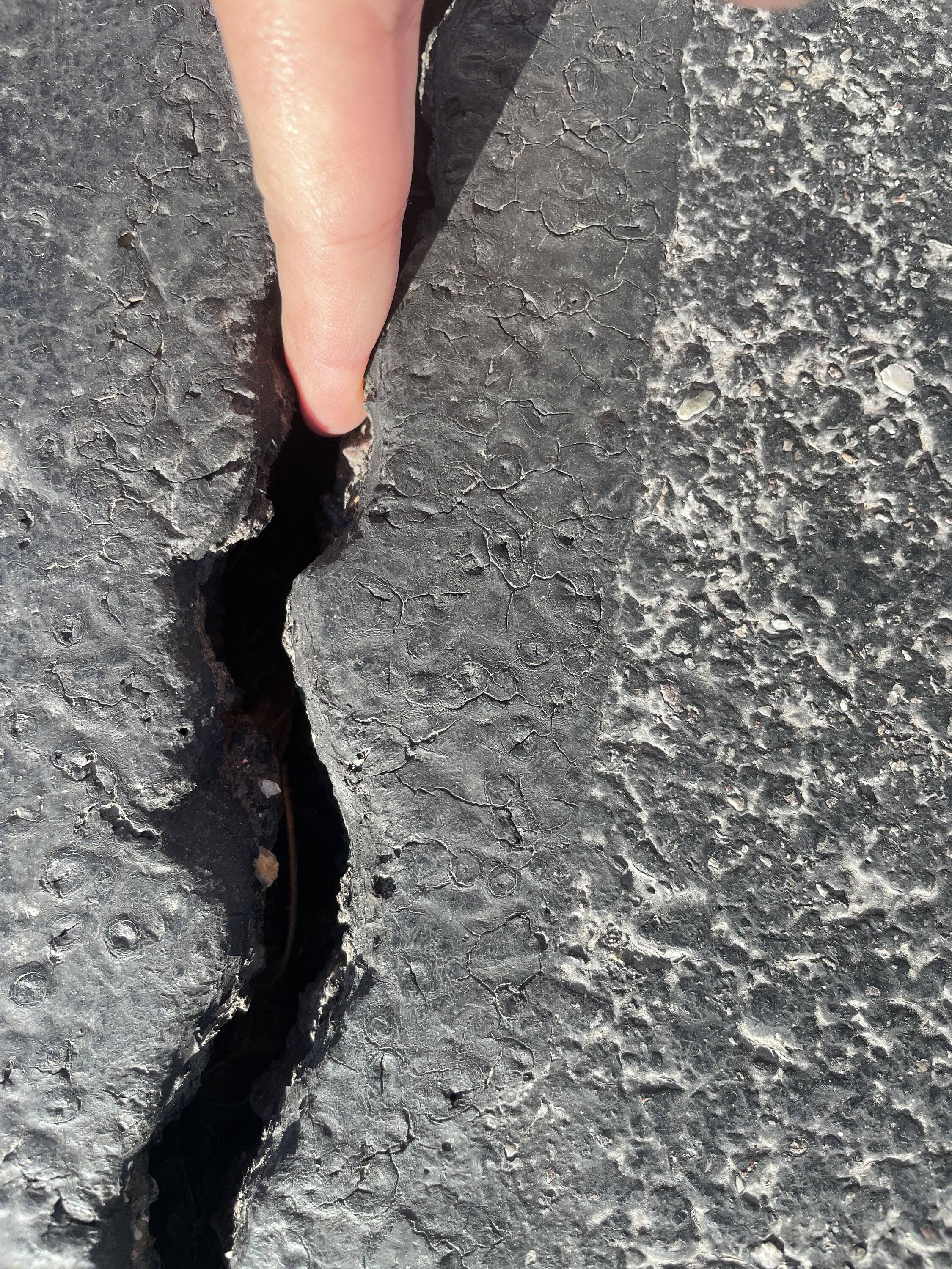

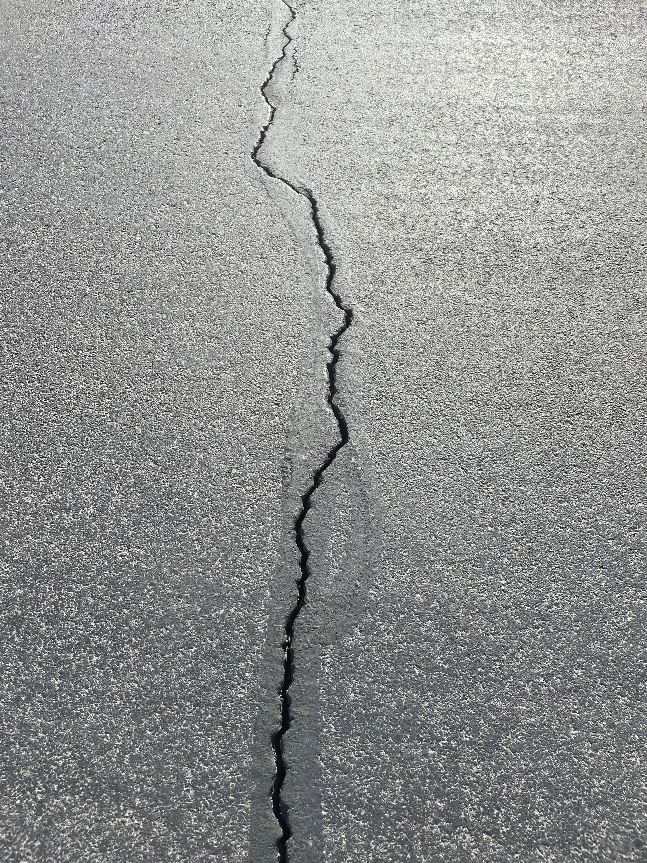

yeah. Maybe we should paint it. Then no one can see it…
(One of the hundreds of repairs I'm in tune with around here)
Hokey-smokes! That’s quite a fissure in the asphalt. ??

They're almost all like that. All the way down my 'major road' in my area the asphalt is usually 1/2 inch higher or lower on one side. Every 6 to 10 feet theres a split all the way across the street like this. Some are probably 2+ inches. They repaved the road I used to live on 10 years ago. I refused to drive that road so much I'd shoot across the street and drive over speed humps to get through a neighborhood just to avoid these cracks. And I hate speed bumps/humps. Now that road is like glass. If I'm really lucky we're next on the paving list.
Side note. Yesterday I rode in a 2yr old Mini Cooper S. And was amazed at how well it can shake a drink right out of your hand. I just. Wow. Just. Yikes.
