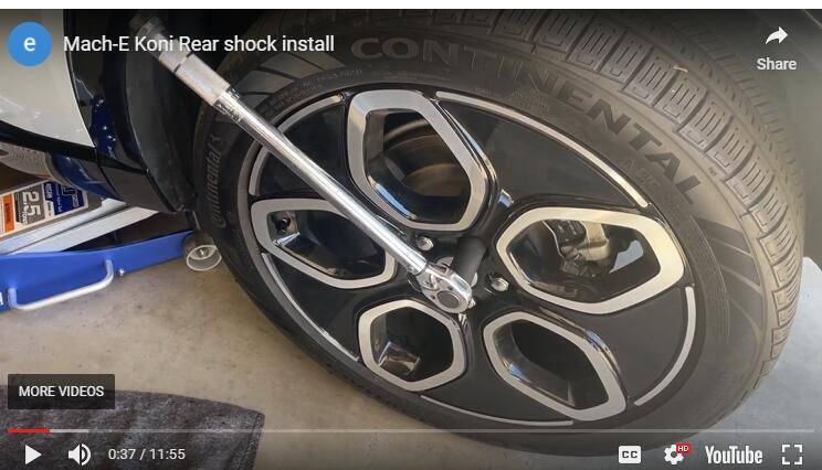

WOW - thank you to everyone who participated in all the testing and instructions for making this mod a success. I literally have a new car that is much more competent in handling bumps. My wife complained about the ride since the first day we picked up the car. I told her about you guys working on a suspension fix that might cost about $500. She said it may be worth it. It was.
I collected all the parts so that I did not have to reuse anything from the original shocks (a pet peeve of mine) and did the install today. It went as expected with a few comments:
1) I used a scissor jack rated at 2 tons to raise the car with a jack stand on each side of it (safety and spreading the load if the jack failed). This worked well with no drama.
2) The driver's side was easier than the passenger's side because I am right handed and on the driver's side I was using my right hand to place the washers for the lower shock mount vs my left hand for the passenger's side.
3) I did need to raise the control arm on both sides because the Koni shock mounts were a good 1/2 inch short of the top holes. I used a second jack for this so I did not need to drop the car onto the jack stands and reuse the scissors jack.
4) A six inch extension on my torque wrench provided enough clearance to torque the lower mounting bolt without raising the car up farther.
All that being said, I am more than impressed with the results. We drove the car on a frequently traveled stretch of ill constructed and ill maintained NC road. Before the mod the car subjected us to uncontrolled bouncing especially when bumps occurred close to each other. Now you still feel the bumps but the bouncing is minimal and predictable.
As you can tell, I am having trouble finding the words to describe the results but once again, I want to thank everyone involved.
