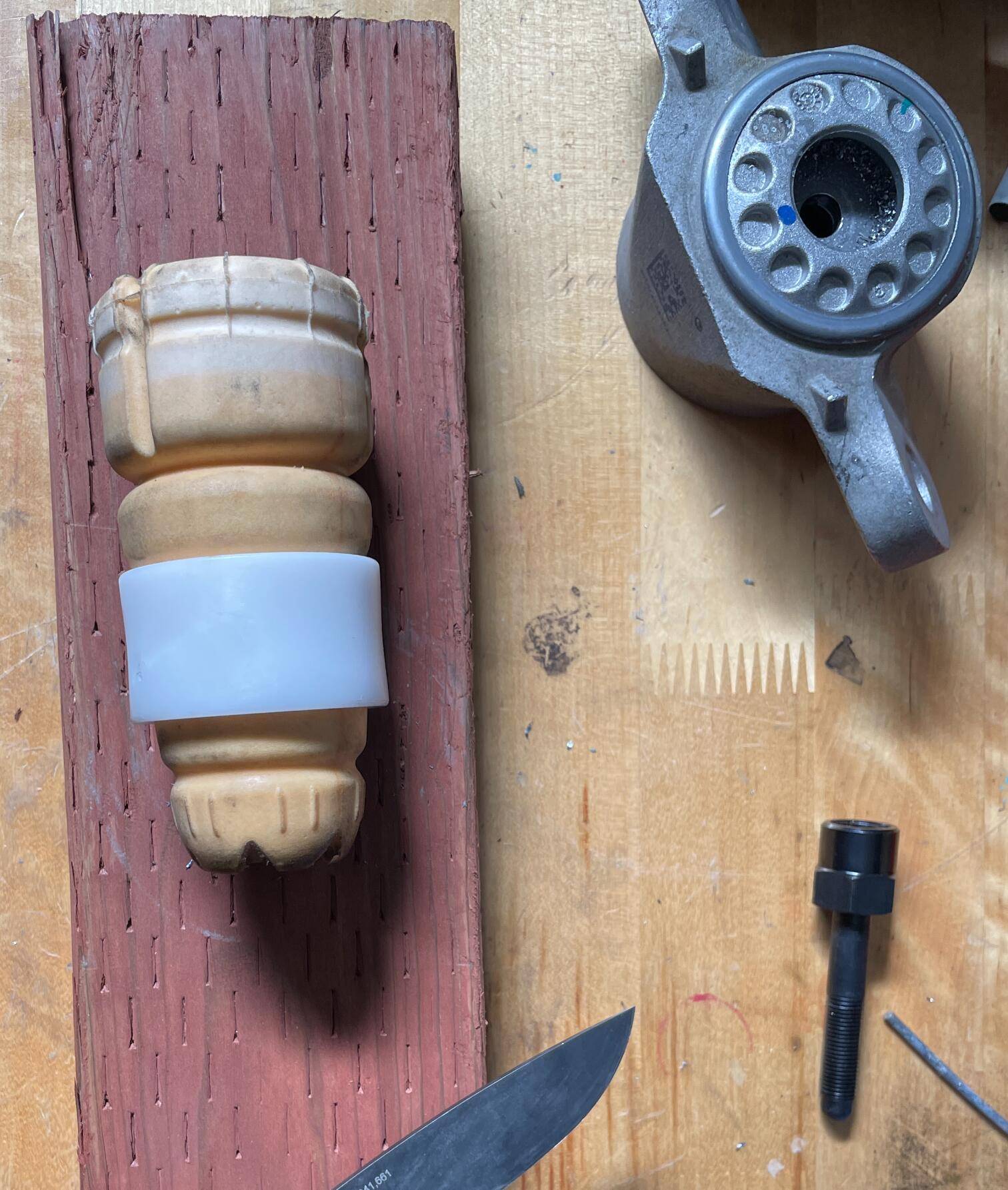

The problem we still have, even with these is the ride height of the shock isn't engineered to the ride height of the MME. At ride height the piston sits in a sweet spot in the shock. It's usually got a little more give in order to soften minor imperfections. We have no idea where that piston is in relation to that sweet spot. As the piston in the stock shock is actually about 2 inches lower in the body than the Koni's for the 2014 Mustang I wouldn't bank on it adjusting correctly. It sounds to me like a multi floating tube shock. BUT that shock is designed for the weight of the rear of the 2014 Stang. We're substantially heavier.
The MME actually needs nearly no compression on the shock. I proved that out with the Vikings and that 0 or 1 clicks in provided more than enough compression dampening. With the Yellow Koni's we're slowing the rebound as much as we can. They have a good mix of compression, though it's not right in that sweet spot that these shocks were designed for. I'd be willing to put money on the fact that if I could extend the shock rod about 2 inches the ride would significantly soften the minor things better. The problem being, no one is going to feel very confident putting a small extension on the shock end. The thing the Vikings some with is the best example of what I'm talking about but the thread size won't work. And you couldn't get to the adjuster if you wanted to without having to take that extension back off. (the little black bolt bottom right)
