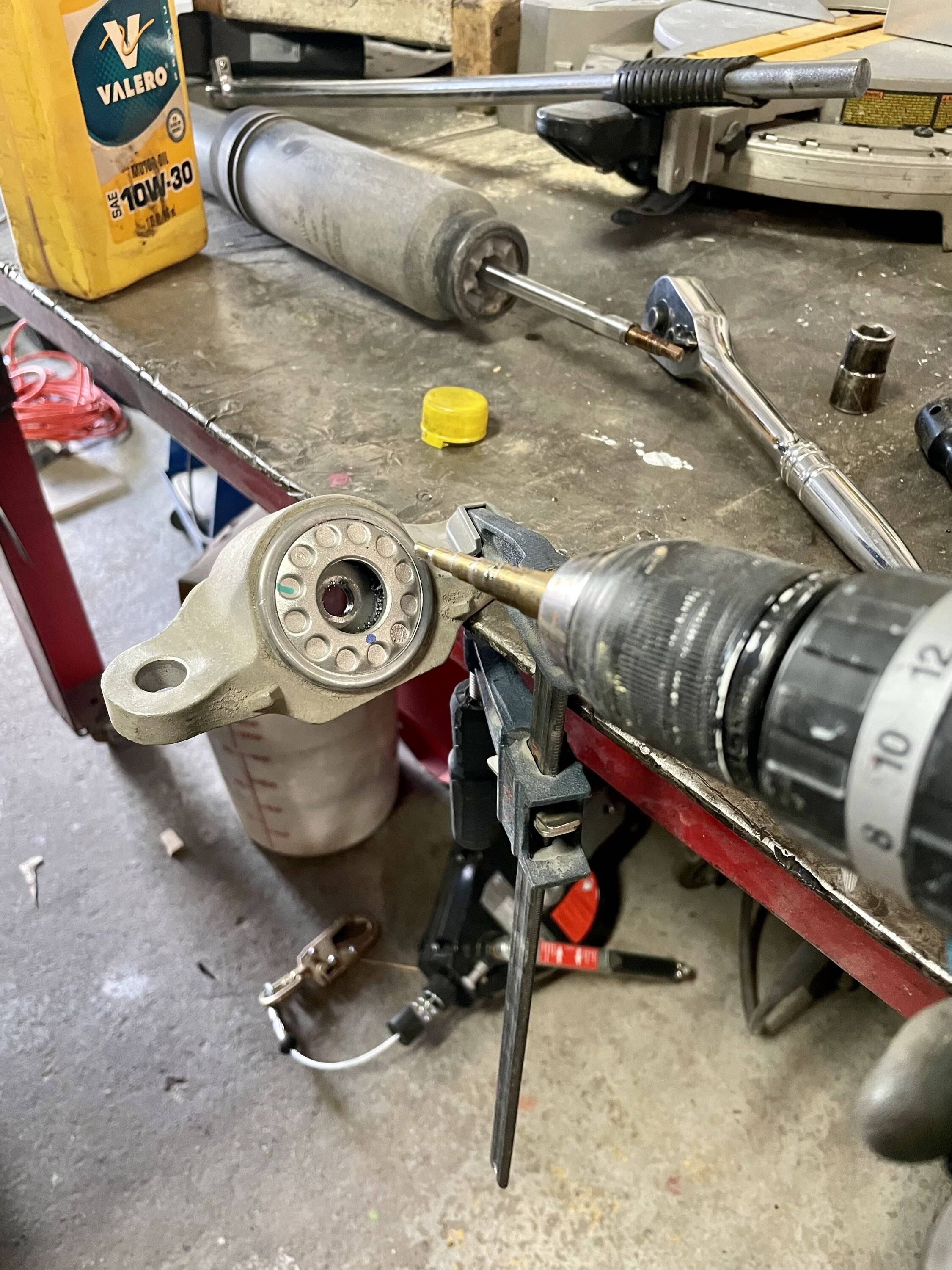

The assembly of the shocks went as described in the OP. I used a step drill on a short extension to drill the 1/2" hole in the shock mounts (lube it with a bit of oil first), and a small pair of nippers to "fix" the plastic dome. I did put a small dab of RTV on the adjust tab after adjusting - if I ever need to adjust again it will pop free easily.

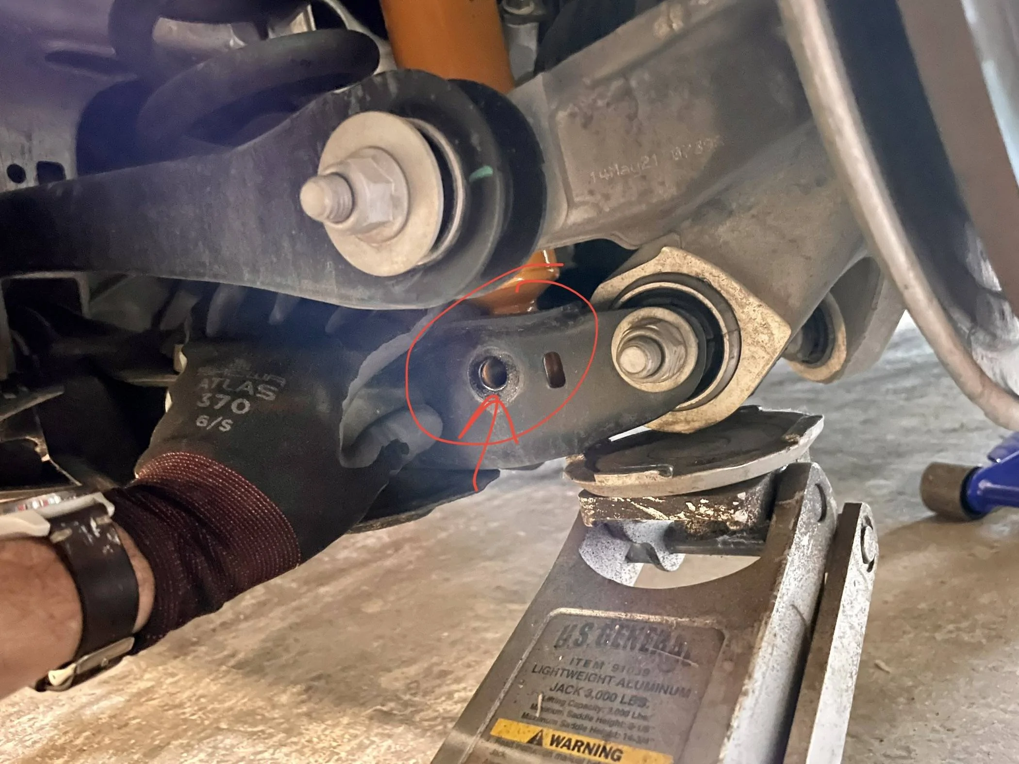

  3. Re-assembling the lower shock mount is the trickiest part, but there are tips that help. My recommended process is:
    1. Put the shock assembly in place, and thread the two upper bolts in about 90% of the way, but where the shock can still swing and move around.
    2. Put a 2nd small jack under the lower suspension arm, and lift it up slightly until it aligns with the lower shock hole.
    3. Pro tip - use a dab of RTV to stick the washer onto the lower shock mount! But even if you didn't do that, slide the front washer into place, and slip the bolt into it. If it is being finicky, slip a small screwdriver in first from the other side to hold the washer in place, and then feed the bolt through.
    4. When the bolt is halfway in, slide the other washer into place, hold it there with the screwdriver shaft, then push the bolt the rest of the way through.
    5. Thread the tabbed nut back on, and thread the bolt to hand-tight.
    6. Release the 2nd jack, torque the upper bolts, then torque the lower bolt (81 ft-lbs).

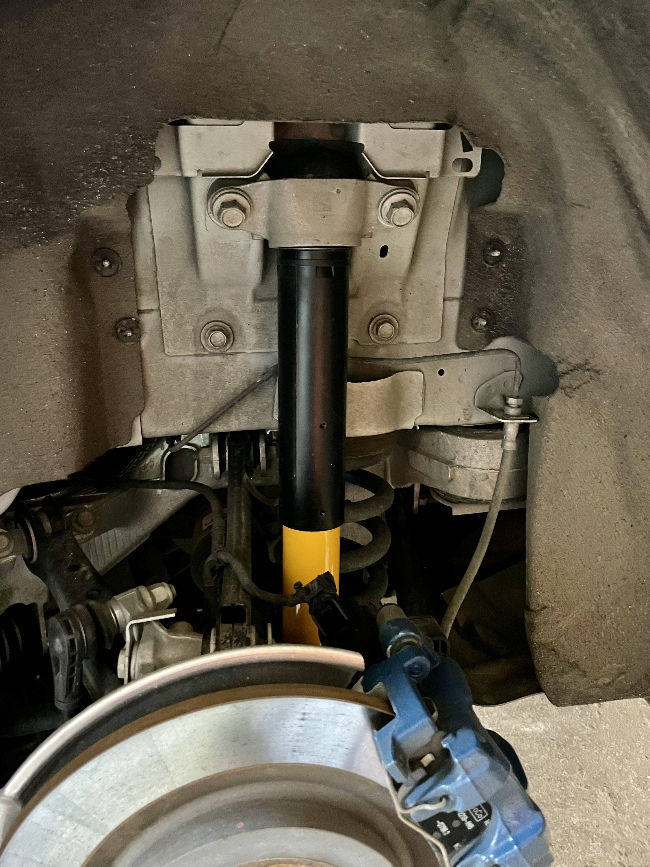

Ford Mustang Mach-E UPDATED: Replacing Rear Shocks: Reducing the rear end bounce. IMG_1376
Drilling out the stock shock mounts. Step drill (a short extension will be needed in most cases), and a little lube for good measure.
Ford Mustang Mach-E UPDATED: Replacing Rear Shocks: Reducing the rear end bounce. IMG_1377
Shock assembly back in place, you can barely see the dab of blue RTV over the adjuster tab (after adjusting, of course).

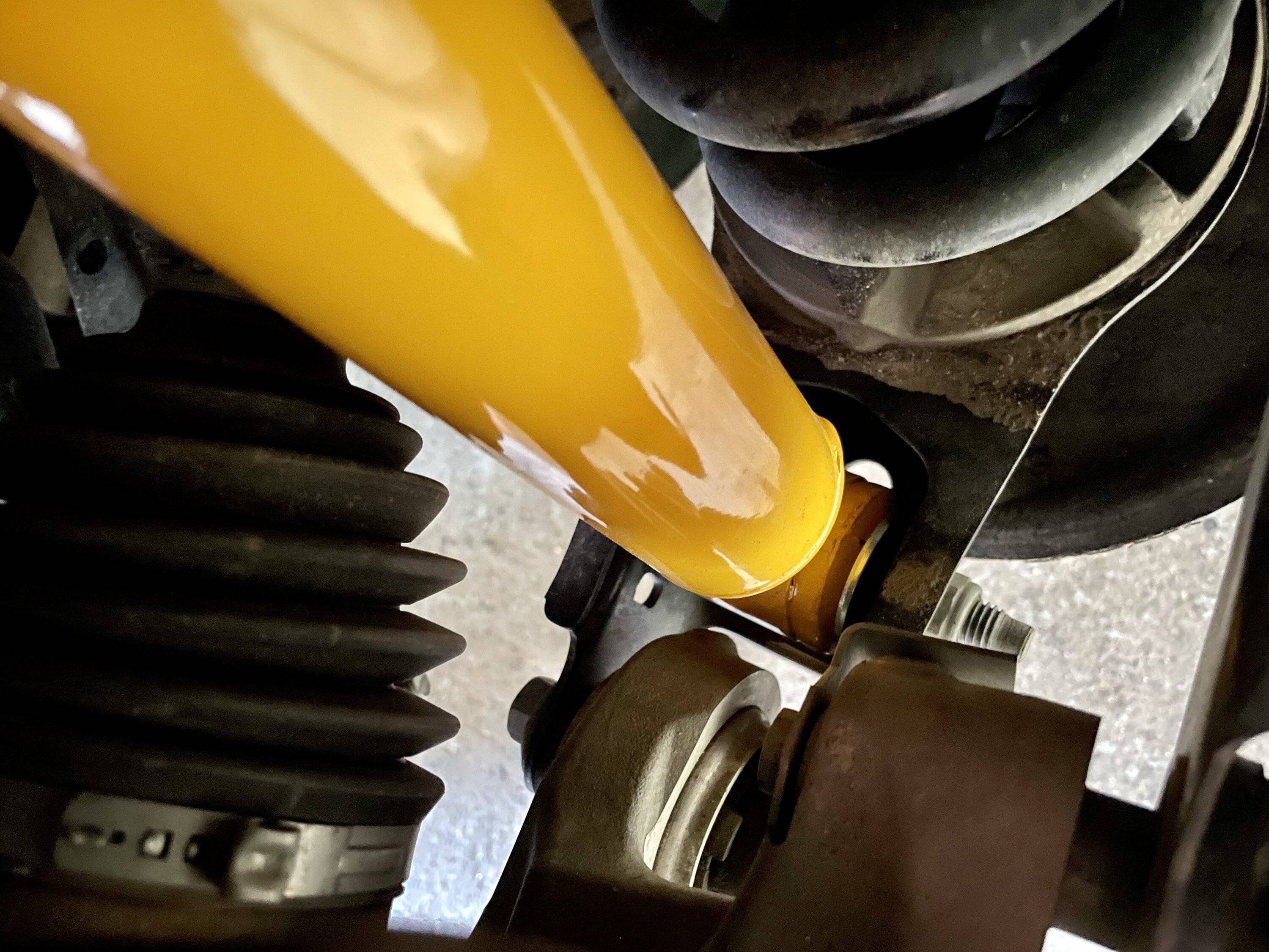

Ford Mustang Mach-E UPDATED: Replacing Rear Shocks: Reducing the rear end bounce. IMG_1379
Lower shock assembly in place. You can see the conical washers in place.

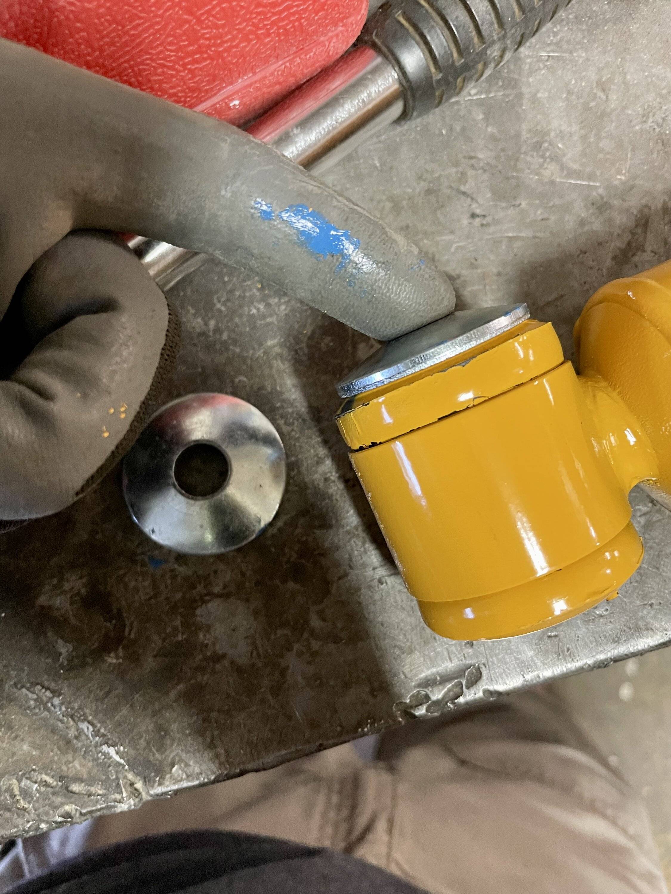

My shocks came with two of these conical washers each. They were the perfect size for the shock mount, no additional spacers needed. Maybe they weren't included in some people's orders?

Tip for aligning the lower shock mount. The upper is threaded 90% of the way in but can still swing around. Use a jack to lift the lower suspension arm about 1/2" until the hole is perfectly aligned.

Thank you Sam for the compliments and the additional install info and photos. Glad this has helped smooth out some of the bounce for you.
About the conical washers that come with the Koni's, I had tried them out but found after a period of time with the suspension moving about as it does, the washers would actually flatten out a bit creating a space and would start to cause a knocking noise. This is why I went with flat washers so as not to have any issues down the road. I have seen slightly different thickness of those conical washers supplied with the Koni's and maybe you will have better luck than I did with them.
Ahh, uh oh… Well, in my case it did seem like a snug fit, so hopefully they are sized right. I’ll keep an eye out for any knocking and if I end up having to swap washers at least I have them handy, and will report back on the condition of the conicals.

When I’ve use those conical’s in the past, they usually compress down when bolting them down. The washers that Mark suggested pinch the metal, and when I’ve tighten them down in the past, they actually put marks into the washers, so there is a little bit of canter in the way that the shock lines up with the a arm. I’ve built shock mounts for the Vikings that include that 5 or so degrees of cant. They don’t work for the Koni’s as you can’t remove the metal from the rubber on the lower. (Viking development and testing is stalled due to summer, and another thread)
