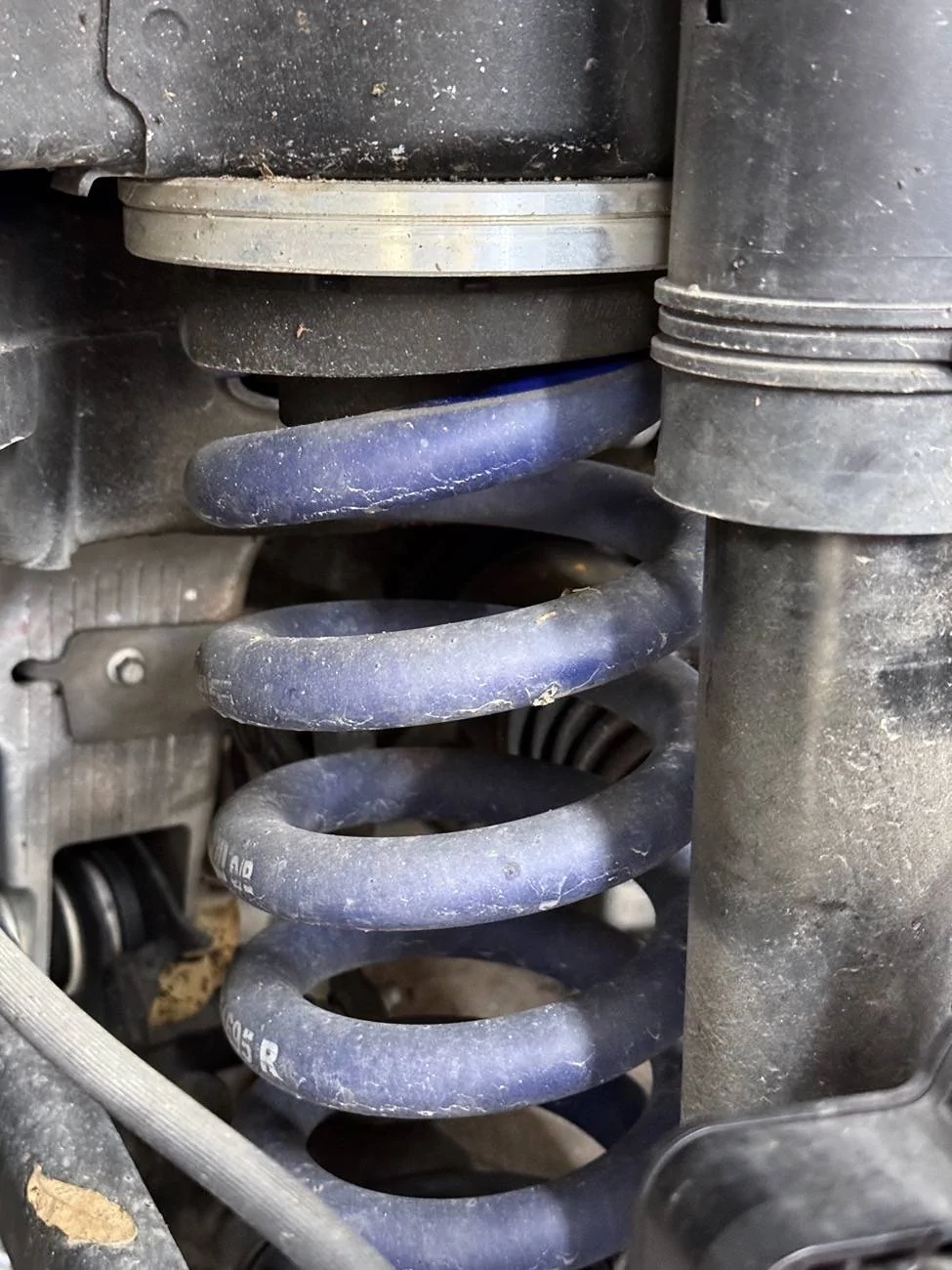

@markboris - No desire to ever switch back to the stock springs with the Eibach's I have now but just curious if you know of any way to lift the Mach-e back up maybe an inch with these springs? Is there such a thing as a coil Spring Spacer that could be dropped into the Spring pocket and essentially lift this vehicle back up a bit? If so that might appeal to more owners who want a better ride but are turned off by the lowering aspect of the Eibach springs.
You absolutely can use spacers for the rear and I have done that when I originally had the H&R springs on my car a couple of years ago (they were out way before the Eibach's). H&R messed up on their lowering springs and after installing them, the rear was actually lower than the front. As you can imagine, that did not go over too well with me so I used some Steeda Mustang rear spring spacers (aluminum rings) which are easy to install. They just sit right above the spacer that is on top of the rear spring. You can raise up the rear as much as an inch. Unfortunately there is nothing you can do to raise up the front unless you custom made special spacers that would go on top of the strut mount and would need longer bolts to attach it all.
Rear spring spacers at the top of those H&R springs:

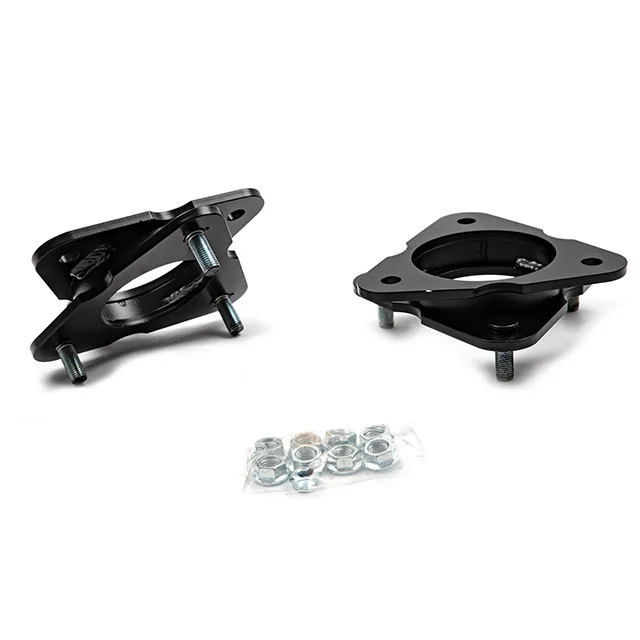

Ahh ok. I did find this German site that appears to have front and rear spacers for the Mach-e. However they're very expensive.
www.spaccer.com
a 24mm set front and rear would cost $843.xx before shipping and VAT fees, etc.
