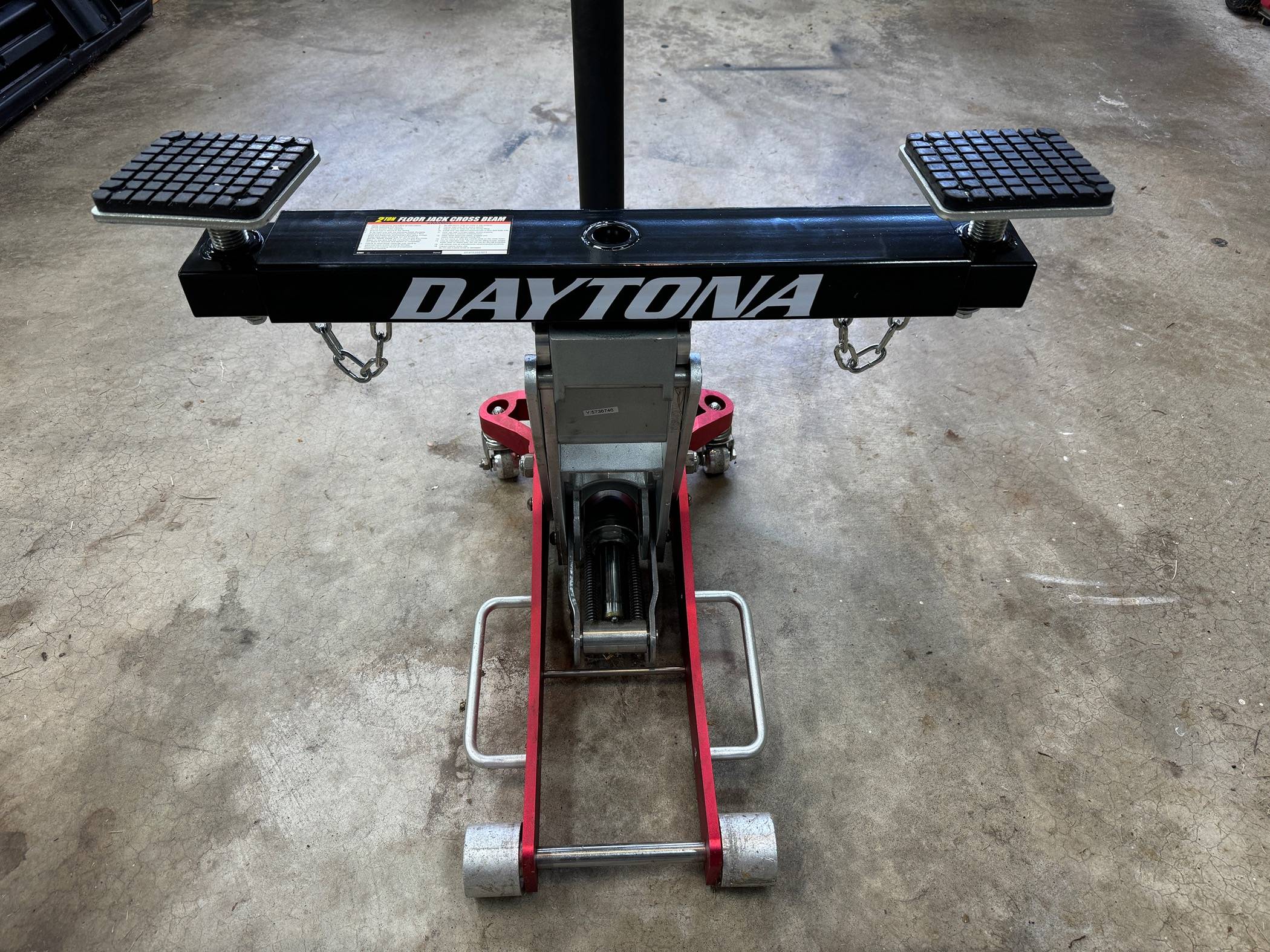

I'm fairly sure it won't fit on my Norco floor jack. I took a spin out to Harbor Freight in Manassas yesterday to check out the spreader and give the blue cruise another test run on 66. The BC works fine on my car, but not sure it's worth buying when trial is up in a few weeks. HF didn't have a spreader in a box we could open to check the connector bolt. I volunteered if they had a hex wrench the right size I could pop the bolt out of the display model and compare it to the bolt from my Norco. That was a no fly zone at HF. Go figure. I said I'd put it back together :) . I did call HF CS and was told the connector bolt is 1"OD, 4" long, and 8 T/I pitch. I have a metric pitch gauge and measured the Norco bolt at 1.5mm and major diameter of threads at what seems a kind of odd figure of about 23.5mm, of course I can hardly read the markings on my caliper with or without glasses. Maybe it's time to go digital ... Norco confirmed their sizes are metric. So, there you have it ... either I lift one corner at a time or make a DYI spreader.

The craziest thing happened. The Great Poodle came to me in a vision and barked a commend. Loosely translated the command was…’take a ride to Harbor Freight and see if the HF spreader bar will fit on your jack’.
It fits the Norco jack perfectly. The HF CS person who provided the 8tpi thread pitch spec must have stopped by the Blarney Stone to get that info.

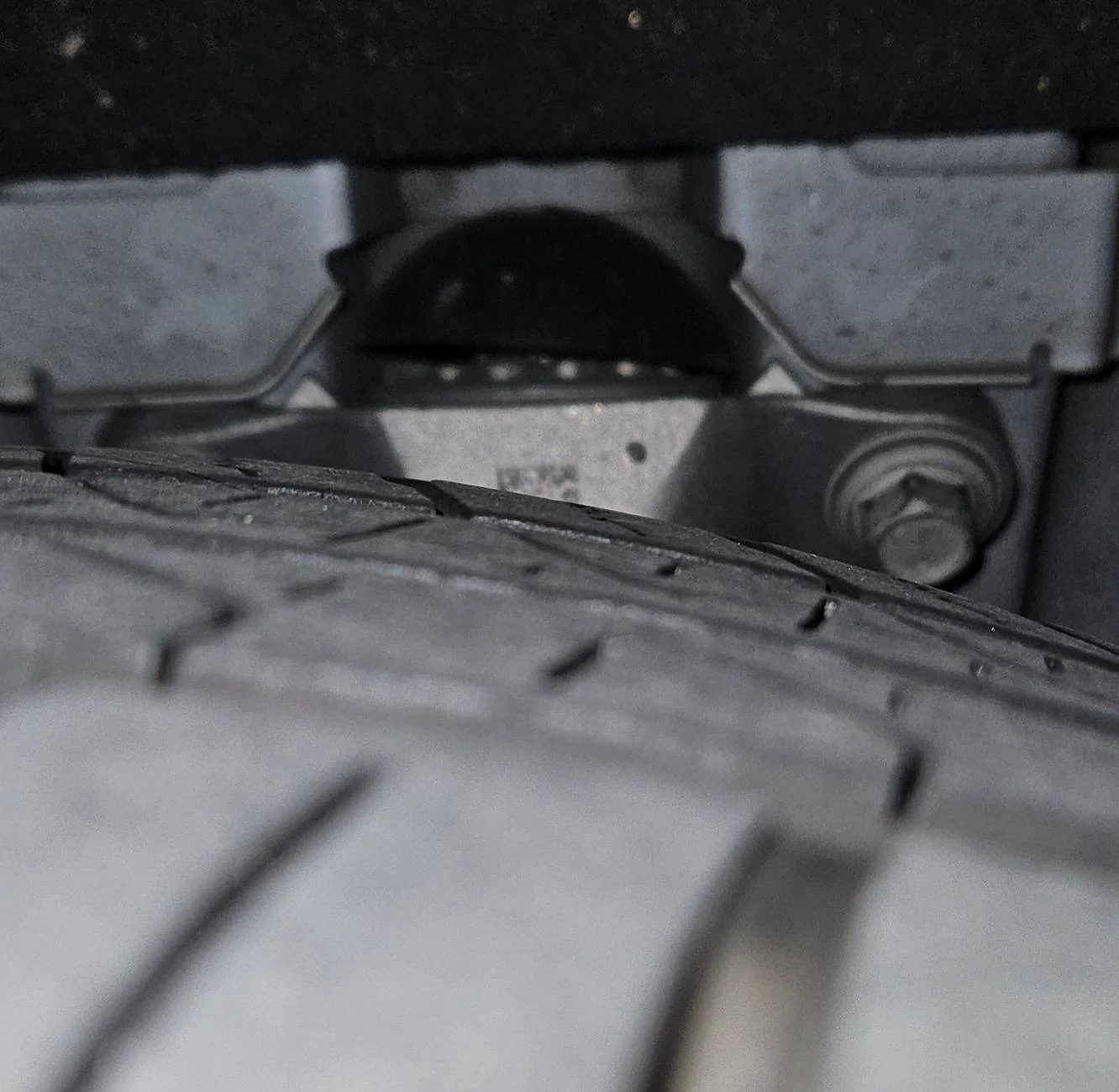

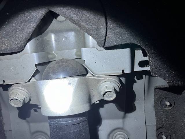

Anybody know of a tool that can be used to easily adjust the Konis without taking off the wheels? I'm imagining a really long wrench with the koni adjuster at the end.
By the way, after peaking for the first time in about 6 months I noticed my caps are loose on both sides.

Yeah the caps come loose from the Koni adjuster hitting them in the hole. You could drill a bigger hole and possibly find something to work as a cap to that. I've left my caps off for almost a year. I don't get much if any rain but I did drive a few dirt roads. It'll take a LOT of build up in the mount for any noise to happen. I think it's mostly to keep it from puddling up water for days. The caps have a long way to go before it'd come off so that gap isn't an issue really.
As for adjusting I jack mine up (in the garage with a floor jack at the rear puck spot). I've done it so many times I don't even use a puck now as I need to only lift the car about 3 inches to get my arm in. I've tried to find a magic parking style on a curb but so far havn't been able to get my arm in.

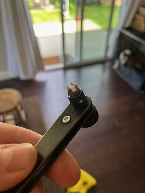

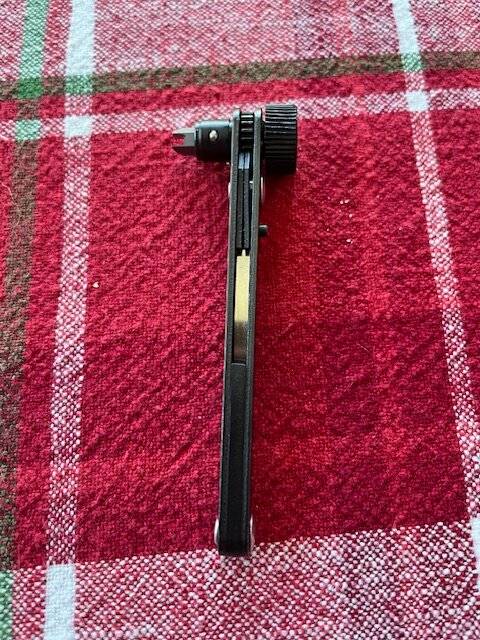

So, after much trial and error that I don't want anyone else to suffer through, here is my solution...
Ford Mustang Mach-E UPDATED: Replacing Rear Shocks: Reducing the rear end bounce. IMG_4721
Ford Mustang Mach-E UPDATED: Replacing Rear Shocks: Reducing the rear end bounce. IMG_4720
1. The Koni knobs don't fit above the mounted shock, but keep them so you know which way to turn for + or -
2. Head on over to you local harbor freight and grab this right angle ratcheting screwdriver for $3.
3. Take a Dremel Tool, cut the top off the 1/4 flat head bit and then cut a notch into the bit.
3a. Realize you don't have a Dremel Tool and head back to harbor freight.
4. Jack up car and adjust shocks! You may have to trim the shrouding to be able to get your tool onto the "fin" of the shock. I cut vertically and folded the remaining material back while adjusting.
