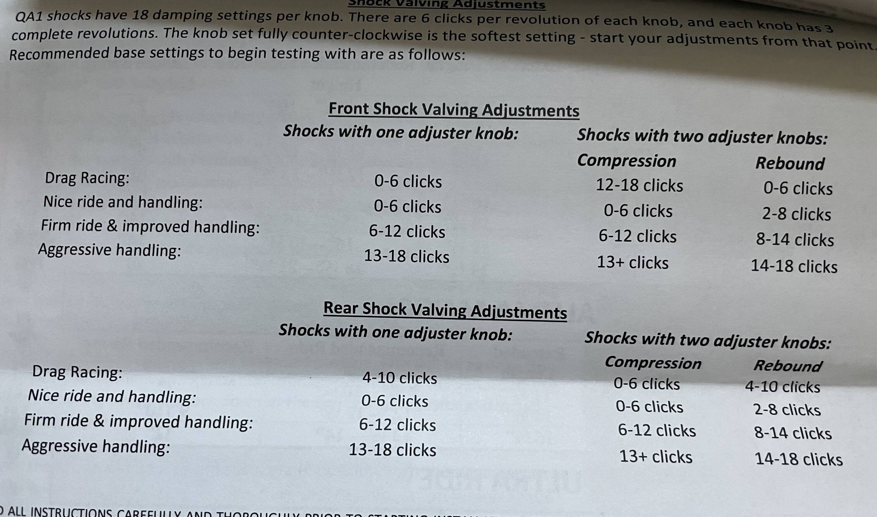

$225 is $10 more than I paid for the single adjust QA1s. Whats the warranty like on the Viking.
I've said it all along, it needed heaps more rebound dampening. Compression adjustment settings will be weaker for those of us with the Steeda bars as the bar stiffens the compression. Having the ability to dial that for those on stock bars is going to be helpful. Not quite 2 birds 1 stone but def would help those without the rear bar.
QA1’s settings are pretty much the same
Viking warranty is 2 years. They are completely rebuildable and customizable in case you want to have the valving changed. By the way, they are not gas charged shocks which by design will give a better ride.
