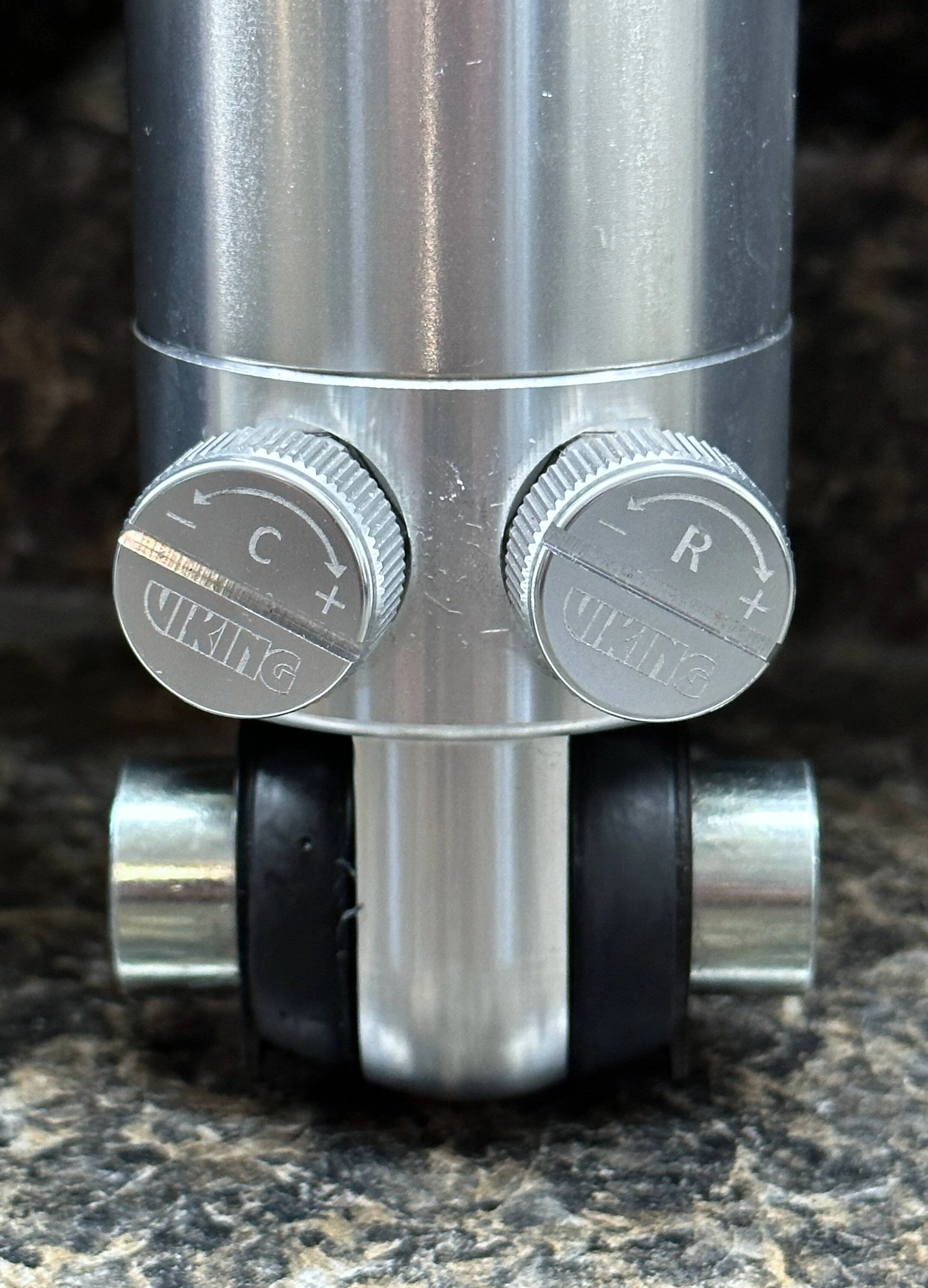

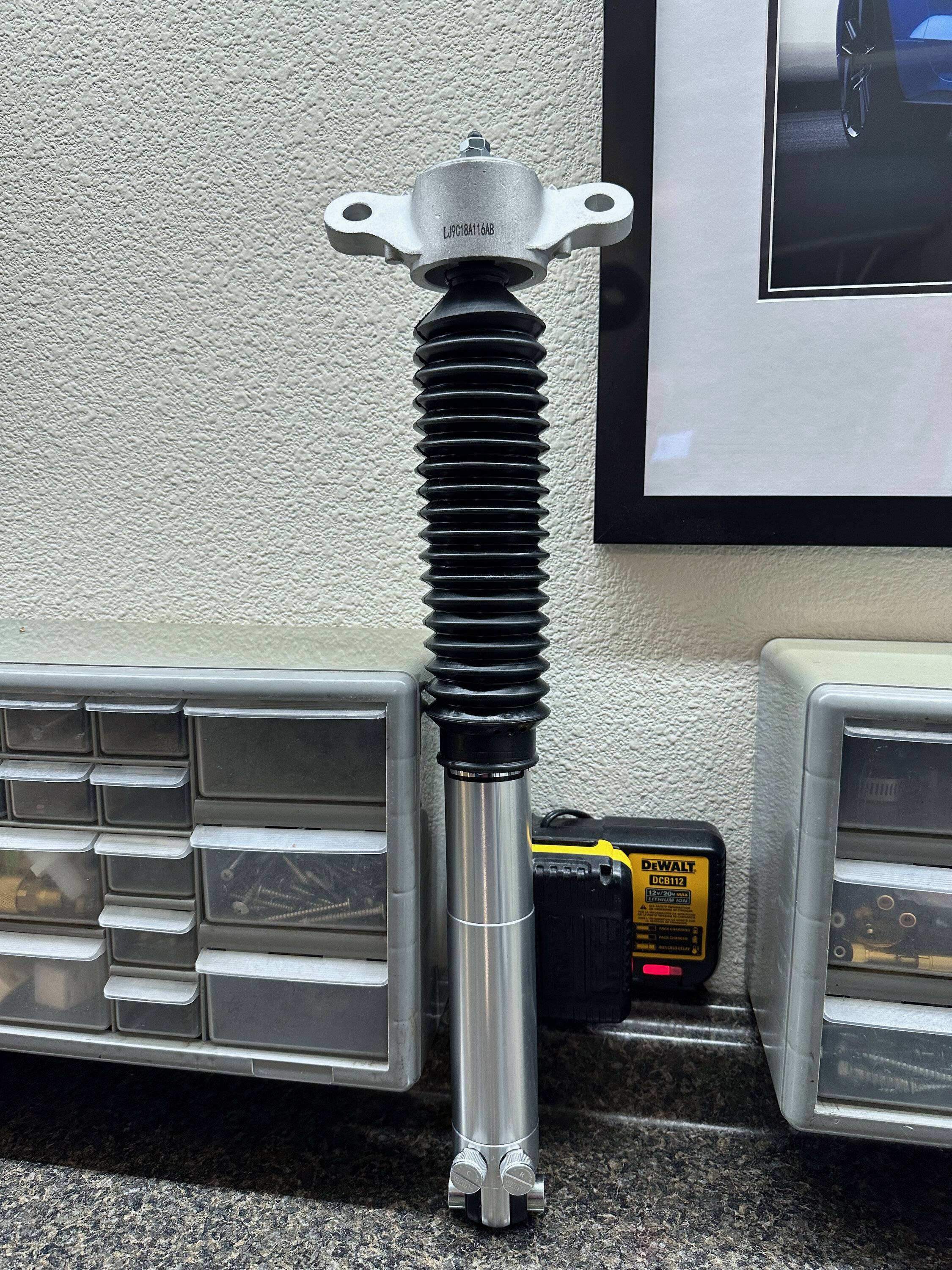

Quick update, besides the Bilstein B6 and Koni Sport Yellow Mustang shocks, I have been testing three different Bilstein B8 Truck shocks (Ranger, F250, Toyota 4 Runner). All the B8's seem to be very similar if not the same in performance. However all the B8's have firm compression and somewhat week rebound even though they are self adjusting shocks (based on road conditions). The B6 is more 50/50 which is better but not has HD of a shock than the B8's with their larger piston rod and body. The Koni still has the better combo with a weaker compression and stiffer rebound.
Today I just got in the Viking dual adjustable shock and this one may just be what we want. It is the most heavy duty of all of them and because it is both compression and rebound adjustable, might be able to dial it in a bit better. I was originally looking for a more economical choice but if it does not do the trick, might just have to go with the ones that do. These are hand made to specs and if they work out, I can have them change out the bushings and rod end to fit the Mach-E without me having to add these extra parts. The Vikings are a bit more than the Koni's at $225 each. Really excited to try these out on Anton's car.

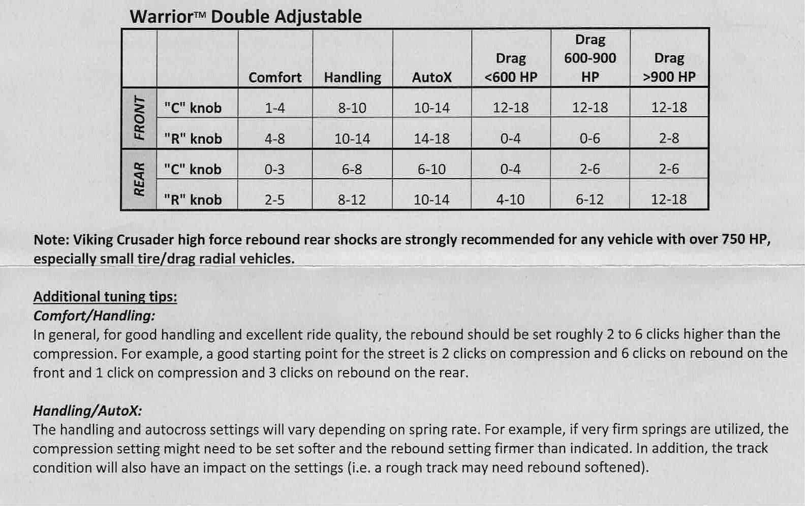

A couple of photos of the Viking. I used one of the Bilsten B8 dust boots which fit perfectly, ordered more. The Ford upper mount also fits well. I did not have the top dust cap on this when took the photo. They offer a chart suggesting different settings depending on usage. The chart states for a comfort ride to have the rebound stiffer than the compression which is what I have been trying to achieve and only the Koni's set on the most firm setting does this until now that I got the Vikings.

$225 is $10 more than I paid for the single adjust QA1s. Whats the warranty like on the Viking.
I've said it all along, it needed heaps more rebound dampening. Compression adjustment settings will be weaker for those of us with the Steeda bars as the bar stiffens the compression. Having the ability to dial that for those on stock bars is going to be helpful. Not quite 2 birds 1 stone but def would help those without the rear bar.
QA1’s settings are pretty much the same
Since the Vikings are more adjustable they might be the better choice and since only 2 are needed for the back not a terrible cost for most people. Of course assuming they help
