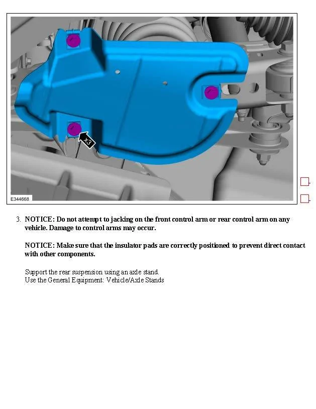

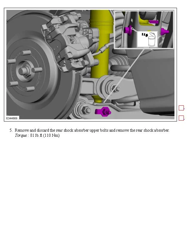

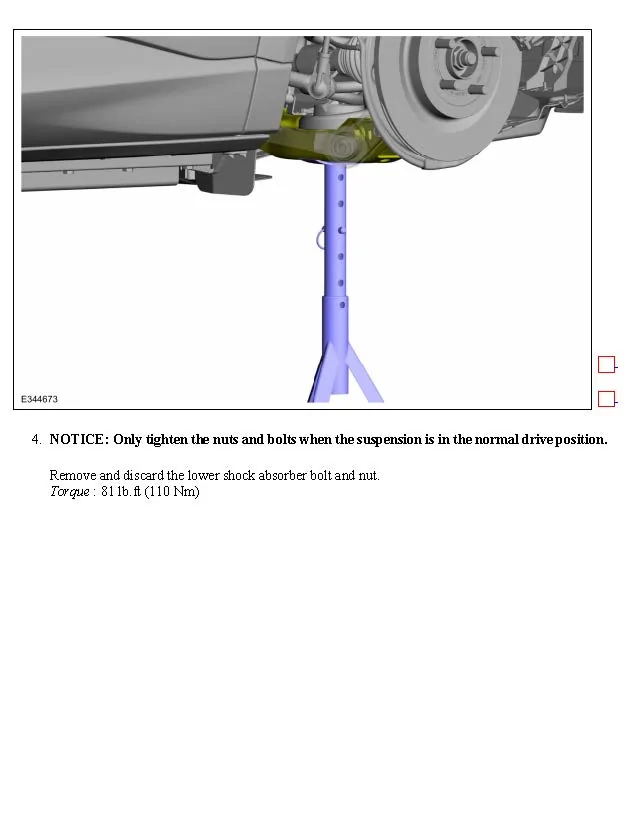

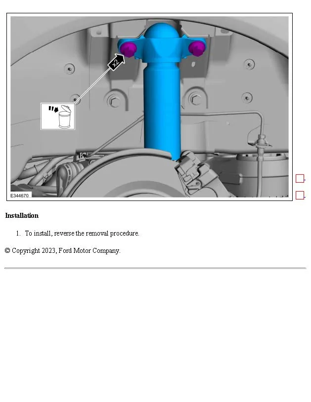

Rear Shock Absorber Instructions. You'll need Adobe Acrobat reader to view the files. I can also convert them to word if that's better.
While those are Ford's instructions to remove the rear shocks, I do it a bit different. I don't have to remove the lower arm deflector because I jack up the car at the rear jack point under the frame (where many of us have installed pucks). That way the shock is extended and much easier to remove and replace. But hey, either way works.

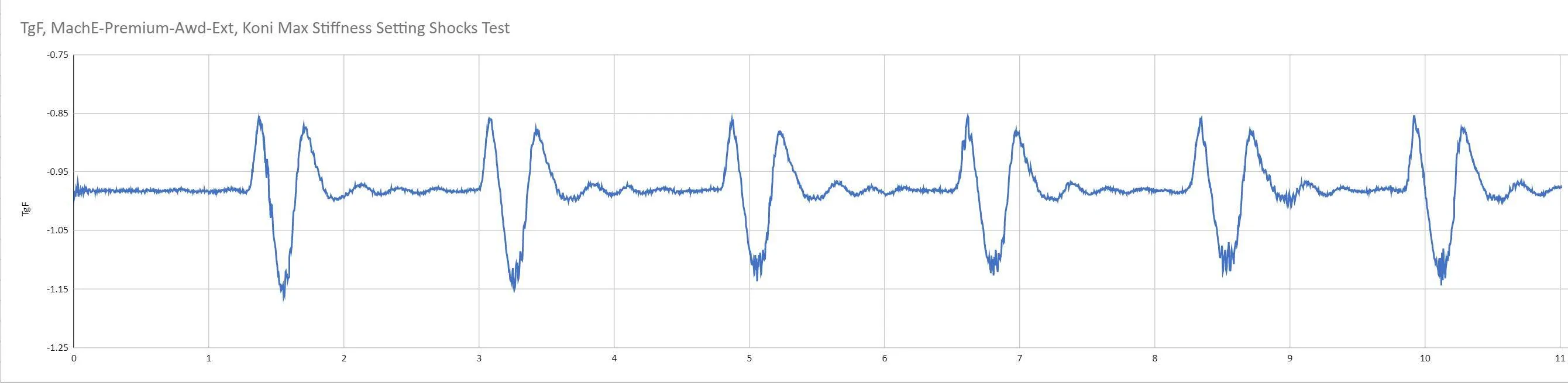

And as a follow-up, here's a comparison of the Mach-E to my old Fusion, which has a great suspension. Same exact scales.
This shows how underdamped the Mach-E is. The Fusion damps everything in only 1 cycle vs. 3 for the Mach-E. The spring constant is less (car is much lighter) so there's more acceleration from my body force, but the bump is over with much faster than the Mach-E. The Fusion is the kind of graph we want.
Here you go. Same test done with the Konis. Put the phone on the trunk, and tried to push down as hard as I could and let go. As expected, It's much more difficult to compress these Konis than the OEM shocks. (Source - tab: "body-slam-koni").
Ford Mustang Mach-E UPDATED: Replacing Rear Shocks: Reducing the rear end bounce. 1678152256778
11,382
25,072
Cool, good job. That's an improvement, but interesting you can still see 2+ cycles afterwards even with them set on max. The magnitude of the second cycle has been reduced significantly, but it looks like it could use even more damping.
I wonder if some of the "long wiggle" afterwards is related to resilient bushing loading elsewhere in the suspension? If you have time during the next swap, I'd be curious to see if the graph changes if you disconnect the sway bar and repeat the body slam test?

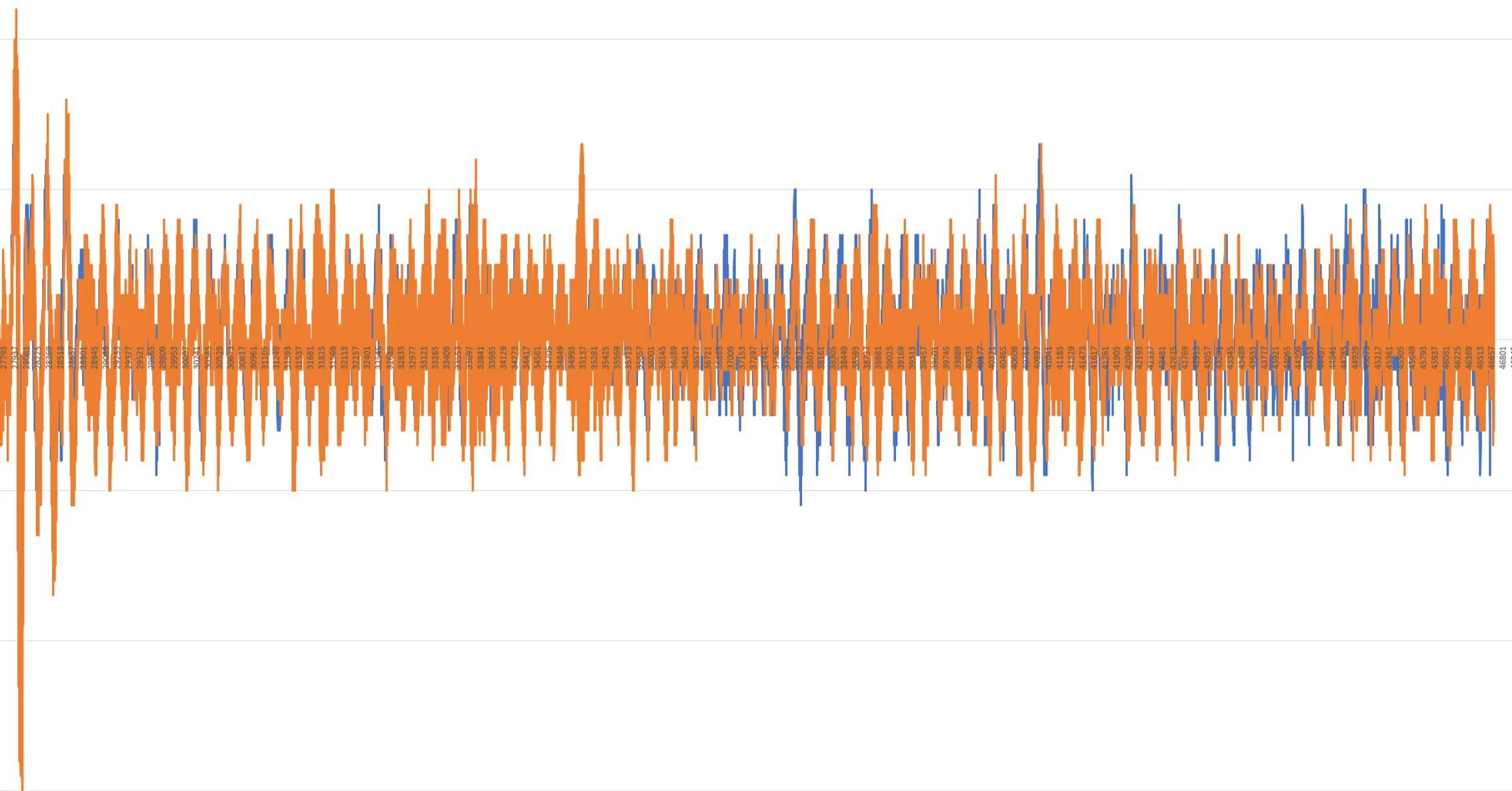

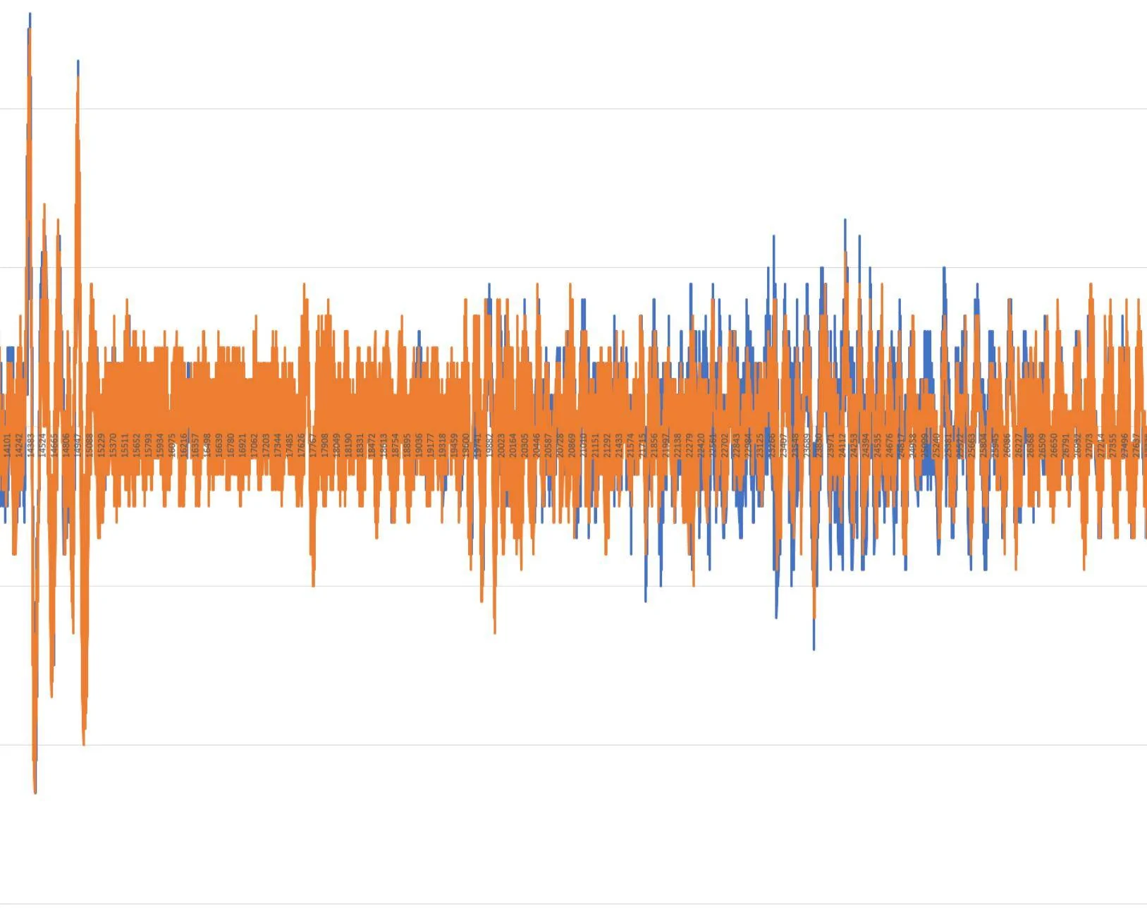

So I messed up this time and took gyroscope readings (velocity) , and not G-Force (acceleration) when I had the OEM shocks. Not sure how useful it is but I'll share this data anyways. Blue is OEM, orange is Koni (max stiffness). This is showing wx, which I've determined to be most closely applicable to up-and-down motion.
Ford Mustang Mach-E UPDATED: Replacing Rear Shocks: Reducing the rear end bounce. 1678153315634

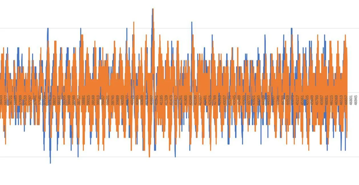

Now comes a big bump
Ford Mustang Mach-E UPDATED: Replacing Rear Shocks: Reducing the rear end bounce. 1678153375955

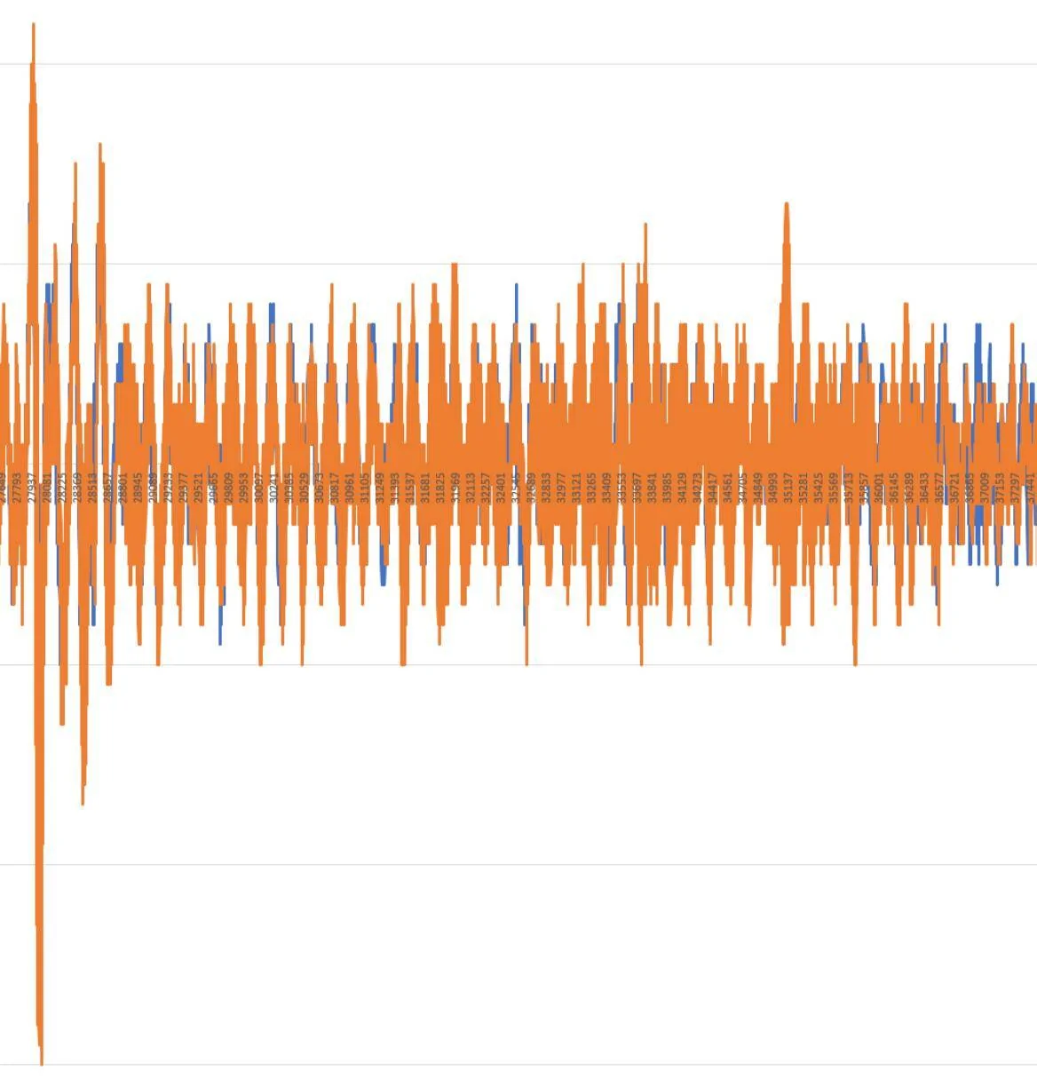

Big bump #2
Ford Mustang Mach-E UPDATED: Replacing Rear Shocks: Reducing the rear end bounce. 1678153438215

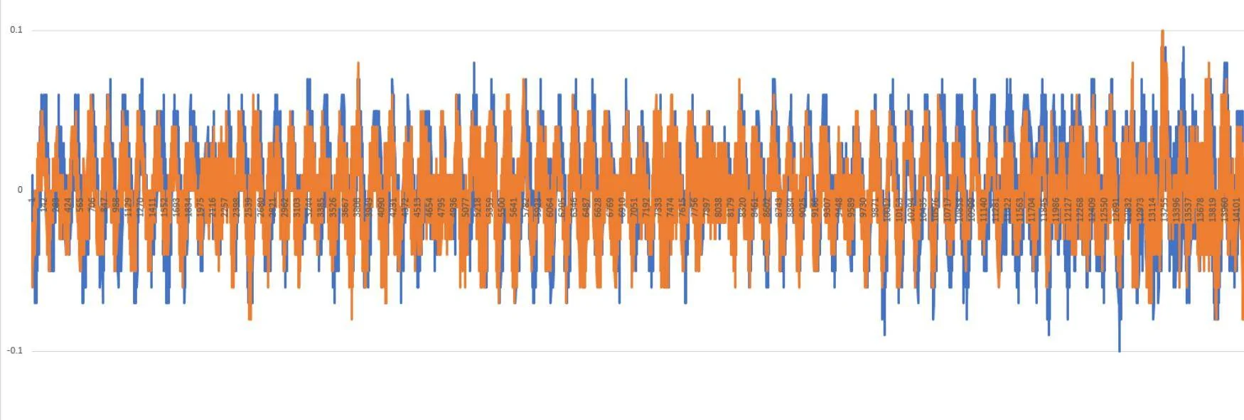

and settle...
Ford Mustang Mach-E UPDATED: Replacing Rear Shocks: Reducing the rear end bounce. 1678153476967
I'm sharing this data for transparency even though I don't believe it comes close to describing the improved feel of the car now (on that later). (Data source)
