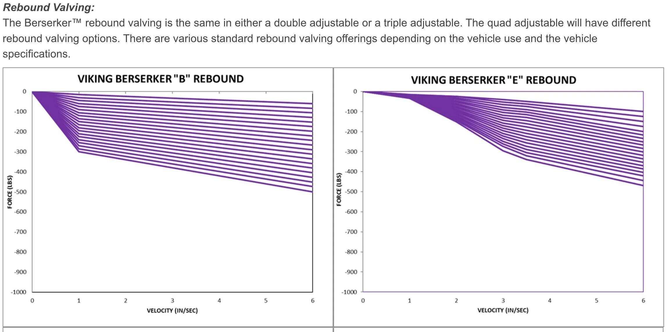

Yeah, been kicking myself for not just getting the duals. Trying to save $200 cost me $425. It's how I roll. Trying to decide if I just order QA1's or go to Viking.
I was looking at the Viking charts and one in particular looks promising.
Ford Mustang Mach-E UPDATED: Replacing Rear Shocks: Reducing the rear end bounce. Screenshot 2023-03-10 at 8.39.39 AM
While the b valving is an over all slower rebound the E has the taper I think the MME needs. Though .5 second faster would be nice.

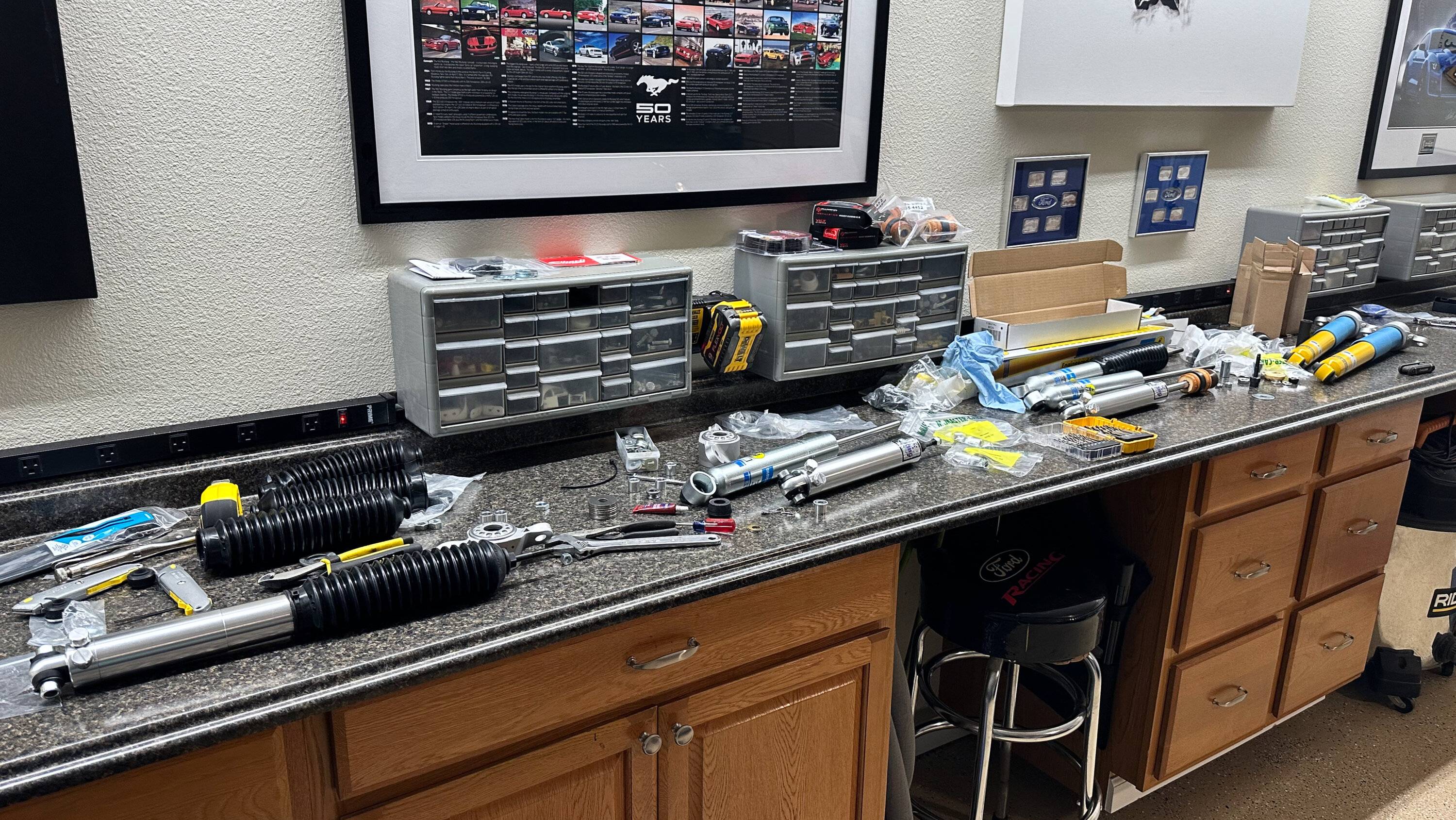

I don't have the time tomorrow at Anton's to change out all 4 sets of shocks to test them, besides one of them being the Dual Adjustable Viking, that would take much longer to try and dial in. So I have decided to ship the Vikings to Erik in Arizona for him to spend the time to test out. I will test the other 3 non adjustable shocks at Anton's and Anton will post some charts what he finds when we use is accelerometer app or whatever it is. That is his department. ?
This is part of my work bench right now. Not very organized but I know where things are...... The shocks that are not shown are the Koni's that are on Anton's car and one of the Bilstein B8's that are on my car.

I don't have the time tomorrow at Anton's to change out 4 sets of shocks to test them, besides one of them being the Dual Adjustable Viking, that would take much longer to try and dial in. So I have decided to ship the Vikings to Erik in Arizona for him to spend the time to test out. I will test the other 3 non adjustable shocks at Anton's and Anton will post some charts what he finds when we use is accelerometer app or whatever it is. That is his department. ?
This is my work bench right now. Not very organized but I know where things are...... The shocks that are not shown are the Koni's that are on Anton's car and one of the Bilstein B8's that are on my car.
