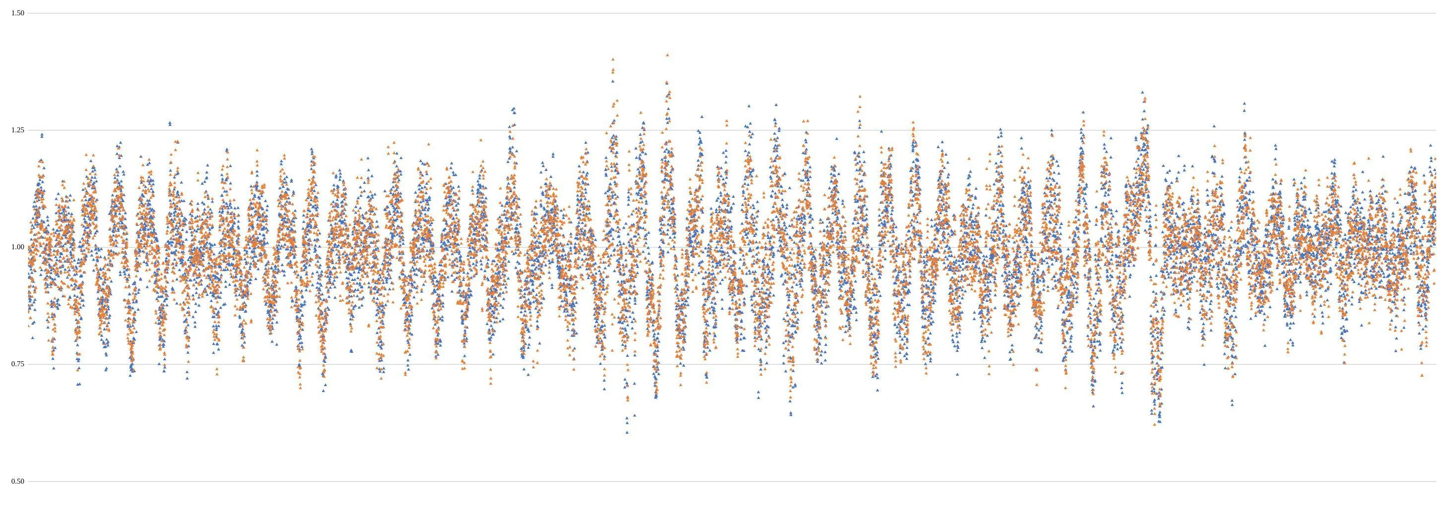

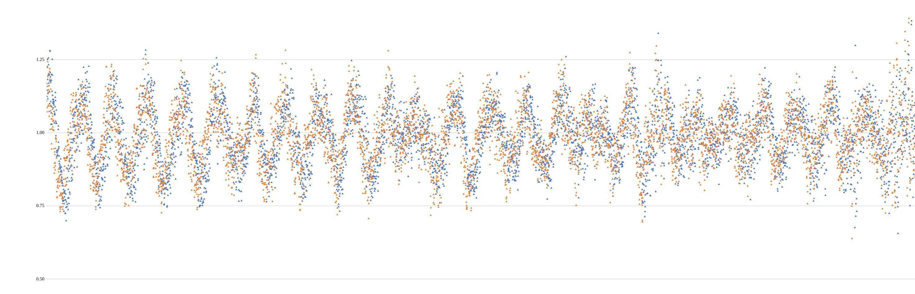

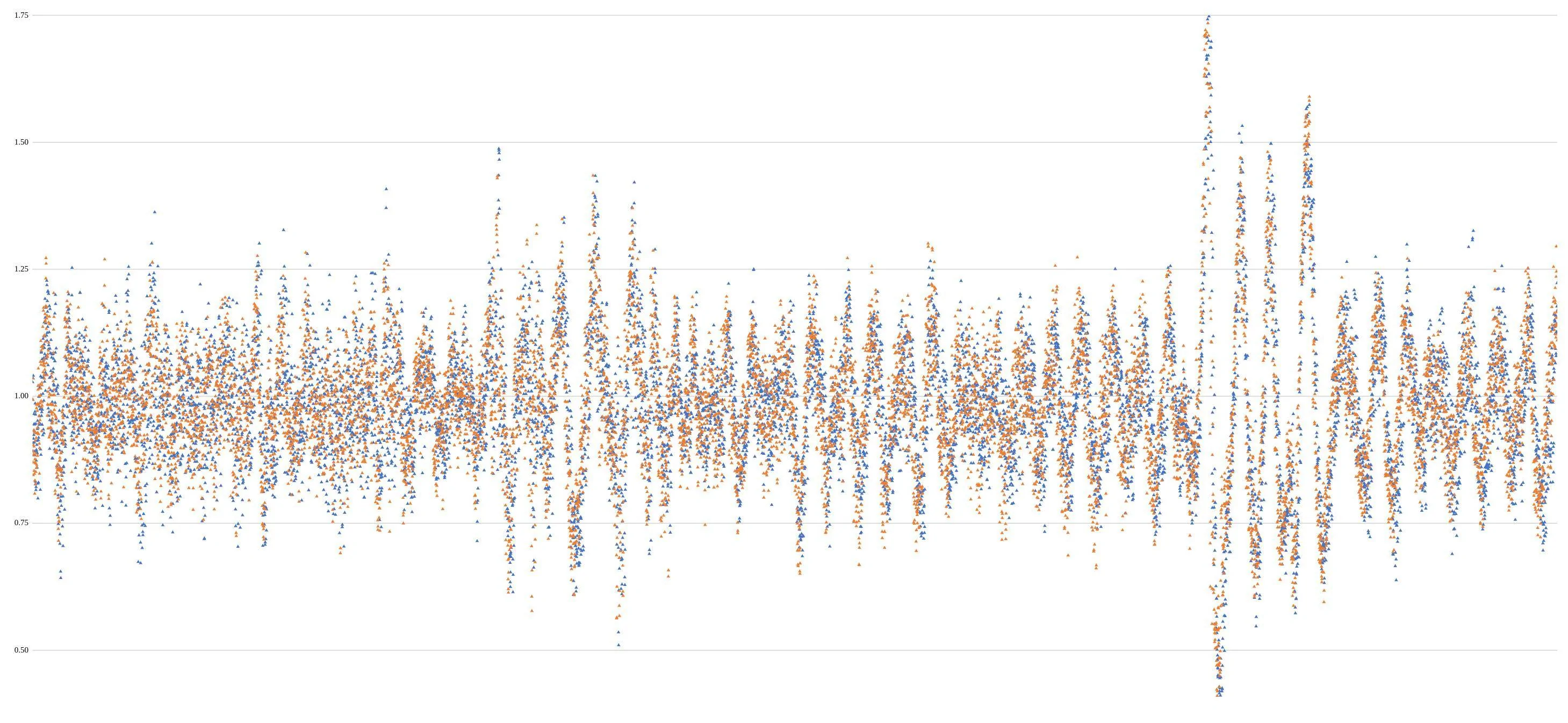

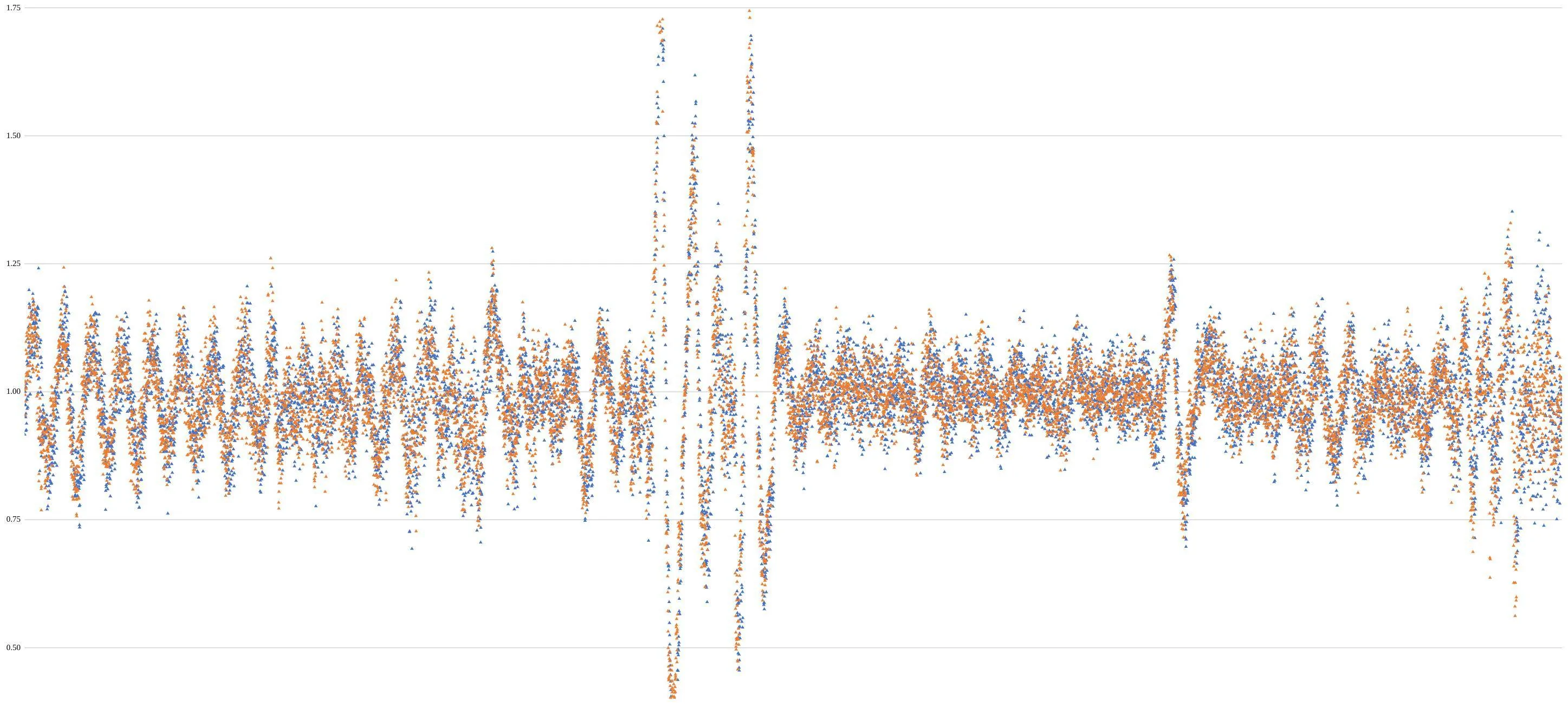

We have a problem. The data does not resemble the very noticeable difference that was felt between these 3 shocks. Here's the data loaded to google sheets. Feel free to download / make a copy and analyze, or make a new tab for a graph (edit is turned on). All data was collected going 73 mph southbound, then northbound on a section of road near my house @ 39psi on OEM Premium wheels. There are 10 tabs total:
  1. oem-s : oem shocks going southbound
  2. oem-n : oem shocks northbouind
  3. blst-s : bilsteins south
  4. blst-n : bilsteins north
  5. koni-s : koni (most aggressive setting) southbound
  6. koni-n : koni (most aggresive setting) southboard
  7. oem-v-koni-s-10k-20k : graph of oem-s vs. koni-s gFz on data points 10k-20k.
  8. oem-v-koni-n-10k-20k : graph of oem-n vs. koni-n gFz on data points 10k-20k.
  9. oem-v-koni-n-20k-30k
  10. oem-v-koni-n-30k-35k
Graph of #7 (blue oem, orange koni):

Graph of #8:

Graph of #9:

Graph of #10:

Any ideas why the data does not match up the feel? Wrong kind of test? Not sensitive enough? I'm graphing the wrong thing?
If somebody has some more time on their hands please take a look at the data.

Is that accelerometer data or gyro data? You want accelerometer Z axis data.
