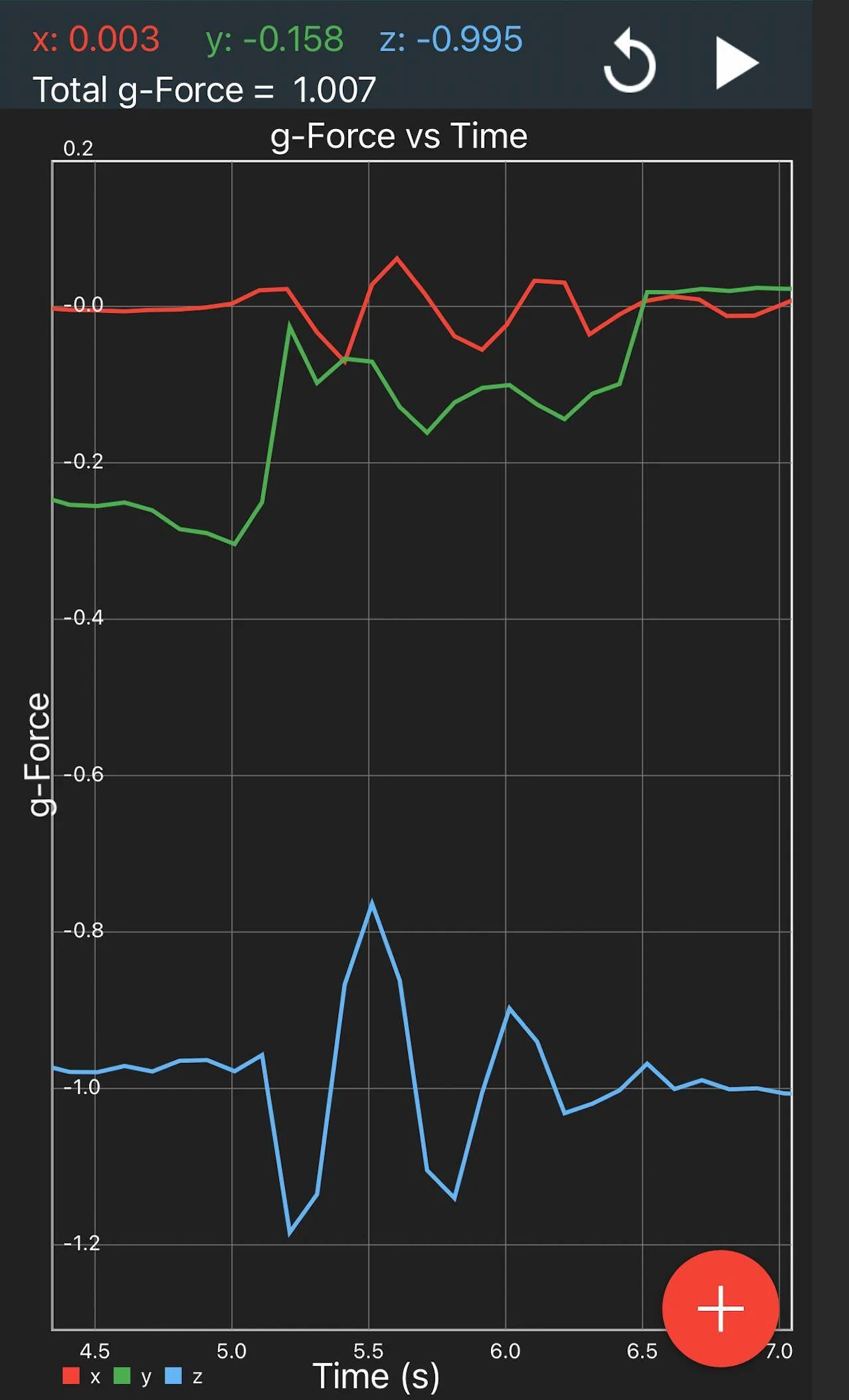

Line graph vs plotted. But also need to NOT record the Total. If you can remove Total from the graph that'll help. I have some data as well but so far no nice way to show it other than taking a screen shot of it. Te CSV to graph things I've found don't give me anything 'nice' like this graph.
QA1's at 5 click
Ford Mustang Mach-E UPDATED: Replacing Rear Shocks: Reducing the rear end bounce. Screenshot 2023-03-13 at 10.07.47 AM
Blue being vertical bounce (note there is a dip down and then up onto my driveway.
Green being phone angle (this was me just bouncing up the driveway with the rear tires so the angle of the car is green, fairly useless when level)
Red being side to side wobble.
This was literally me bouncing the curb to measure the # of cycles it takes for the back end to stop bouncing. The modified Mach-Lee trunk bounce.

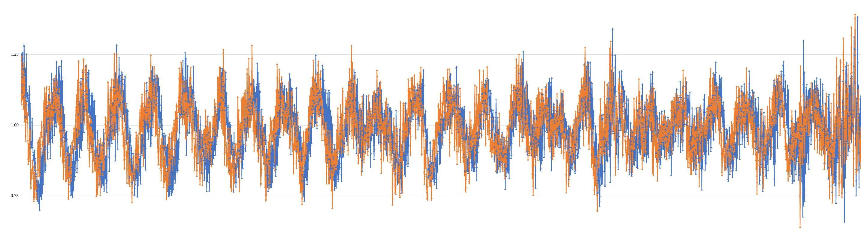

Here is #10 as a line graph:
Ford Mustang Mach-E UPDATED: Replacing Rear Shocks: Reducing the rear end bounce. 1678727811407
This isn't total g-force either, this is the g-force in the Z (up/down) direction - gFz. You see a slight offset between the peaks and valley, but I left it like that so that we could compare the 2 data sets better visually.

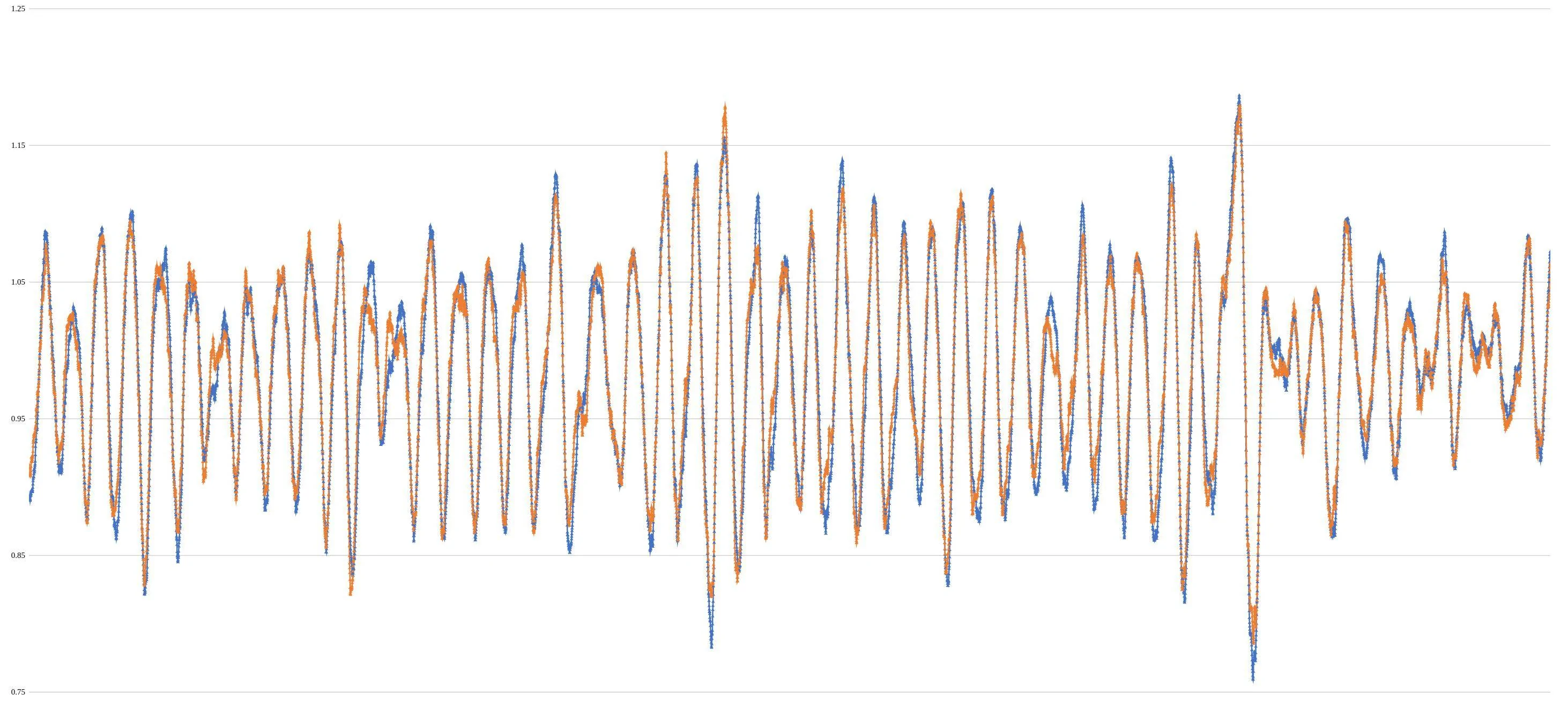

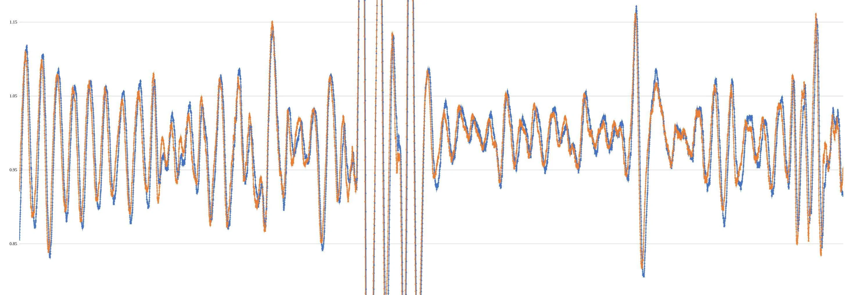

Thanks, this does help. You can start to see some difference with a simple moving average. Here's a SMA on 50 data points (~0.115s).
oem-v-koni-s-10k-20k-50sma:
Ford Mustang Mach-E UPDATED: Replacing Rear Shocks: Reducing the rear end bounce. 1678732376462
oem-v-koni-n-10k-20k-50sma:
Ford Mustang Mach-E UPDATED: Replacing Rear Shocks: Reducing the rear end bounce. 1678732710251
Blue is oem, orange is koni. You can see that the oems go further than the konis by about 0.01g, sometimes even 0.02g.
Glad it helped, but I'm wondering if you're still losing the real story here when looking at such fine-grained data. If you average over a longer timeframe (say 0.1s) and look at several seconds of data, you may see a very different story. (I'm saying this in part because if you look at Erik's plot, it appears to be looking at 0.2 second time slices.)

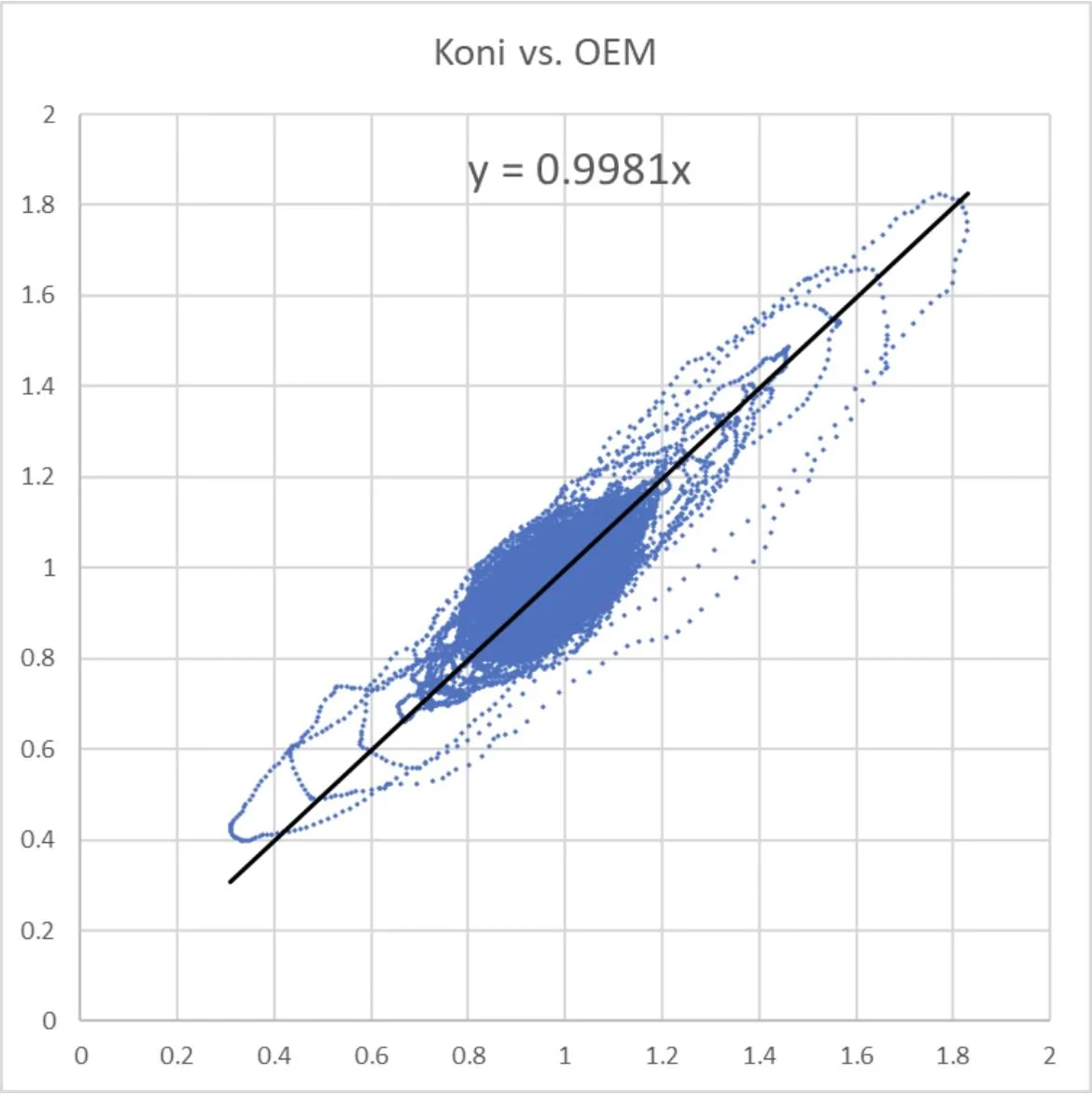

X-Y plot seems to work ok for analyzing the data.
EDIT: On second thought, the slope can change dramatically depending on the parameters, this maybe isn’t the best way. The data seems pretty darn similar just looking at it. I didn’t ride in the car to feel it, but it almost seems like placebo effect? Are we sure the data files are labeled correctly?
