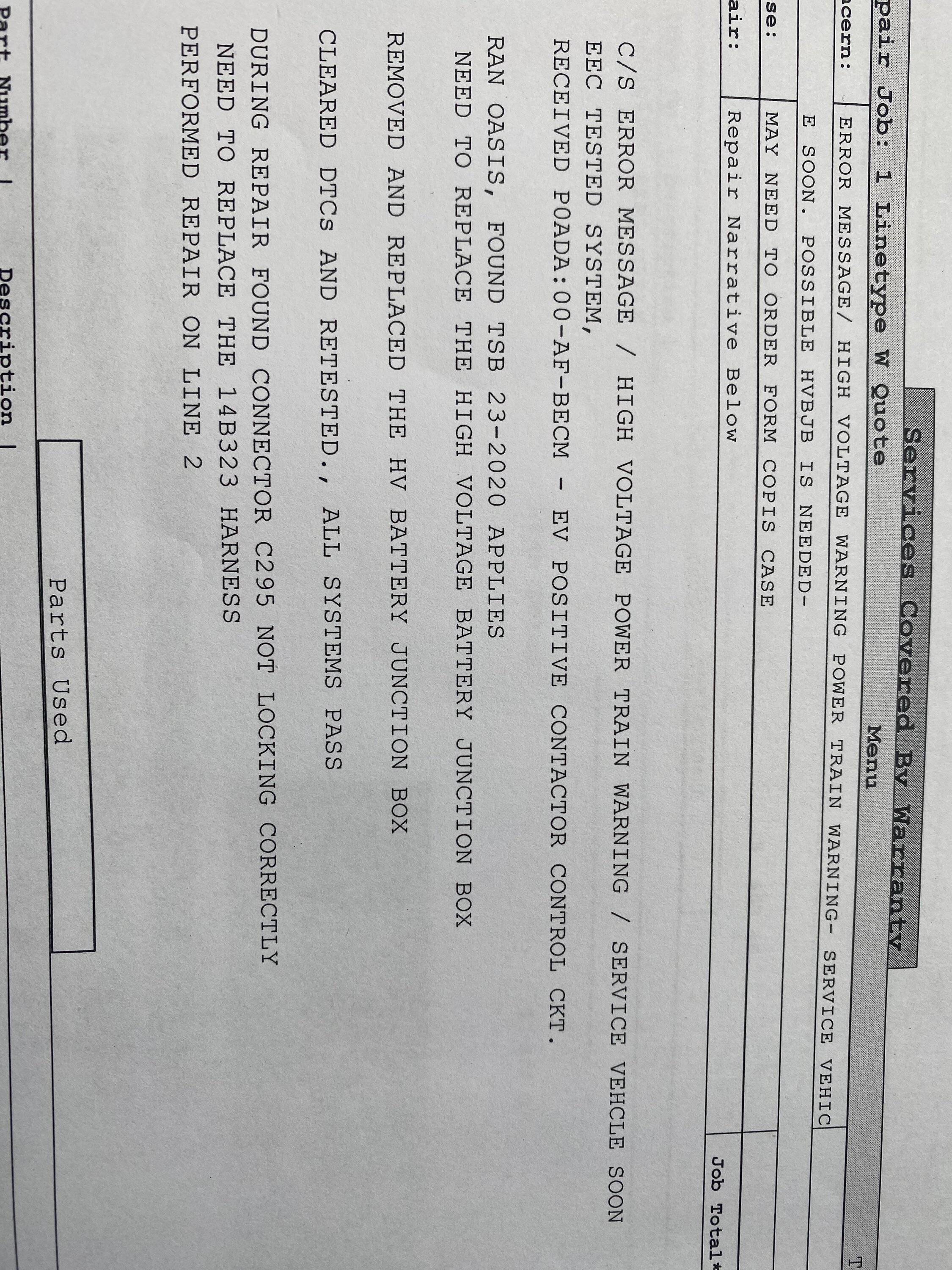

Got a welcome surprise today as my dealer was able to complete my HVBJB repair and they got the clip/harness part too! Only 3 weeks, most of that time waiting on the harness/clip part.
