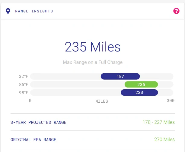

Charge to what you need. Unless you are the type to keep a car for 10+ years just drive it.
On long trips sometimes I need to charge to 100%. Do what you have to do, don't worry about it and have fun. What's not recommended is to leave it too high or too low for extended periods of time.
And yes, usable range isn't the same as ICE. The main reason is that there's not a charging station every .05 miles like there's a gas station. So, when you charge, the vehicle charges fastest to 80%. That's the optimal spot to stop if you can, but just for pure time sake, not battery health. Then if there's a charge station 50 miles from empty you have to stop there because you would be out of juice before you get to the next.
Apps like Plugshare are helpful because they tell you what % to charge to so that you aren't spending extra time at a station. For example, if you only need 100 miles to the next charger and the one beyond that is 200 miles, then you need only 100 miles. Lets say you want to have dinner at the current stop, well then let it charge longer and at the 100 mile one you'll need less time to get the 200 miles needed for the next. It's definitely wise to plan accordingly and have backup chargers in case one doesn't work.
Lastly, make sure you take things like wind and temp into consideration. If you have a headwind add 25 miles per 100 otherwise you'll be sorry.
Ultimately, 270 miles (my cars estimated range) is never going to happen for me. My stats show that 235 is all I'll likely see and given stations are only every so often, I'm getting closer to 180 per stop.
Ford Mustang Mach-E Usable range 1653872961235
There's a ton of posts on this forum about this.

What app is that screen shot from?
