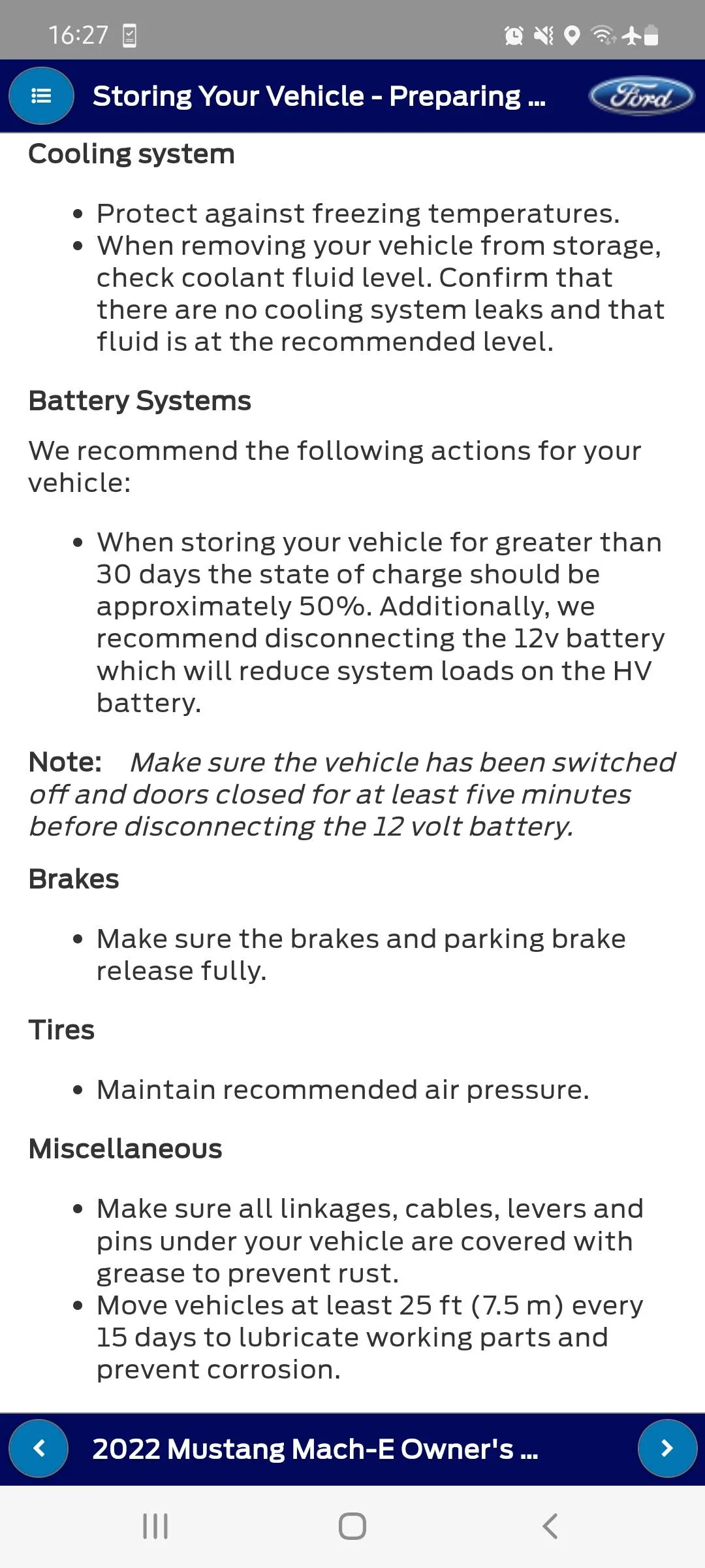

I plan on being out of the country for 4 1/2 months, traveling in Europe. Will the HVB keep the 12V from dying for that length of time? I'd prefer not to return to a dead 12V. Any other suggestions that would be beneficial?
It should, but Ford recommends disconnecting the 12V battery for extended storage.

But why specifically leave the vehicle plugged in for a multi-week vacation? That's not Ford's recommendation.
High-voltage battery will keep the low-voltage battery topped off.
No one is losing 50% battery charge per month from the vehicle just sitting there, might not even be a tenth of that.
