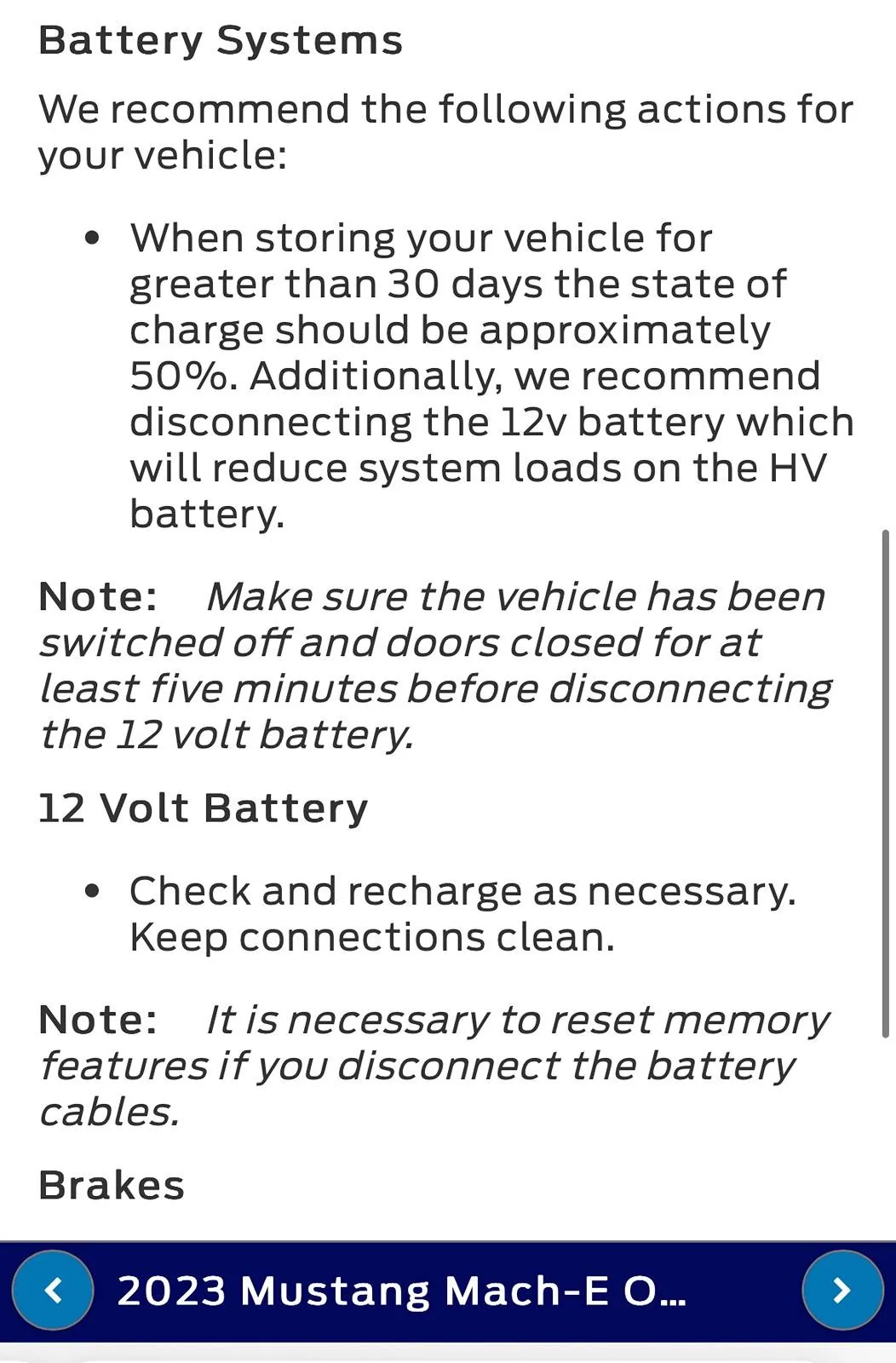

Ford agrees you should start thinking about it after 30 days.
Ford Mustang Mach-E Vehicle Power Down Timer IMG_4721
I’m aware of that. But it seems that a lot of people are expending a bunch of unnecessary effort to keep the 12V battery charged. The OP never did answer the question “What does ‘not driving much’ mean?”
