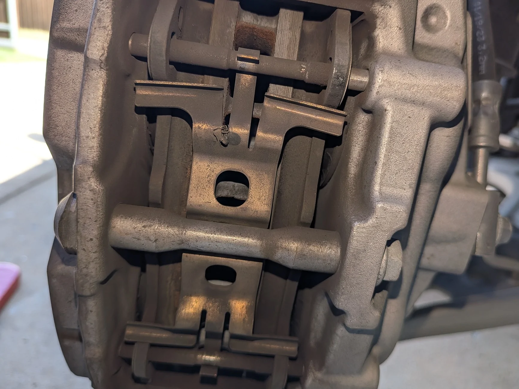

I've had 3 Mach-Es, no warping issues over 105,000 miles. Here's how thick the pads are after 40k:
Ford Mustang Mach-E Warped rotors AGAIN!?!?! PXL_20260507_161230539
