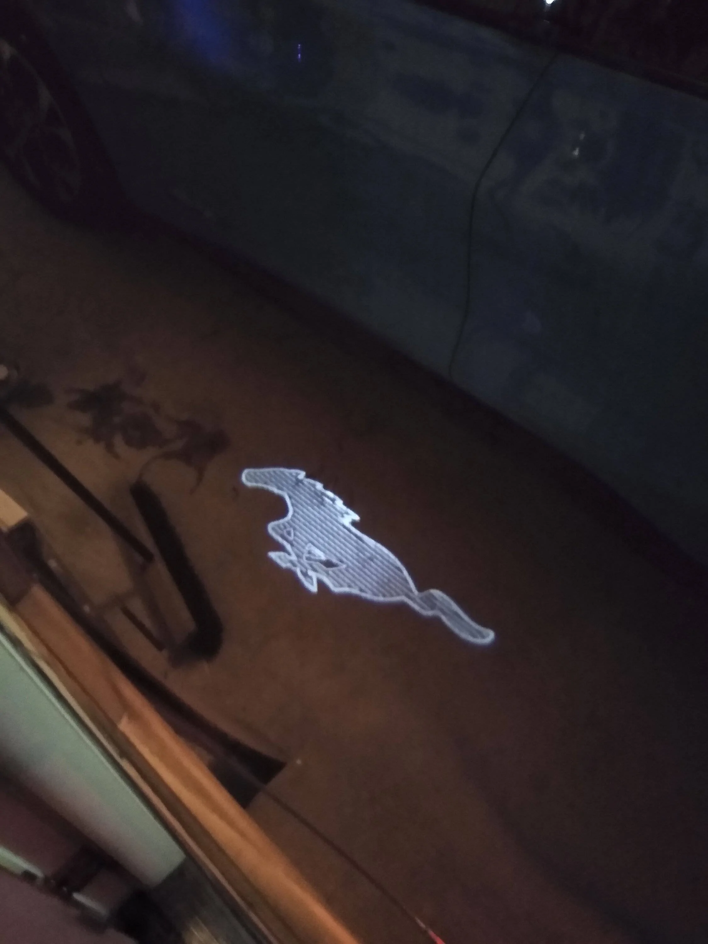

Surprise Surprise! after two months of ownership never did see the Puddle Pony but now that I have PAAK setup on my phone, she shows up in the garage!
Ford Mustang Mach-E We have a working Frunk Button in FordPass! Puddle Pony
