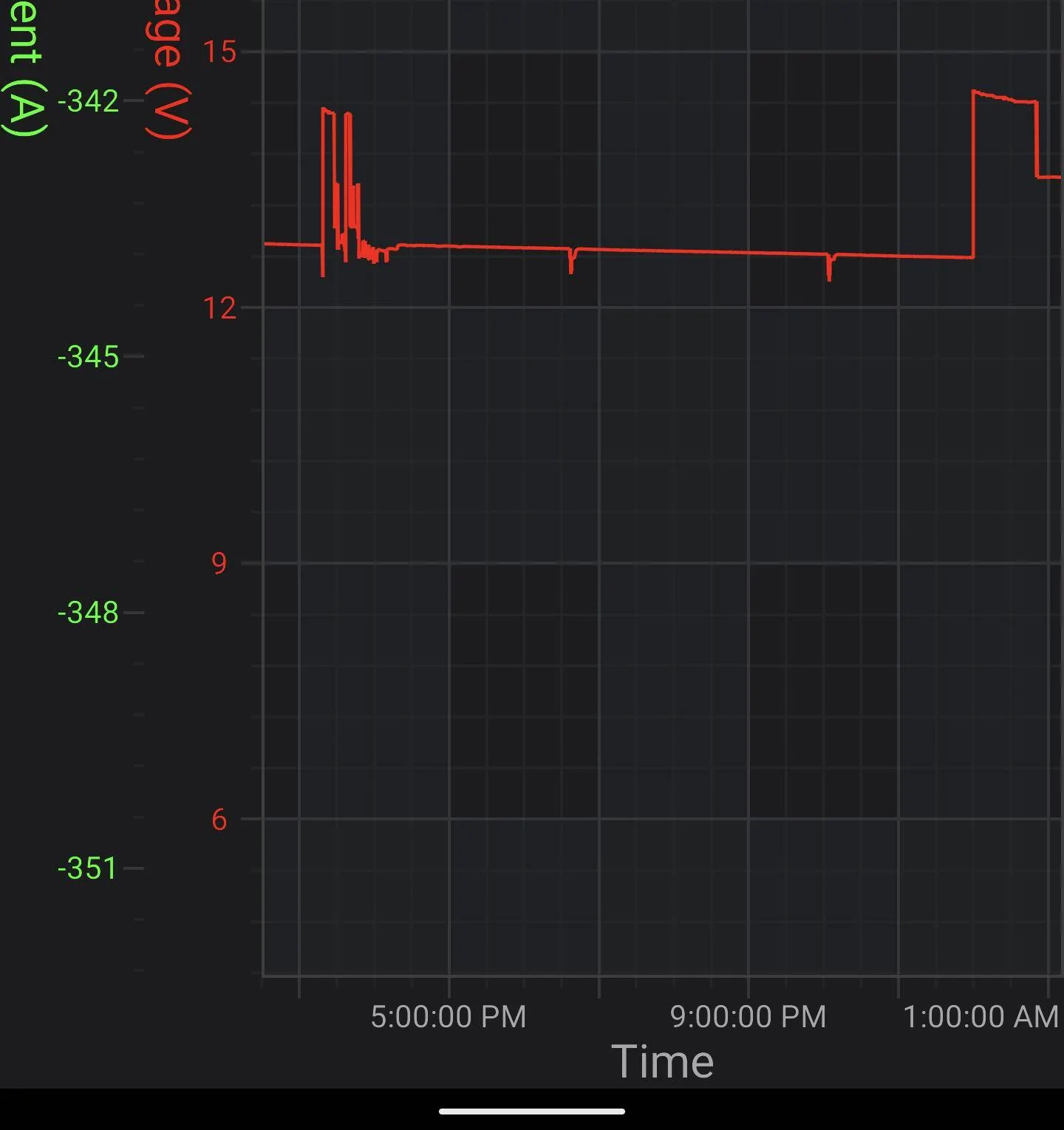

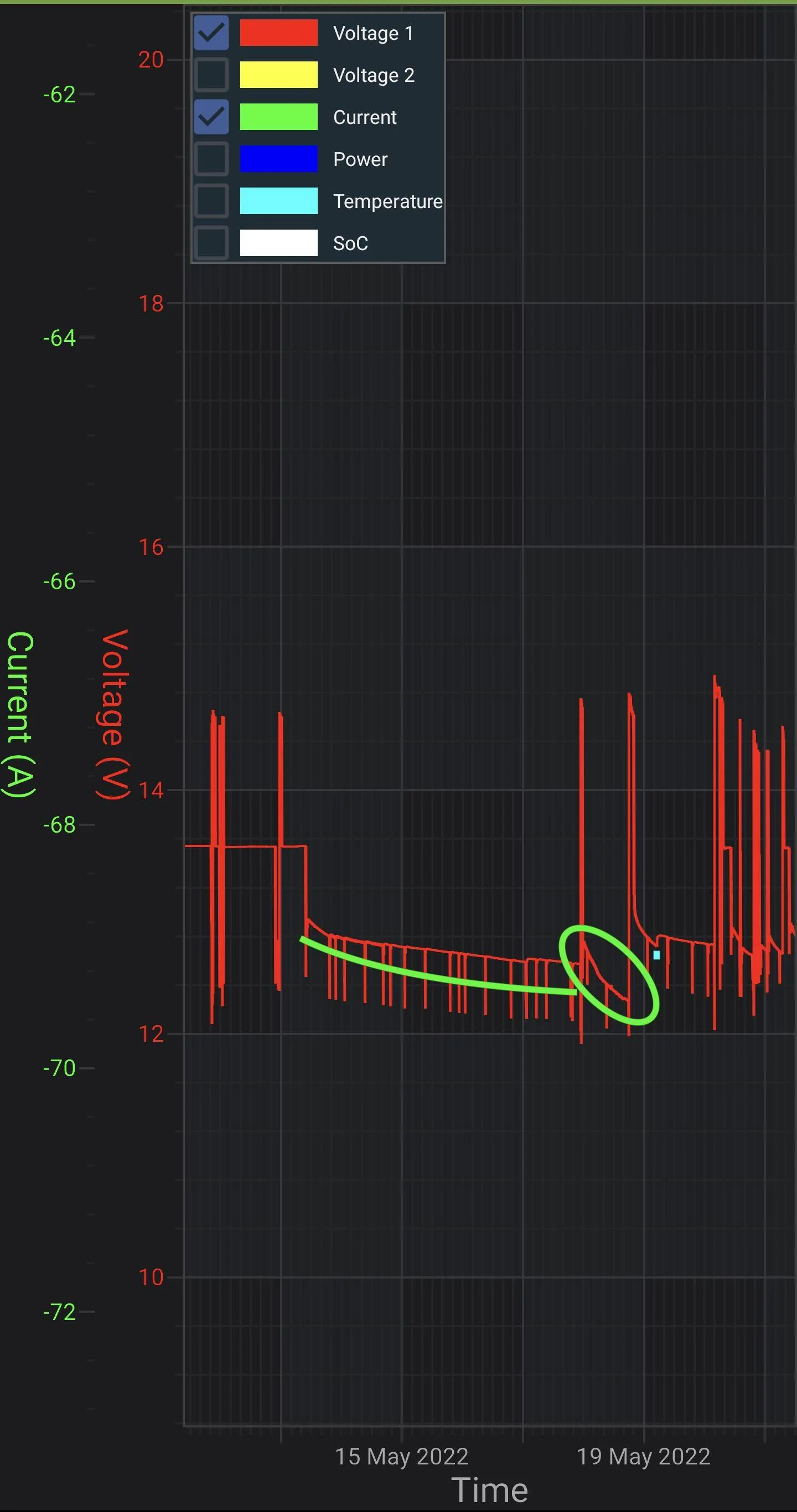

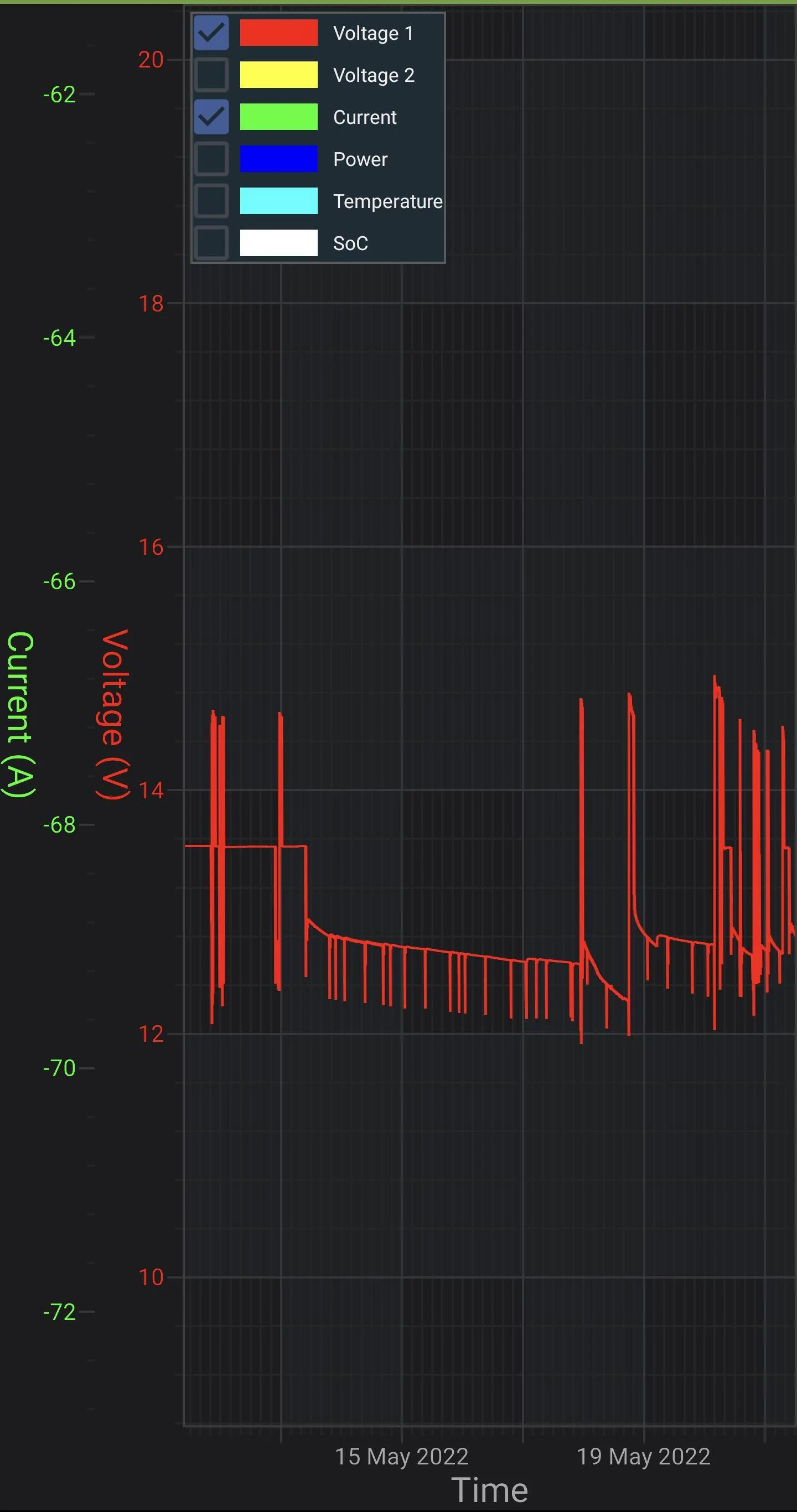

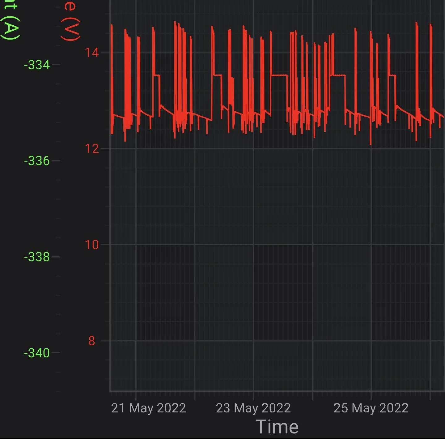

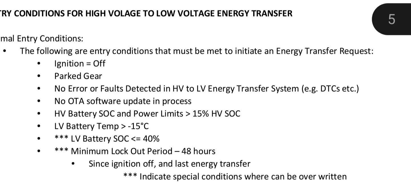

You sure about that? I am probably the only person who has a constant 12v monitor on my LVB with data going back over 6 months. 12.3v/12.2v is the lowest I can go (sustained, low load) before the car kicks in the DC/DC to top up the LVB. By my limited battery knowledge that would be 50-60% SOC.The trigger threshold for an immediate recharge is 30% SoC
Is that documented? Not doubting you, just never seen that before.The 12V will also stop automatically recharging when itās less than 5ĀŗF
