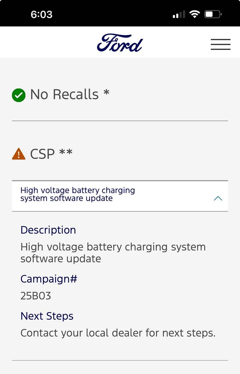

Anyone had this update completed yet? This will be the first time our '24 has been in for anything. Our appointment is on March 7th.
i just got it done this morning. took them about 2.5 hours but i'm sure most of that time was spent waiting for the tech to free up.

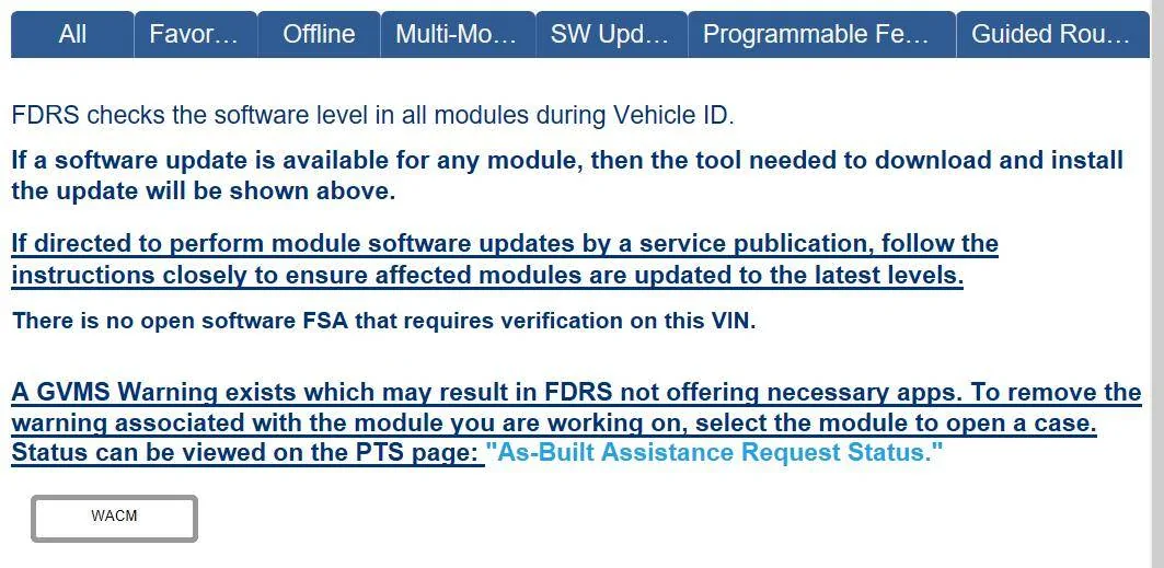

Is there way to know if the updated was applied?
astrorob
rob
Aug 26, 2022
873
388
bay area
24GT, plug-in prius, 99 MBZ C43
i assume the only way to get the various module software versions is to ask FDRS. there is a thread here where people post their VIN numbers and various forum members that have an FDRS account check the VIN and dump out whatever info is available there. but i'm not sure if the online FDRS is the same as hooking up to the car directly with FDRS, or if it can provide all the same information.
you can also buy a 2-day FDRS license for $50 if you want to do it yourself.
the documentation my dealer gave me states that t 25B03 was applied and the SOBDM software was updated per the 25B03 technical info. unless they lied i don't have any reason to doubt this.
