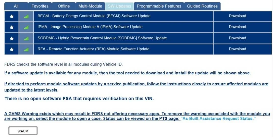

This is what shows up in FDRS for my 2024 Mach e. I wonder if I'll have to submit a request to do the update?
No, I think it will show up when it shows up. Same screen I have.
EDIT: As Lee said below, I already did this update in December myself and that is why it is not showing up for me even though Ford shows a CSP for my car. Only way it will drop off is if the dealer clears it. At least I have the update.

Anyone mind pulling my VIN and seeing if the update is available? I’m dropping it off at the dealer on Monday now. Thanks in advance!!
3FMTK3SU4RMA45960
3FMTK3SU4RMA45960
It does not show the SOBDM for this CSP but possibly the SOBDMC is similar? Lee would know this and might chime in.
The reason it does not show up on my car is because I have already done the update and only a dealer can clear the CSP on a VIN.

Yes the update is available for your car.
Roger that, thank you. Lucky you, my car will now be in the hands of the dealer!

I edited my reply to you. Waiting for Lee to check to see if the SOBDMC will satisfy the CSP or not. I don't see where you had any powertrain updates so this CSP has not been done yet on your car.

@cbcasas That's odd, but it looks like that vehicle already has the updated PJ98-14F476-AV SOBDM software from the factory (it was released for shipment right before the cutoff date). Still flagged for the CSP despite this. So you're probably good, but you may want the dealer to take a look at that and get those other powertrain modules updated as well.
When referring to Powertrain modules, is it just the BECM? Thanks for the insight, I look forward to letting them know (and them probably sneering at me)
Sorry, I probably should have mentioned which modules. The other two powertrain updates you have available are the BECM and SOBDMC. RFA is PAAK and IPMA is BlueCruise.
