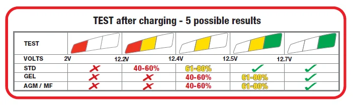

You sure about that? I am probably the only person who has a constant 12v monitor on my LVB with data going back over 6 months. 12.3v/12.2v is the lowest I can go (sustained, low load) before the car kicks in the DC/DC to top up the LVB. By my limited battery knowledge that would be 50-60% SOC.
Is that documented? Not doubting you, just never seen that before.
Maybe a std battery you are remembering? I would like to see the agm never be below 12.5V but it is and is a lot. Too low soc for cold climates imho. Wonder if you left it in -30C for a couple of days at 20% soc (12.2V) if it would freeze up solid enough to make the 12V casing bulge out? May be hard to close contacts at that stage even if just slushy.
