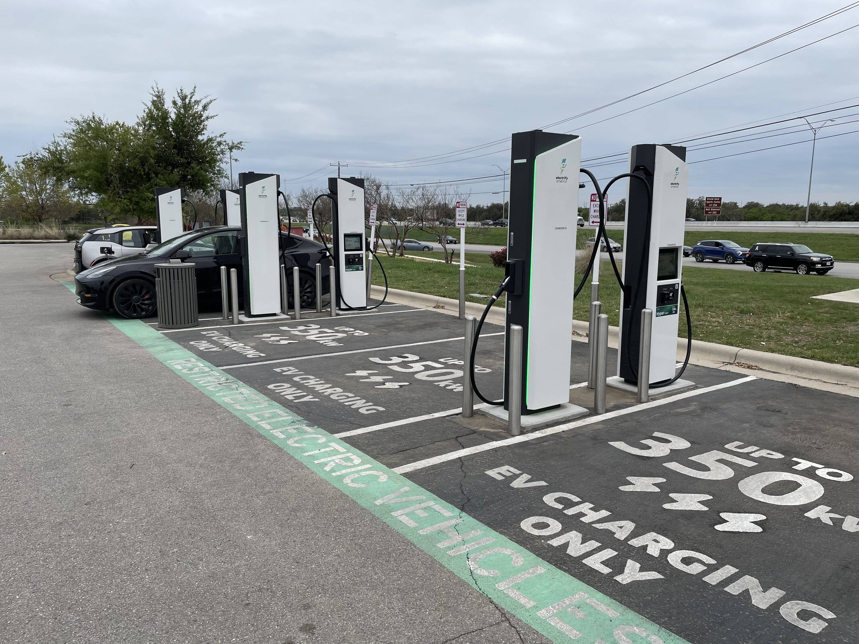

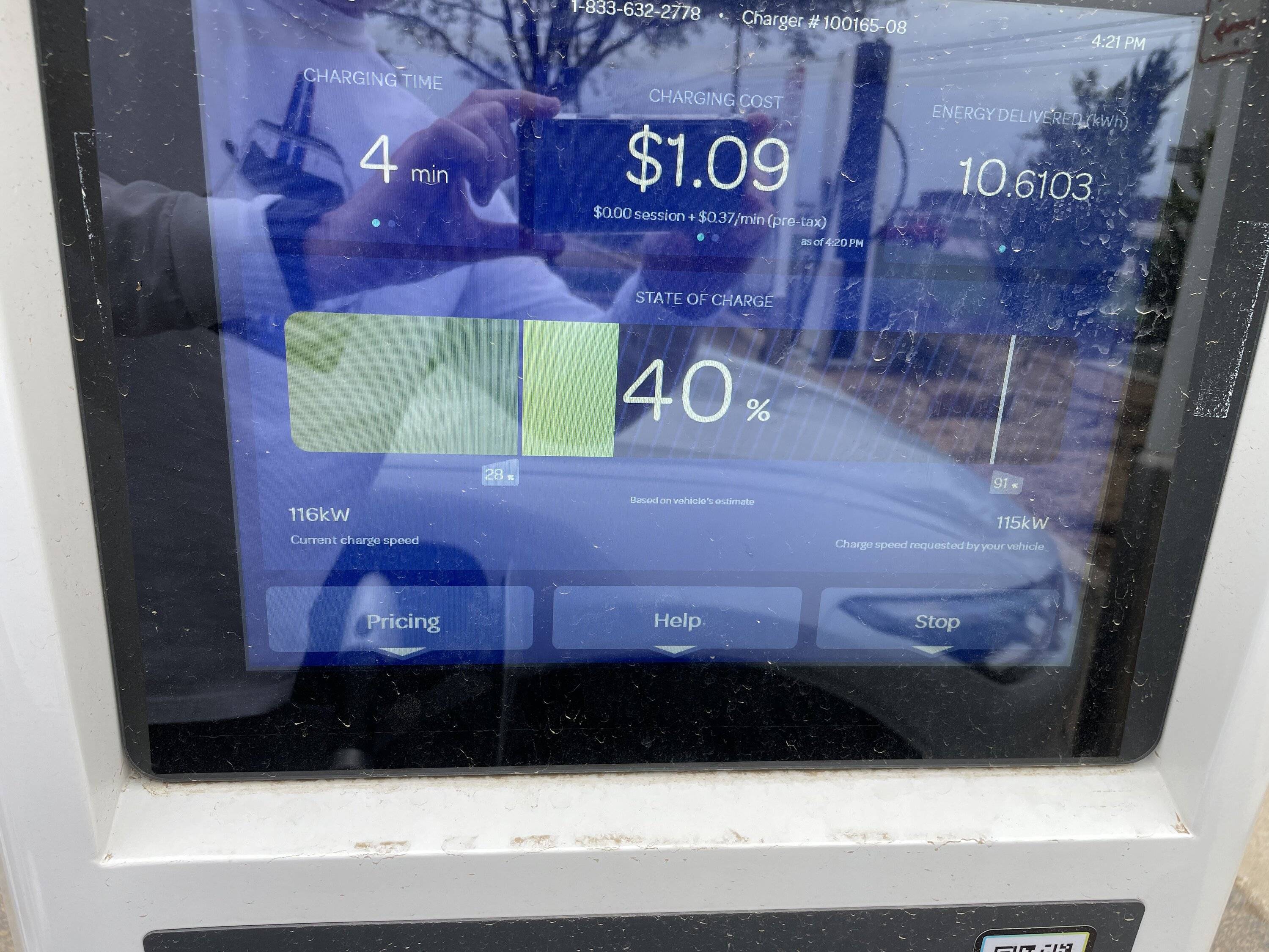

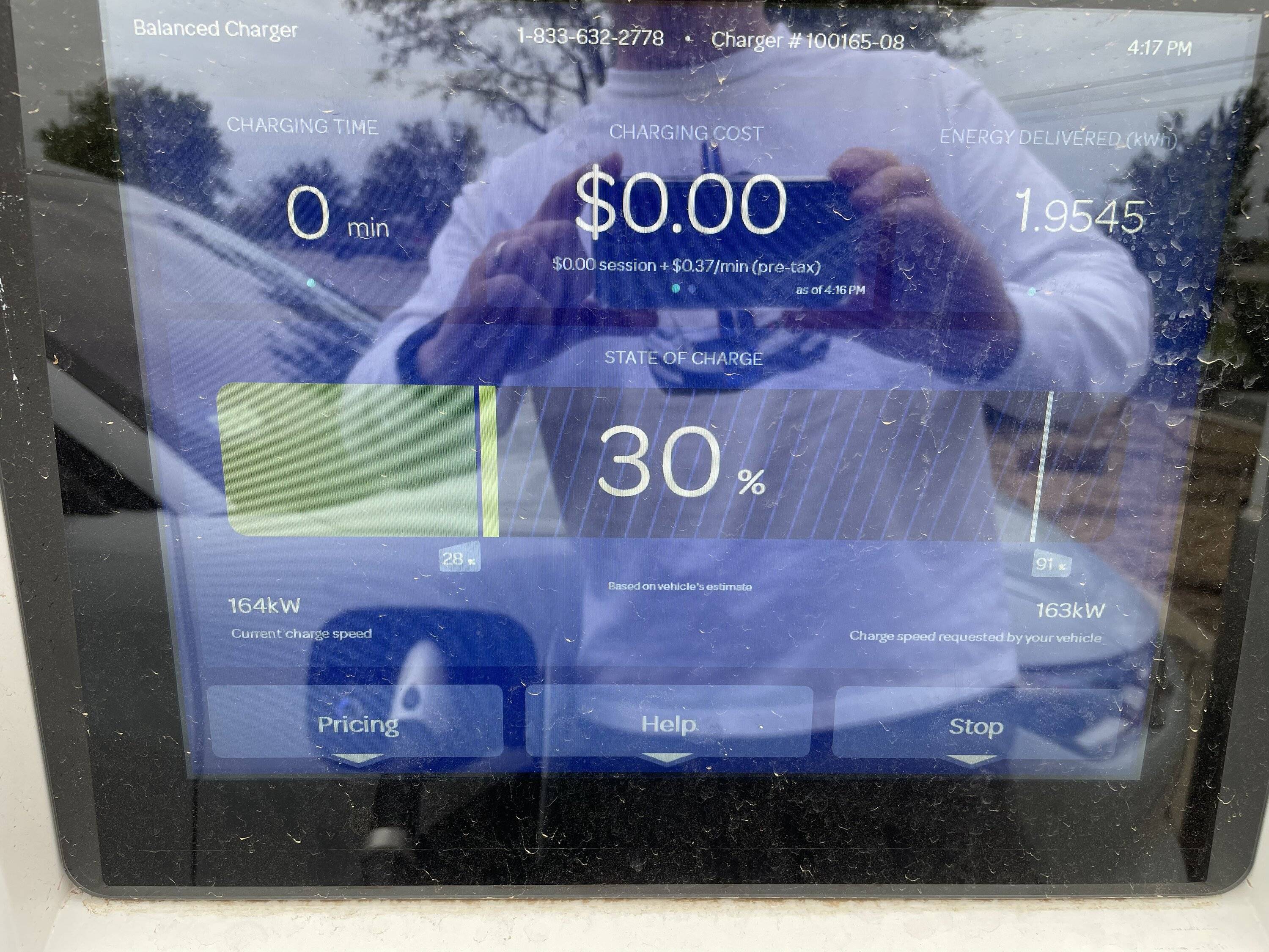

Well, yesterday I took my wife’s 4X to our recently upgraded EA station (all 350kw) just to see if it was any better than the old 150s. Starting SOC was 28% and temp was 60F. I stopped at 50% after 9 minutes.

Plus, there was this one fool that didn’t belong ?
That 164kw is juicy, dropping to about 110kw.
Did you precondition?

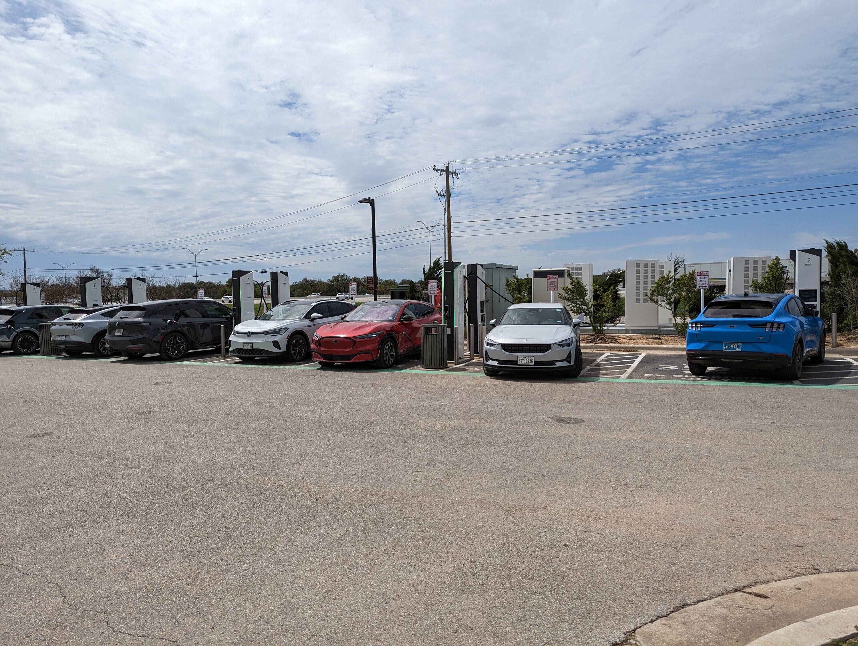

That looks familiar. I was there on Friday on my way home to AZ.

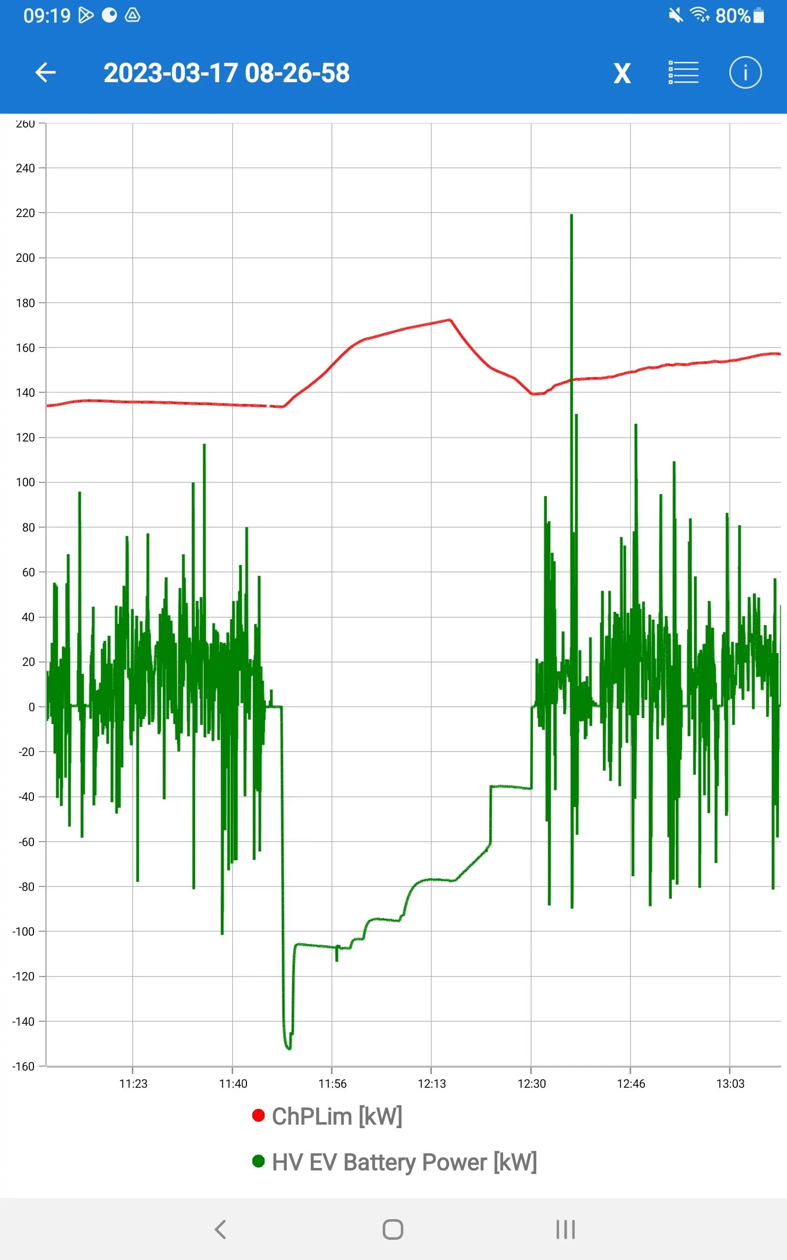

Ford Mustang Mach-E What kw fast charging should I expect? PXL_20230317_184852581
I got around 152 kW peak. But the peak is so short-lived that it's really not the key to fast charging.
