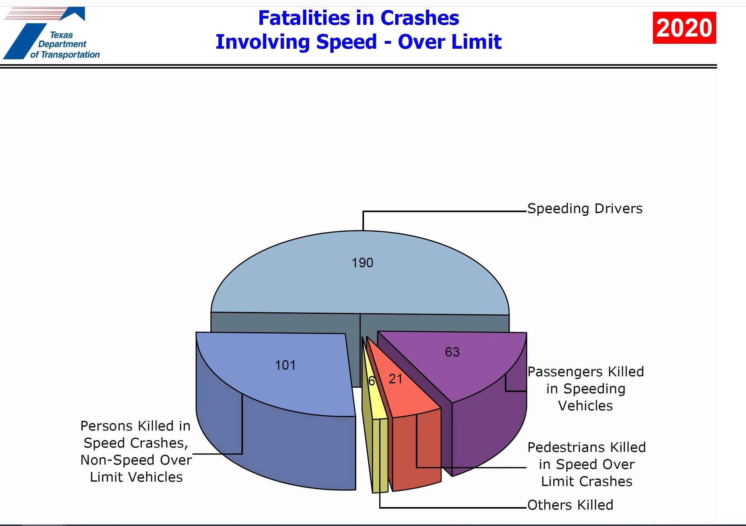

Or anyone who wants to take the car to a track or drag strip (like myself).
The point of the article was just using facts in light of your “there is a reason for speed limits” comment.
Unless I assumed incorrectly that you were referring to some sort of safety aspect? Data proves otherwise.
Of course it is a safety aspect. Although speed itself is not the crucial factor here.... the humans are......
