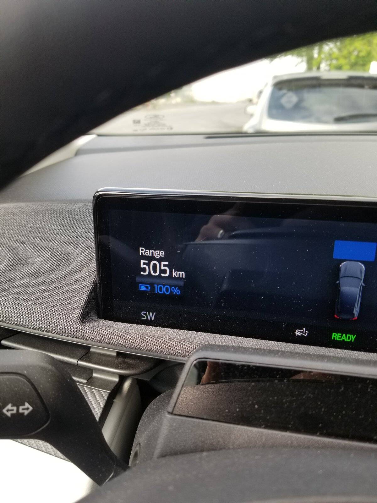

With my juicebox pro 48amp I get 10%/hour recharge which equates to roughly 9kw/hour. Also I charged to 100% for the first time yesterday and got this
Ford Mustang Mach-E Why so slow on Level 2? 20210604_085313
But after calculating with my 15% left, I was closer to 450km or 280miles with a Prem 4x Ext. All kms highway driven.
Needs time to learn you? Run it a bit to see if it syncs in. If not there is a reset driving history and try again. I am also mostly highway (all) and it has set in at around 420 Km 265 mi and is speed dependent. Enough during good temps to get to the next charger and then some.

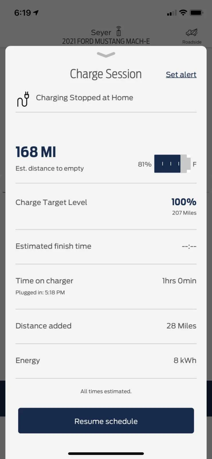

I getting 28 miles per 1hr on my 40amp I guessing with 48amp you will get around 36.
I'm going to let the law of averages figure it out but it would be cool if I can somehow get it that high
