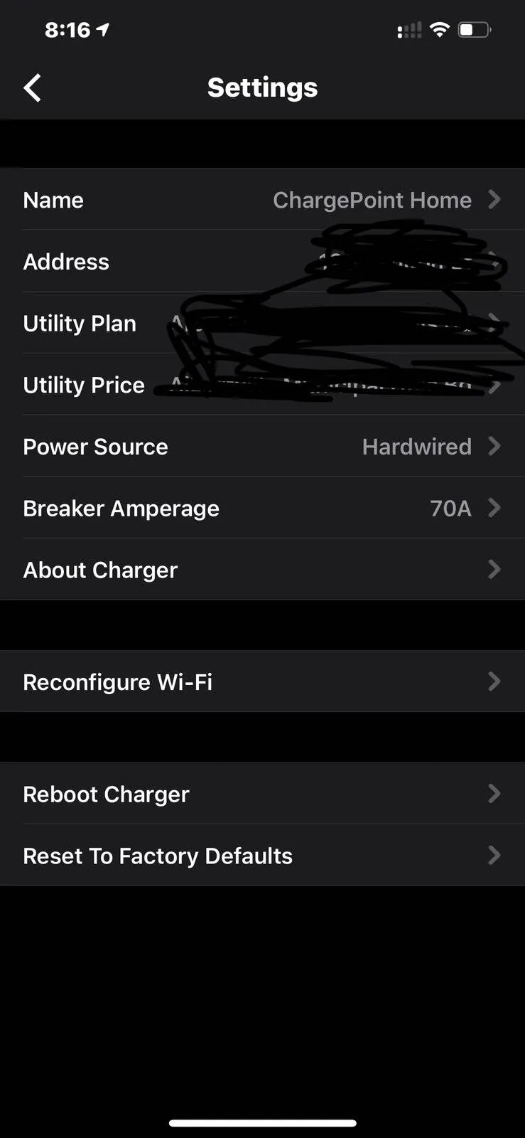

Can anyone guesstimate the % of charge will take charging at 48 amps? from 25% charge to 80%?
This is where I plan to charge every time(or at least not on trips).
appreciate the info. Is there a chart posted anywhere on this subject?

From the spec sheet my charger does 40A @ 9.6 KW. Also I do have a bigger breaker and wires. I had a 50A installed when I got it.
Keep in mind that there is a derating factor of .8. That is why a 50 amp circuit supports a 40 amp charger. A 60 amp circuit can support a 48 amp charger, but that needs to be hardwired and not a NEMA plug.
