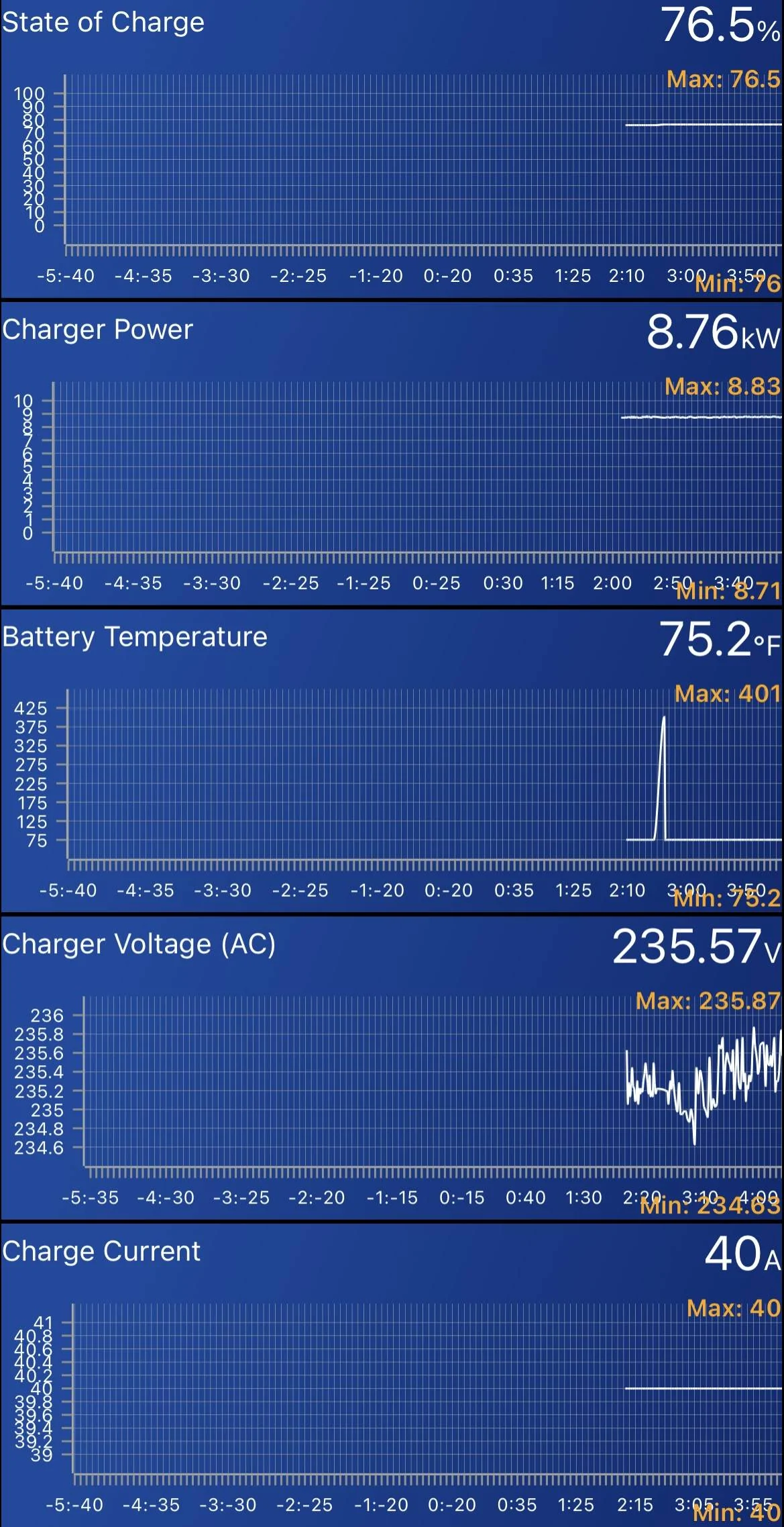

I'd forgotten about the loss, thanks. And FordPass just dropping the fractional part is something I never knew, but it's ridiculously bad. 8 versus 8.6 is 7% lower. It makes me wonder if the charging loss isn't greater than 10%.
This is a what my Grizzl-E setup typically performs at, around 7% loss (~9.4 at EVSE, ~8.8 at battery) and FordPass truncates the rate as a round “8 kw.”

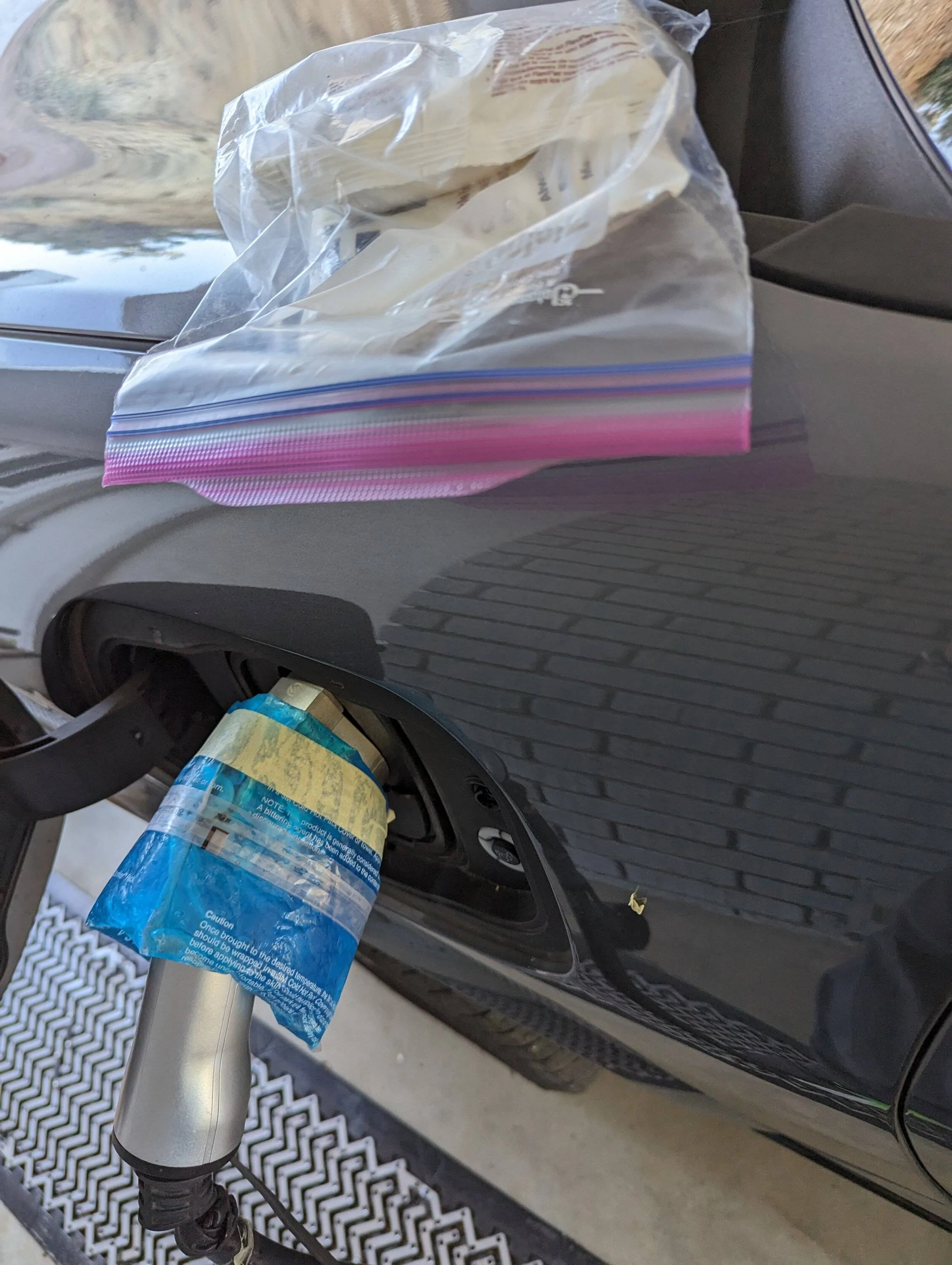

Getting back to the slow charging on L2...
This thread discusses the OTA software patch that limits charge based on charge port temperature...
https://www.macheforum.com/site/thr...rge-port-dtc-p0e5f-stored-in-the-sobdm.29967/
... to diminish the amount of charge port replacements Ford would have to do.
I remember seeing a post on another thread here from someone who aimed a room fan at his charge port so he could charge at 8kw as opposed to 6kw, and chuckling at his photo.
I laughed too soon.
Last night, I plugged in late on my 40A charger and saw that at 8kw, I'd be ready to roll at 6:45am according to Ford Pass. About 1/2hr later, I checked again and saw my rate down to 6kw and a ready time of 9:15ish.
I had to be at work an hour before that.
I don't have a room fan, so here's my ridiculous photo of the workaround -- blue ice wrapped around the charger hosel, to diminish temperature as much as possible to allow 8kw flow for maximum charge on a time-critical departure.
