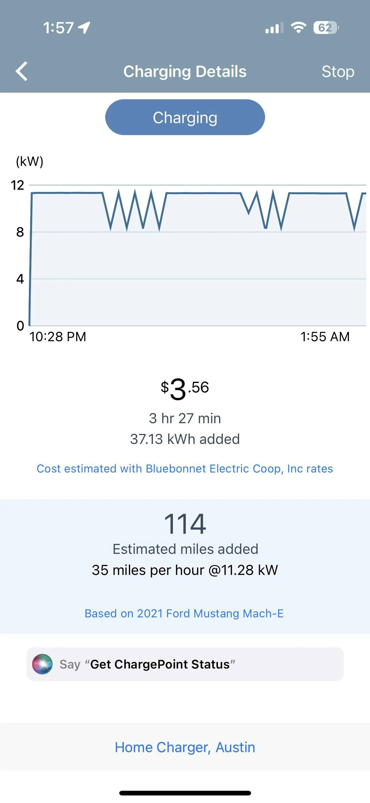

This seems like the right thread to post my issue, and maybe a couple of the earlier comments have alluded to this same issue. I have a CP Home Flex, software version 5.5.2.15, installed on a 60A breaker. I’ve been getting fluctuating charging speeds/power every time I plug in for the past several weeks. (See representative graph below.) I’ve tried flipping the breaker and other suggested fixes to no avail. Is this problem going to be addressed in the software update ChargePoint is supposedly working on? I’ve been concerned this might be an MME issue rather than a CP issue. I’ve already put 33K+ miles on the car and I’m quickly approaching the end of my B2B warranty. Also, is there any connection between this issue and the HVBJB problem, and would a failure there be covered by the powertrain warranty if it happens after 36K miles? Thanks for any help you all can offer.
It’s not a ChargePoint issue. It’s a Ford issue:
https://www.macheforum.com/site/threads/l2-charging-speed-recently-dropped-33.28779/

Ah! Thank you. I guess I just didn’t search long enough to find the right thread. Nice to know I’m not alone.
Also that issue is probably covered under the 8yr/100k warranty.
