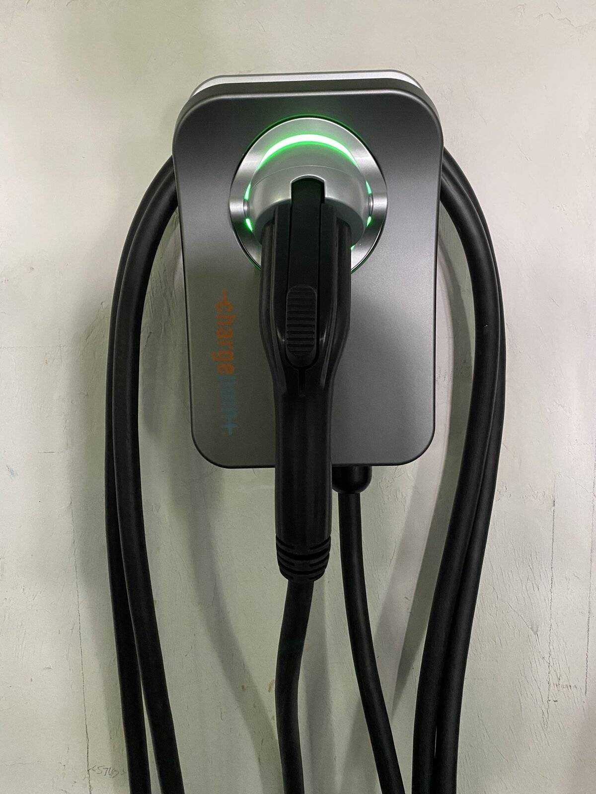

My ChargePoint Home Flex Installed

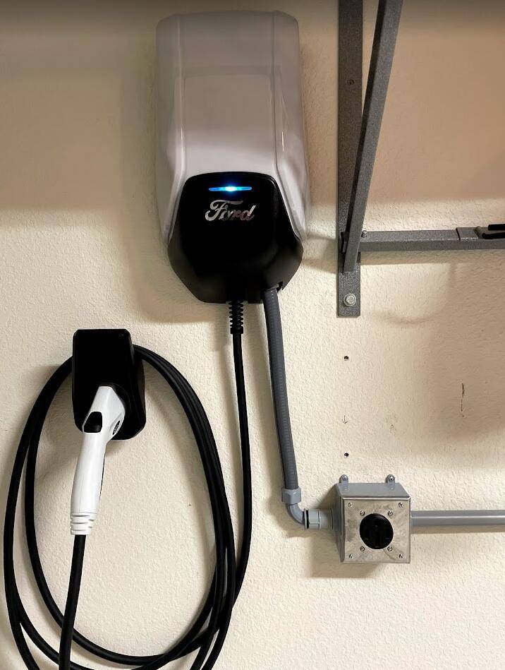

Looks good. I learned that pulling a bundle of 6AWG wires through 3/4" conduit is difficult, and a real PITA when you have to pull it through an elbow or conduit body!
As far as support for charging two EVs in the future, I though about that and added a NEMA 14-50 plug in-line with my charger that would support a 2nd EVSE, but I would have to setup different charge schedules for a 2nd vehicle or reduce the Amps for each to avoid tripping the 60A breaker. I also thought this plug would be useful in case the FCCS had an issue and I needed to use the mobile charger temporarily.

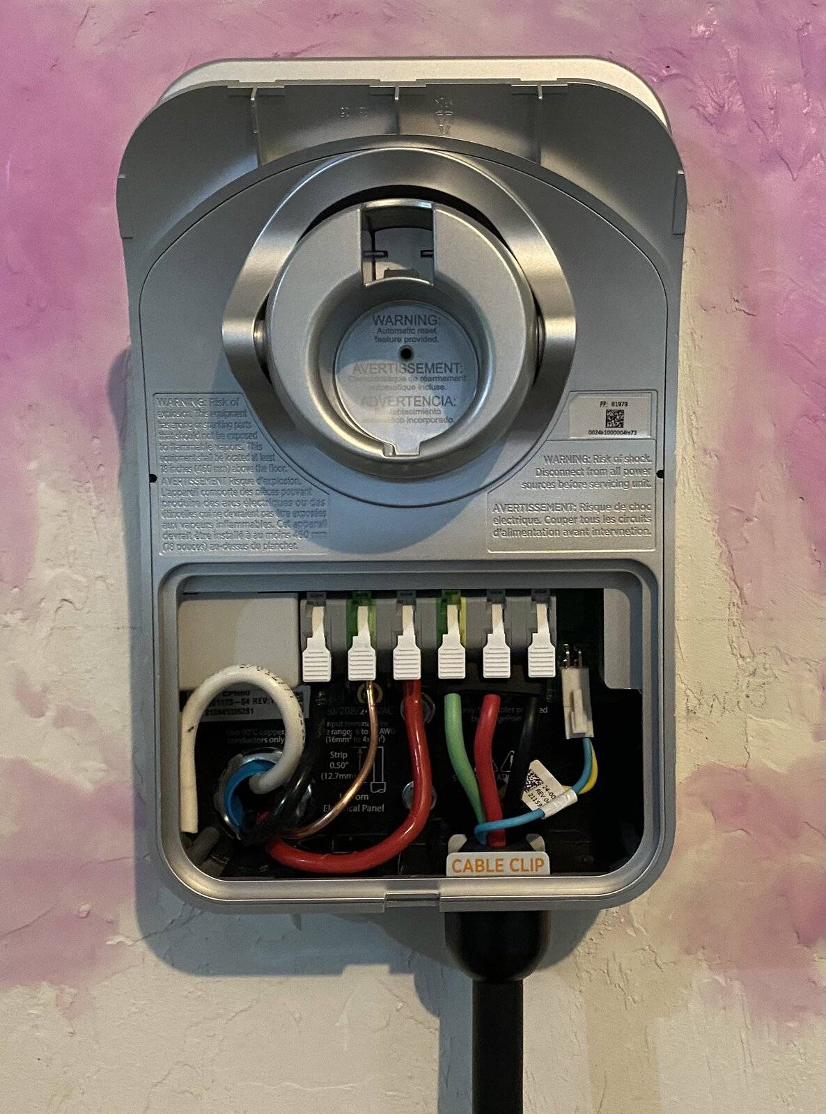

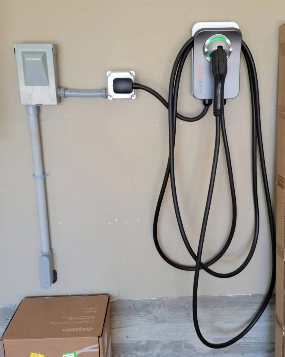

My MME isn’t due until 11/21-27, but my ChargePoint is ready to go. It’s hardwired with 6AWG THHN in conduit through the wall into the back of the unit for a clean install.
Full disclosure, I cut out a big piece of sheet rock to do the install, and patched it when finished (the pink spackle in the second photo turned white when dry). I included a white wire that’s unused in case I ever need to convert the circuit to a 14/50 outlet.
Interestingly, the THHN is rated to 90°c, however I had my install checked by an electrician, who said that the temperature rating of the breaker itself is typically lower than that and supersedes that of the wire.

Now that’s a nice install. Wish I had the option to come through the wall like that. Very clean!
Thanks! It was certainly more time consuming from start to finish, but with the wait for the car so long, I had plenty of time!
