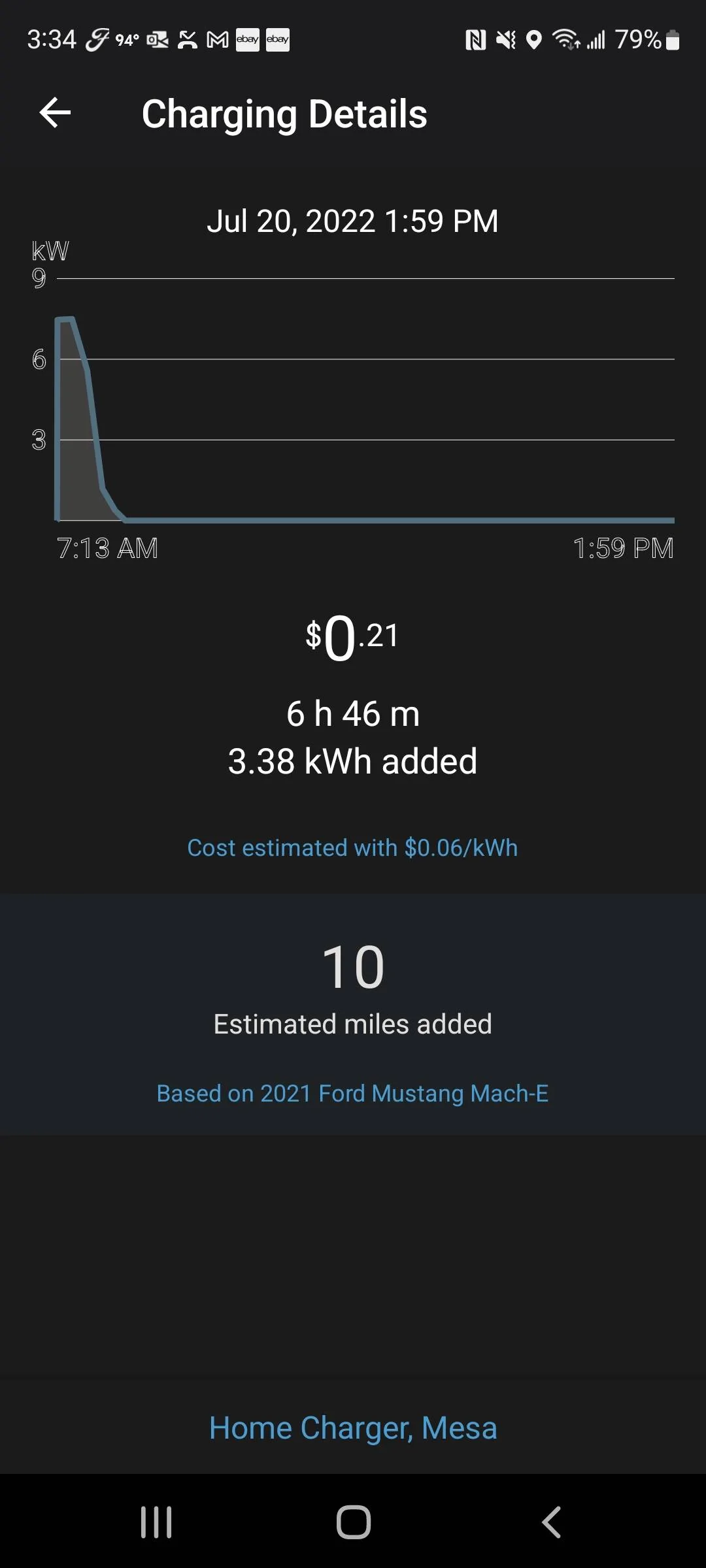

Not sure if it has been discussed in this thread or others... There is currently not an option to select a 2022 MME. Only option is 2021. I contacted them about a month ago and they created a ticket to add the 2022 model year. The extra 3kwh might not make much of a difference in my situation because I have the MME set its charge level to 85% rather than the CP setting charge level.
