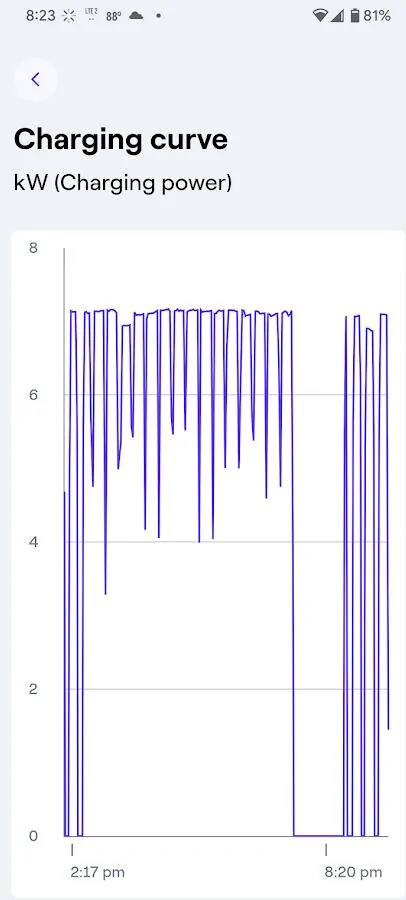

I wouldn't recommend Enel X's JuiceBox. Taking the charger offline and using it as a dumb charger seems to be the best solution. I have the same charger and starting having the Pause problem last week. It may have been corrected now but I still get false notifications that "charging has resumed" even after my car has reached the charging limit I set. Below is the graph of my JuiceBox charging experience last week. I learned from others online that removing the charger's wifi access allowed my car to charge normally. I couldn't get straight answers from their customer service contact.
JuiceBox went to crap in 2023, when they redid the app and the portal, and broken many functions. They don't reliably charge, often requiring multiple unplugs and replugs. They broke load balancing, so now you blow your breaker.
Support is in Spain, but none of the support people know anything much, and their next tier of support (China?) is offline, so Support has to send them a request, and then they respond weeks later. Support gets back to you maybe 25% of the time.
Based on the load balancing danger, I filed a report with the NHTSA (I first filed with the Michigan Attorney General, who wrote to them twice, and got no response, then filed with the Consumer Product Safety Commission, but they said that it's an automotive product and outside their jurisdiction.)
Their issues are so big that Amazon had to suspend unverified product reviews because people were slamming the product. I can't recommend strongly enough to LOOK ELSEWHERE.
Thank you for the background information on JuiceBox. I was aware of the app update but not the rest of their story. Mine had been working fine until last week. I'm debating whether to replace it with a different system or just leave it offline, since I don't really need anything more than a dumb charger. My impression is that the hardware itself is OK but the company has inadequate software talent.
The local power company is offering the 50 amp ChargePoint system for $309 thru Oct 7. I almost pulled the trigger but this thread has me questioning that idea. The benefit of having an online system is the power company provides a stipend for allowing them to adjust my charge times based on grid demand.
