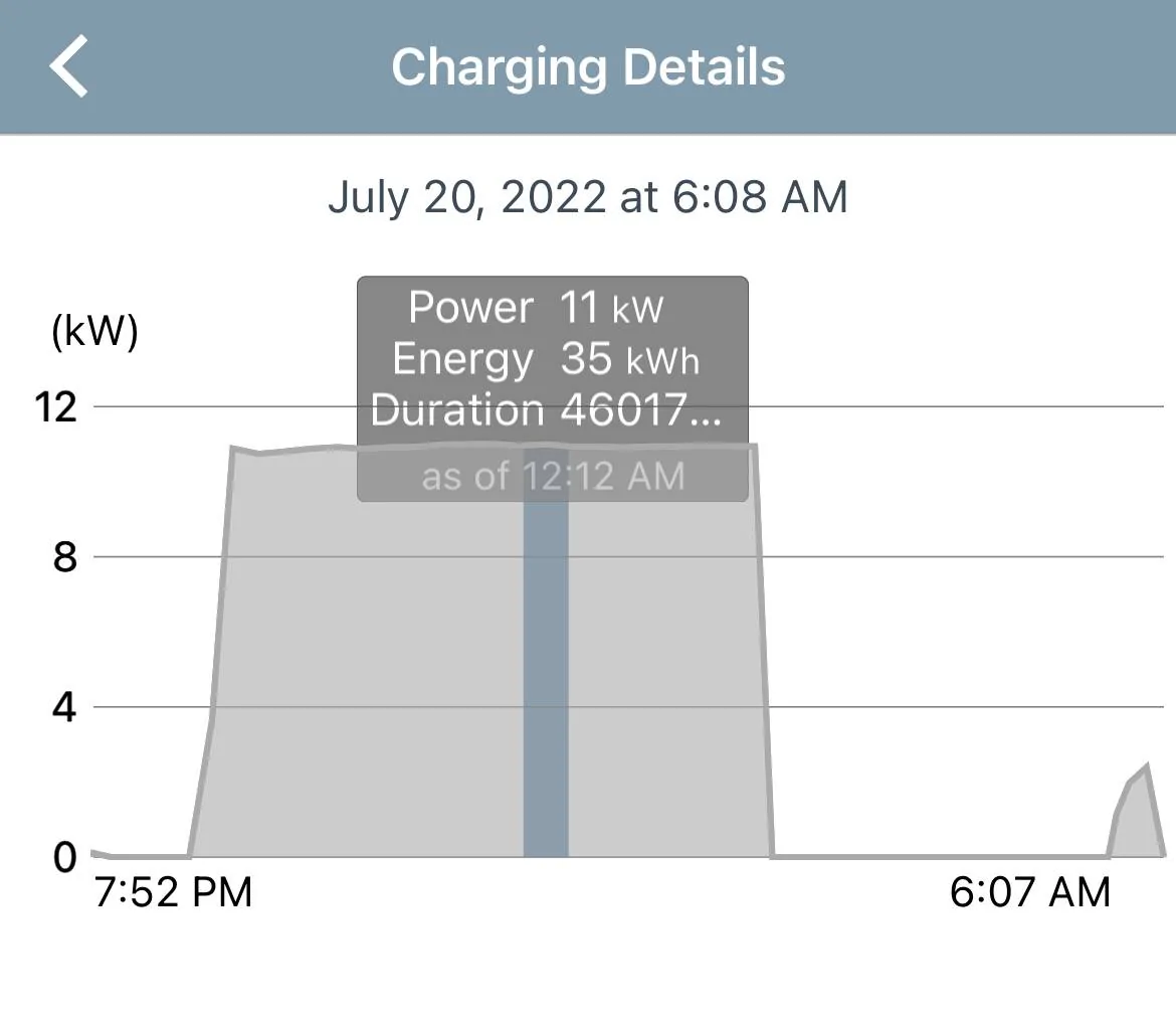

TheSleepyDad
Jan 18, 2022
51
120
SoCal
2021 GB GTPE
To see the charging speed in kw you have to check the ChargePoint app. You can see it more easily during a charge session or you can go back to a previous session and hold your finger over where it’s peaked to get a view of the charge rate at that time.
I’m on a 60 amp breaker and you can see last night mine topped out at 11kW.

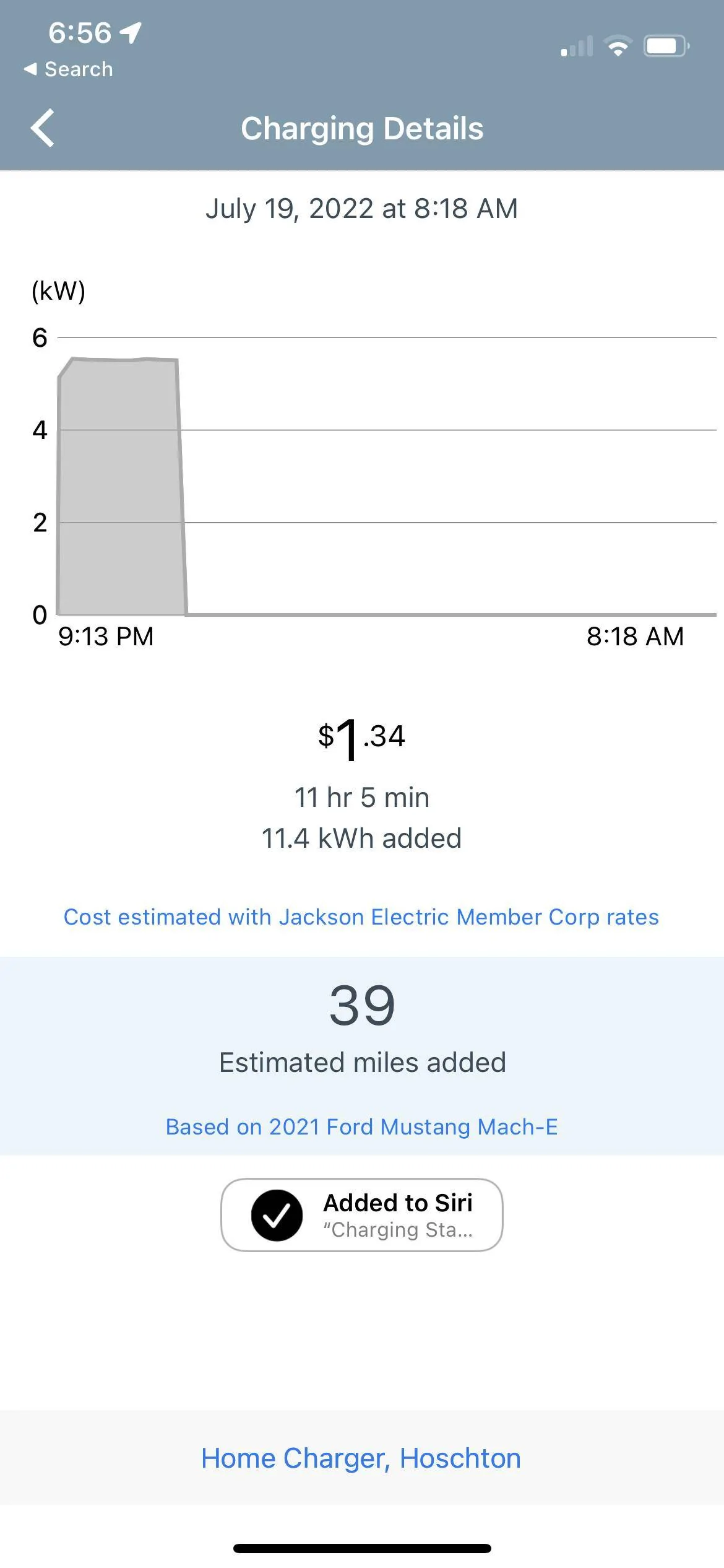

kdonnel
Oct 31, 2021
35
1,147
1,665
Metro Atlanta
2022 CA Route 1, 2020 Bolt EV
Here is what it will look like when set to 30A. Tops out at 5.56 or so kWh.
