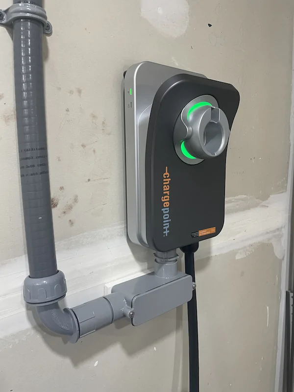

Realizing that a pretty significant part of the install is labor I only wanted to pay to have the job done once. I opted for the wiring that can handle 60 amps (which allows a 48 amp continuous load). I spent a little more ... but this should avoid me needing to have it upgraded in the future.

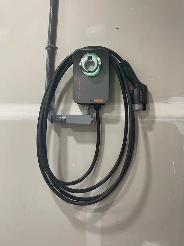

The folks before us had a hot tub, which made for easy access to a 50A circuit. Tucked on the back corner of the house underneath our deck works out well.
Well that’s very convenient.

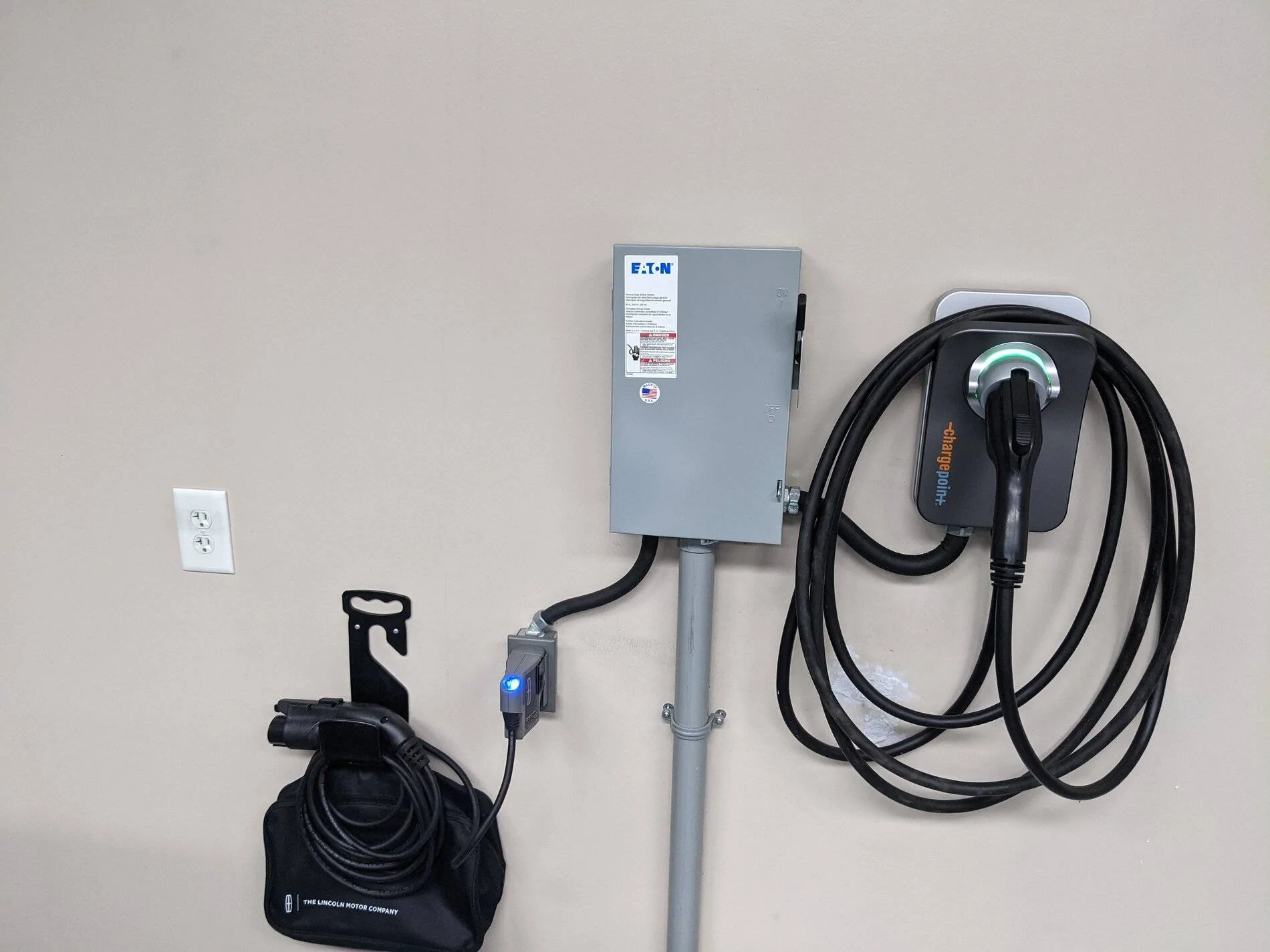

I opted for a 50 amp plug for my CPHF. I’m reaching the limit of what my 100 amp sub panel can likely carry. I want to avoid tripping and want ease of disconnecting if I move or need to replace the unit. My MME will be a second vehicle so I anticipate needing extra juice in a hurry rarely if ever.
