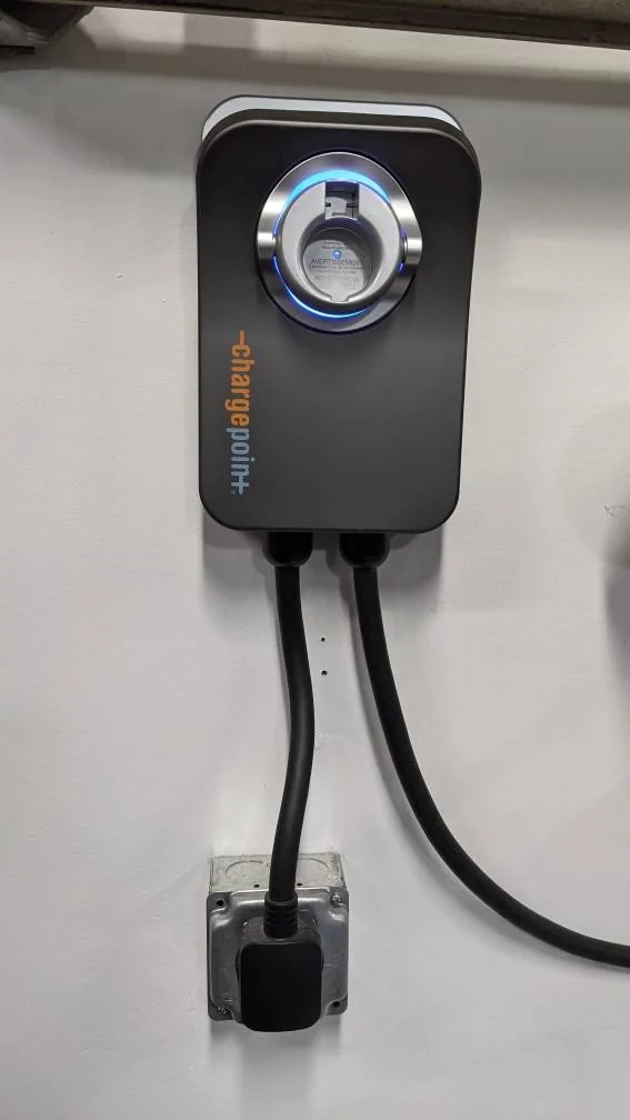

My ChargePoint Home Flex Installed

Looks good, nice and clean! I do like hardwired installs, I think they make more sense for a long-term installation. In my case I hardwired my charger, but also installed a 2nd circuit with a NEMA 14-50R so I have a backup (or in the future, can charge two EVs).
For everyone wondering on the ampacity, yes, #6 is OK for a 70A breaker and a 50A continuous load (it works whether you rate the wire at 75C or 90C, and in both cases assume the terminals are only 75C).
My only suggestion would be that it would have been better to connect the green wire instead of the white wire since that terminal is for an equipment grounding conductor, not a neutral. You don't actually need the white wire at all (though it isn't hurting anything by being there).
In this case it is somewhat academic because as you say they go to the same place, but it is technically incorrect and could be caught by a future inspector. It probably wouldn't have any kind of actual practical impact unless you got a whole-house GFP in the future.
Just a suggestion, I would terminate the green on the line side to be consistent with the load side color coding. Then I would pull the white completely out of the circuit conduit as it’s unnecessary for the Home Flex. Not a good practice to leave an orphaned wire in a high amp box. Sometimes it’s necessary with Romex to wire nut and tape off an unused wire, but not if using individual THHN in conduit.

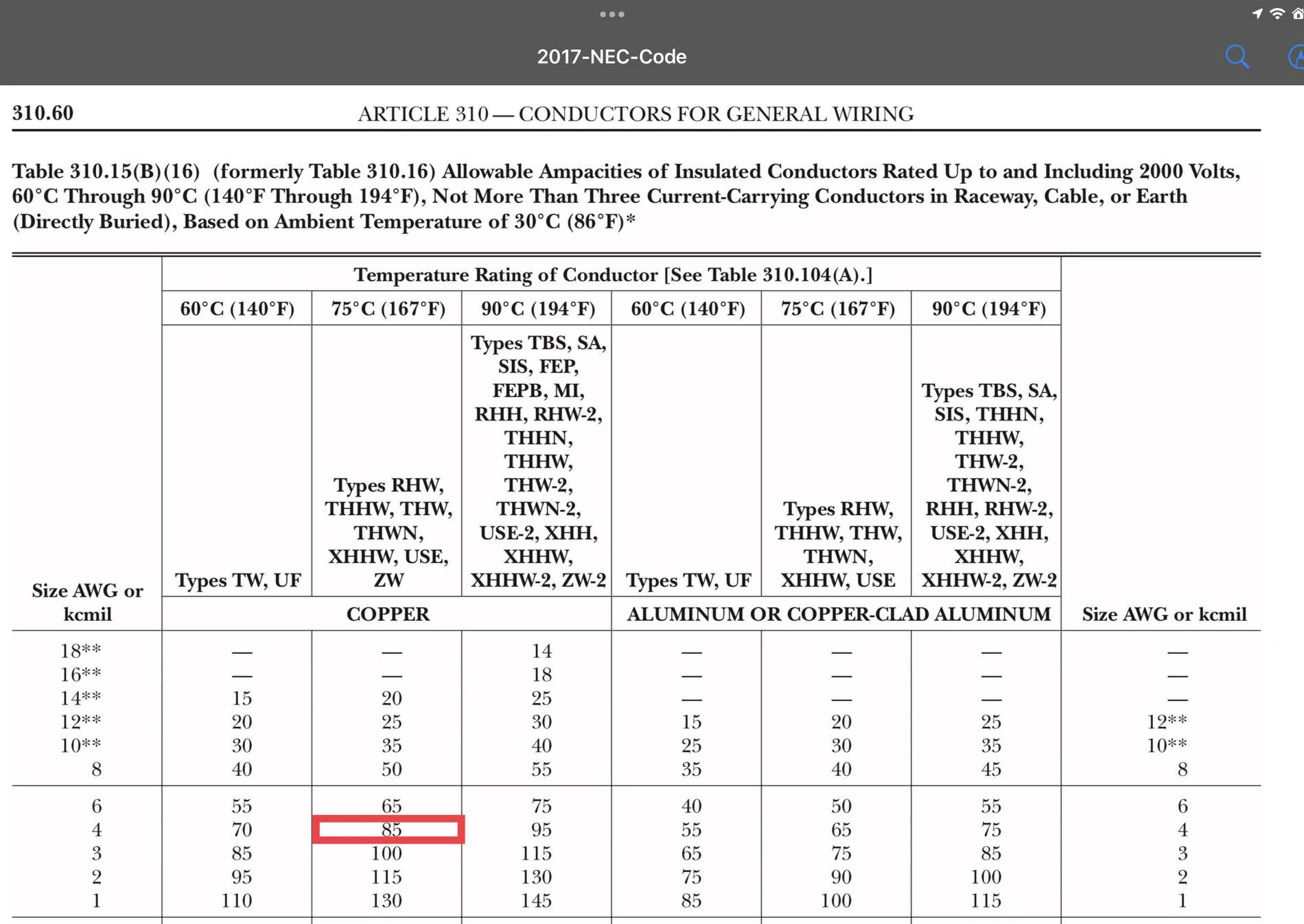

Should have used #4 THHN if using a 70A breaker. #6 THHN is sized for 60A. Need to use the 75C column(see NFPA 70 110.14(C)(1)(a)) of NFPA 70 Table 310.15 (B)(16), assuming this run is directly from panel to charger (it should be as nothing else is permitted to be on an EV circuit). Not sure why pull the extra wire. I would terminate the green (ground) wire, not the white. If you want to land the white, it should be marked with green tape. The Chargepoint requires 2 hot (black & red) + 1 ground. If your panel has both ground and white on the same bar, I hope your panel is wired up correctly. This is only permitted if the neutral and ground are bonded IN the panel.
Did a nice job training the Flex. I would have used EMT straight down from the ceiling, then flex right into the bottom of the charger box. Could have used 3/4” conduit the whole way but its OK to up a trade size.
This is all very valuable feedback. Thanks for the information. I pulled 4 wires in the event I chose an EVSE that required a neutral and ground landing point.
I did contemplate going #4 until my uncle (master electrician 30+ years), neighbor (commercial electrician 16 years), and a local reputable EVSE installer all identified #6 being acceptable and allowable for local building code.
My neutral bus and ground bar are bonded at the panel (new panel also installed early this year to support electric tankless and a few circuits for crypto mining). The white wire is indeed tagged at both ends indicating a grounded termination. Did that before commissioning the circuit.
Well, the Simpull cable is dual rated THHN and THWN-2, so it is rated for 90C. Of course, the terminals of the breaker are only rated for 75C so you have to evaluate the cable at 90C with conditions of use (temp and fill), and the termination at 75C without conditions of use.
But even using the 75C column, with ampacity at 65A you can round up to the next standard trade size breaker (allowable up to 800A breakers), meaning a 70A breaker can protect a 65A cable. A 60A breaker would have been fine as well, since both 60A and 70A are greater than 50 * 1.2.
I agree with you on the green wire - OP should just hook up the green/EGC on both sides. Leaving the neutral in place is probably OK since it does allow for some future expansion if an EVSE in the future wants the neutral.
Ah, you’re right. 240.4 (B) does allow for the next trade size in this case.
Ok @connoisseurr I stand corrected on my breaker recommendation. Still don’t like your flex run though ?

I look at all trades such as electrical, plumbing, framing and carpentry as unique skilled trades, because most professionals have their own preferred method of doing things, while meeting code requirements. You cannot get upset with another person's comments, especially in a forum, because it's a collaborative space where arguments and criticism are frequent.
No one here has told me that I'm doing anything wrong, just not their preferred way; example @MONDO who doesn't like my liquidtight fnmc :p
I do plan on keeping the extra conductor. It is capped at both ends. It provides the capability of futureproofing potential new chargers.
For F150 or Rivian that supports V2H, the current wire size will NOT be compatible with those types of chargers. I probably won't bother switching to a V2H bidirectional charger for this house - we have rather stable power here. I will be doing this for our new construction house that's getting build. a V2H charger will mesh very well with the selected SPAN breaker panel and solar array.

One other nitpicky item that you may have also addressed already. I can’t see if your LR conduit body is fixed to the wall (I see the offset spacer behind it), but it either needs to be or you need a strap within 12” of the appliance.
Forgot to address this - the conduit body is attached through a spacer I fabbed up from 1/2" thick azek trim board. 4 screws with gas-tight washers affix the box to the wall. I then a bit of Lexel over each screw to ensure a gas-tight seal.
I'm lucky to have 5/8" OSB behind the drywall in my garage. Makes mounting items very easy. I still chose to mount the CPHF to a stud for additional support.
