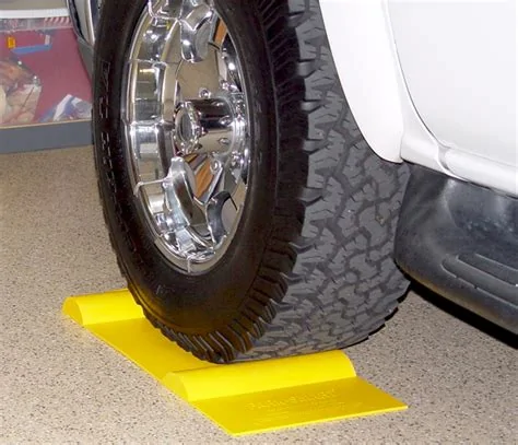

Just briefly shift to “P” to cancel the reverse camera.
I have the delay on because the reverse camera is the best way to tell how far the back of the car is inside the garage door when I’m pulling in forward.
These are pretty helpful for knowing if you're clear of the garage door. I also have a larger one that runs the entire width of the car.
I pull in different distances depending in what I need to load/unload (if anything from the hatch.
