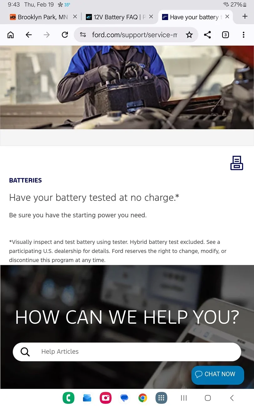

Do they charge a diagnostic fee to check the battery. If so, I'll pass until I get some alert or I'll check it with a battery tester.
268
18,190
28,591
Every dealership can do what they please. Mine did not. I asked ahead of time of course. This is a Ford offer, not a dealership offer:
